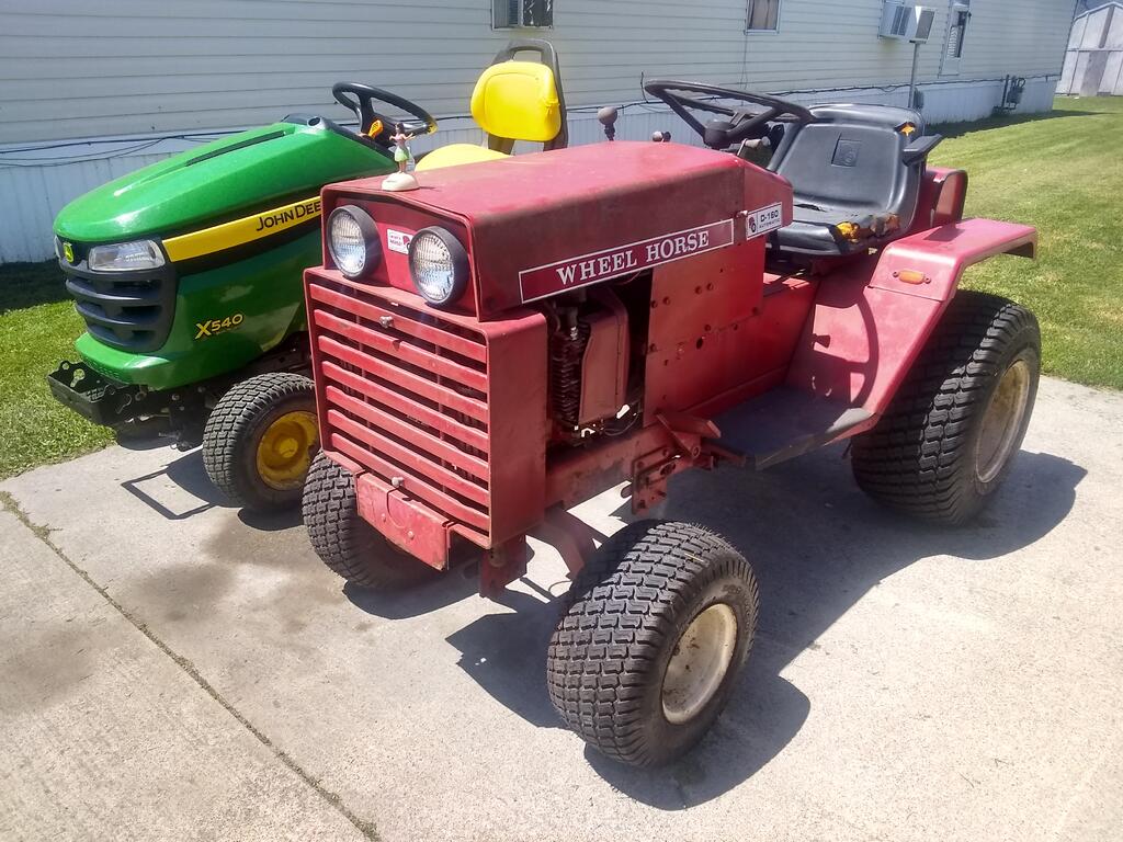

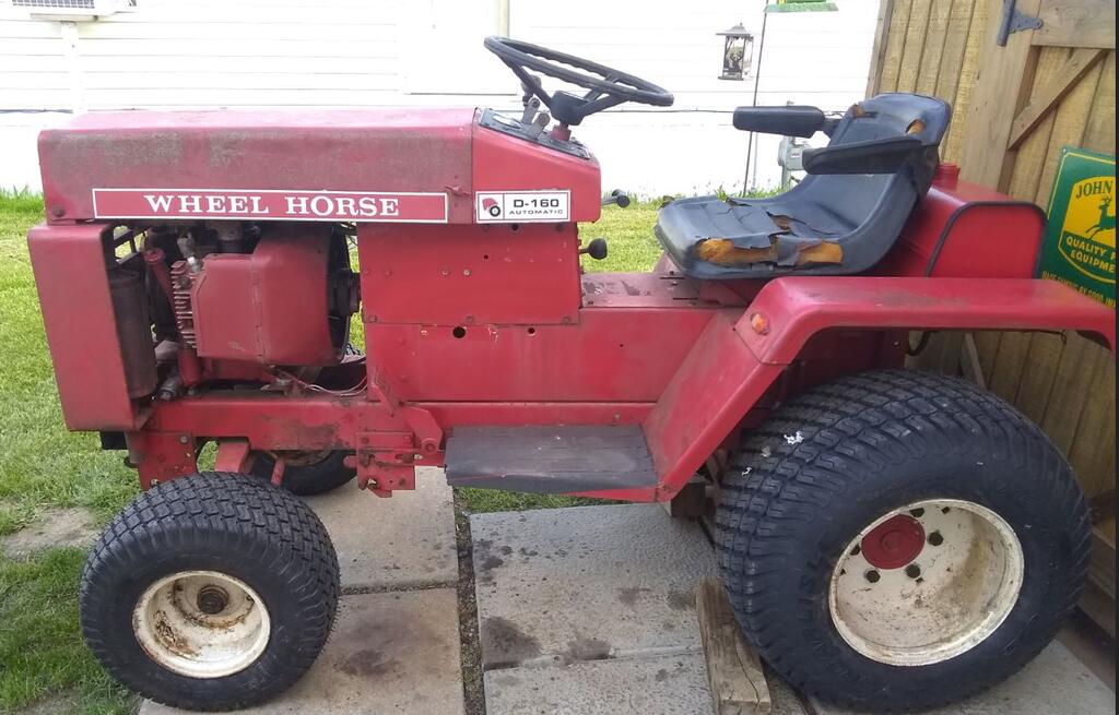

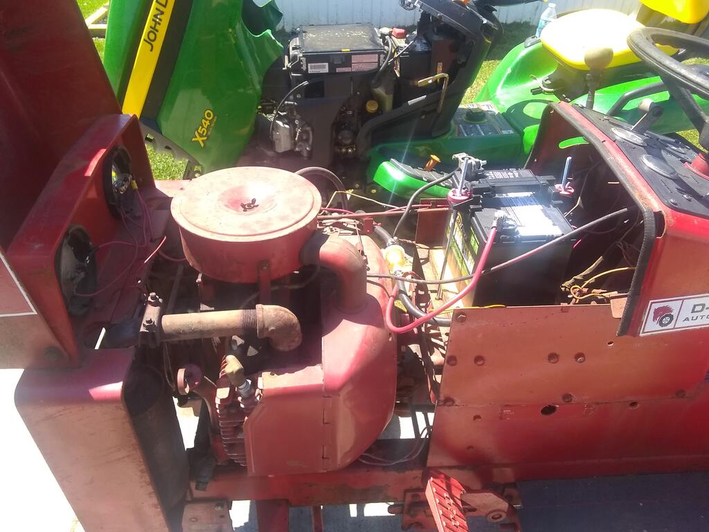

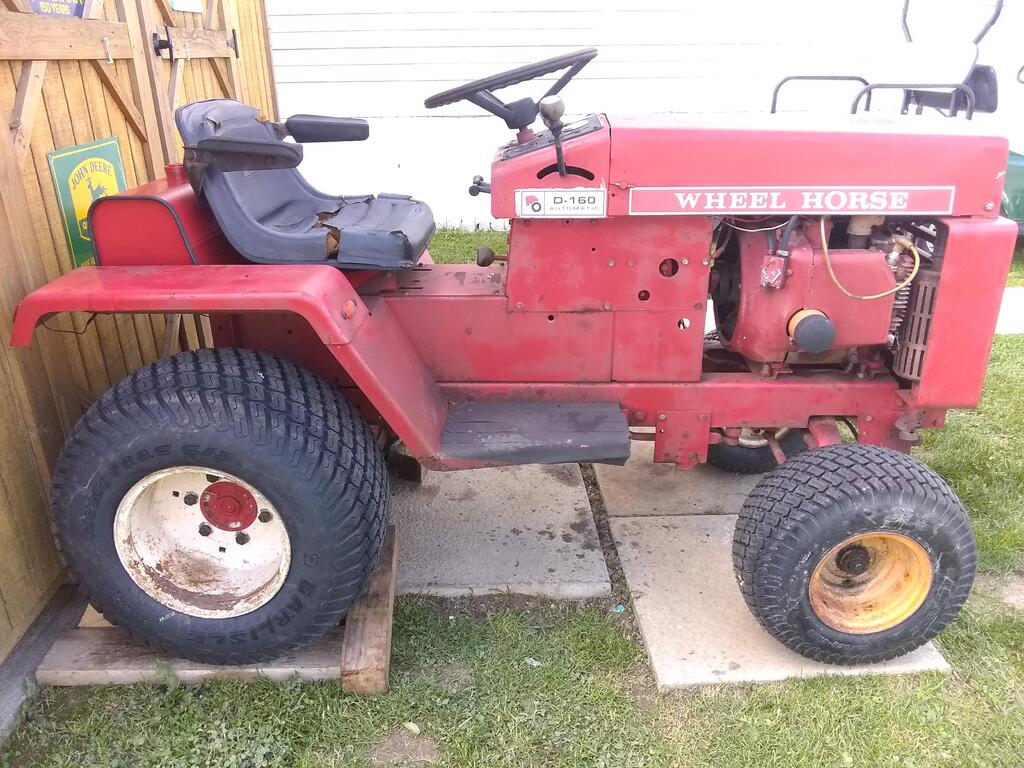

bottjernat1 2,197 #3 Posted August 7, 2020 Here is my free D160 i got before and after. Mine has a 16 hp twin hp onan! I love mine! Best gas money i ever spent. I put all new rubber on it. and tuned it up redid fuel lines,new headlight,tail lights,some wiring,knobs replaced. Now i am working on buying a snow blade and either a deck or rear pto 3point and rear mower. I am going to keep putting money into it. I am impressed with her so far! 4 1 Share this post Link to post Share on other sites

George Washington 68 #5 Posted August 7, 2020 27 minutes ago, bottjernat1 said: Here is my free D160 i got before and after. Mine has a 16 hp twin hp onan! I love mine! Best gas money i ever spent. I put all new rubber on it. and tuned it up redid fuel lines,new headlight,tail lights,some wiring,knobs replaced. Now i am working on buying a snow blade and either a deck or rear pto 3point and rear mower. I am going to keep putting money into it. I am impressed with her so far! 27 minutes ago, bottjernat1 said: good looking tractor - looks even better next to the ugly green one, lol 1 1 1 Share this post Link to post Share on other sites

bottjernat1 2,197 #8 Posted August 7, 2020 1 minute ago, George Washington said: ugly green one The ugly green one is a salty beast. It was my late dads he never used it. I do. It also is a great machine they make all sorts of stuff for it to. Its my Cadillac mower I tell everyone. LOL I like them all. My late dad was a huge deere guy. But he loved the horses to. and so do I. You should get that d-160. I love mine I am going to keep mine and add stuff to it. Very impressive machine in my opinion. Even my lady like the D. LOL 3 Share this post Link to post Share on other sites
