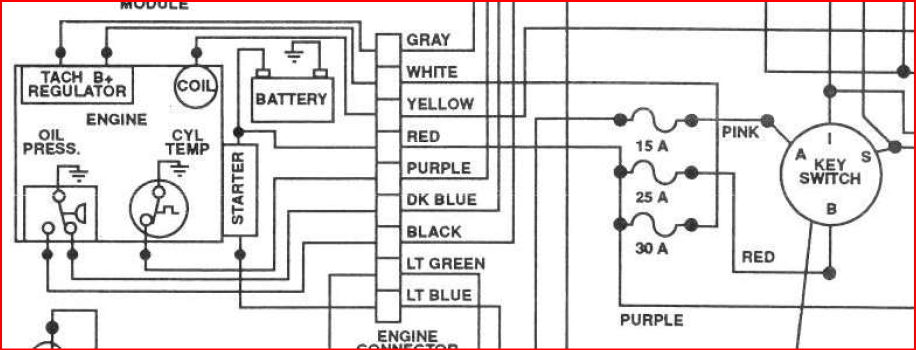

WHX?? 58,220 #4 Posted August 7, 2020 (edited) Charging would be from the regulator, I think it's a white wire through the nine pin to the 30 amp fuse. Also the red wire through the nine pin from the battery that goes to the 25 & 30 amp fuse should be 12 ga. Many times this is the sore spot on the engine connector so it's common to see these wires bypassed at the nine pin. also a sore spot at the 30 amp fuse on the fuse block. We've seen many a fuse blade melted off due to heat and corrosion here. The red wire feeding the ing. switch should be 12 also. This is from a 520 wiring diagram but should be similar. Let us know if you need a diagram for your tractor. Edited August 7, 2020 by WHX24 bad screen snip 1 Share this post Link to post Share on other sites
