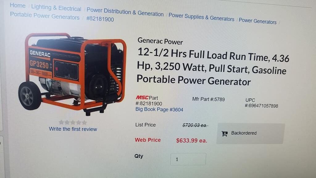

Docwheelhorse 2,778 #1 Posted August 7, 2020 Hello All and Happy Friday... hope any of you that "weathered" this storm are ok and that everyone is also doing well concerning this dang virus. Oil Change Thoughts.... I setup my sis in laws generator on Wednesday. Its a 3250 constant 3750 surge Generac and has 220. Whole house is plugged in and she runs what she can... she knows the limits. With that said it has a 208 cc OHV motor and holds about 22 ounces of oil... it sips fuel. Its been running non stop and by this afternoon will be on a 60 hr run. Only stopping to check oil every 12 hrs. It hasnt burned any oil---10/30 Walmart blue bottle semi synthetic. It still looks clean---do I "keep on truckin" till power comes back and do a full service then or.... change it this afternoon then again after storm duty when it goes back into storage. Did the math... 3600 rpm x 60 mins x 60 hrs equals the crank has gone roundy round 12,960,000 times... spark plug has gone sparky spark 6,480,000 then... Tony Share this post Link to post Share on other sites
