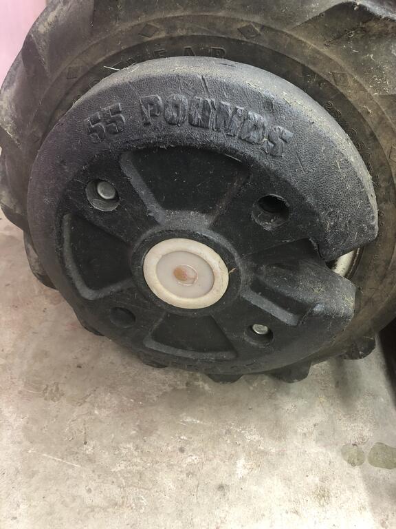

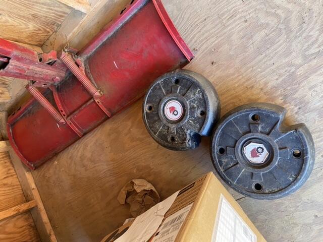

Reddart 207 #1 Posted August 6, 2020 Just picked up a pair of Wheel Horse wheel weights and a 48” plow. One of the weights is in excellent condition, the other is good, but has some cracks and work rash. Has anyone tried to repair the plastic on the weights? Also, what is the heavy material inside? I was thinking about using epoxy, but wanted to see if anyone has tried something else. 1 Share this post Link to post Share on other sites
AMC RULES 36,945 #2 Posted August 6, 2020 Bet that Flex-Seal paste version would probably the trick here. 4 Share this post Link to post Share on other sites
lynnmor 6,770 #3 Posted August 6, 2020 See if ABS plumbing cement will melt into the plastic, if it does, then the plastic is ABS and you can continue by forcing it in the cracks. Some scraps of ABS can then bridge the repairs if you want reinforcement. Share this post Link to post Share on other sites
peter lena 8,059 #4 Posted August 7, 2020 picked up a set of J/D yellow rear weights , mostly because of their flatter smoother rim fit , easily painted over to all black , i especially like the wheel/look as opposed to the hang out w/h type. patching , with flex seal also helps. pete 1 Share this post Link to post Share on other sites
WHX?? 46,736 #5 Posted August 7, 2020 15 hours ago, Reddart said: what is the heavy material inside? Appears to be some kind of concrete from mine that are cracked open. 2 Share this post Link to post Share on other sites
Lane Ranger 10,493 #6 Posted August 7, 2020 Spray the outside with truck bed liner when the cracks get filled. I used that on a set I had that were used heavily for years. Works great! 3 Share this post Link to post Share on other sites

The Tuul Crib 7,332 #11 Posted August 7, 2020 (edited) I have heard the problem with these wheel weights are do not let water get in them and freeze. Could expand and crack the plastic even more. I have a set like these with no badging. They are 55 pounds apiece. Edited August 7, 2020 by The Tuul Crib 1 Share this post Link to post Share on other sites
N875ED 98 #12 Posted August 8, 2020 I believe the weights are encased in polyethylene plastic (like milk bottles)...really hard to get anything to stick to it. You might try JBWeld for plastics Share this post Link to post Share on other sites
