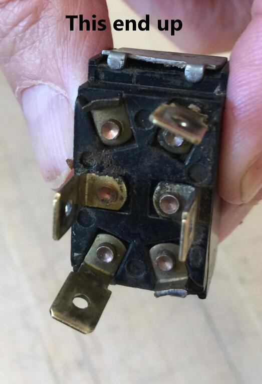

johnhon 7 #1 Posted August 6, 2020 This is probably simple for most of you, but I can't get my electric clutch to switch on. I'll admit I'm a novice when it comes to wiring. I have a 1973 1-0465 8. I have a diagram but it doesn't say what lugs the 4 wires go to. Here's a picture of the back of the switch. Thank you in advance! Share this post Link to post Share on other sites
gwest_ca-(File Mod) 12,322 #2 Posted August 6, 2020 I don't have any info on the 102783 switch but can guess. There are 2 different switches in the unit. Toggle one way one pair of terminals is connected. Toggle the other way the other pair are connected. One pair is for the starter circuit. The other pair is for the pto clutch. Have an ohmmeter to check it? Garry 1 Share this post Link to post Share on other sites
johnhon 7 #3 Posted August 6, 2020 I do have a meter and checked the continuity and separated the pairs. Does it matter which pair is the starter or pto clutch? In my photo should I have the yellow circle be the starter circuit and the red one the pto? The wiring diagram I have has: red - to pto red - to S on ignition switch orange - to light switch red - to starter Does it not matter which order the lugs are connected as long as the 2 separate circuits are kept separate? Thanks a lot! 1 Share this post Link to post Share on other sites
gwest_ca-(File Mod) 12,322 #4 Posted August 6, 2020 With the switch held in it's mounted position and switched to pto ON use that pair of connected terminals for the pto clutch. With the switch held in it's mounted position and switched to pto OFF use that pair of connected terminals for the starter circuit. It does not matter which wires of each pair go to which terminals of that pair. Garry Share this post Link to post Share on other sites

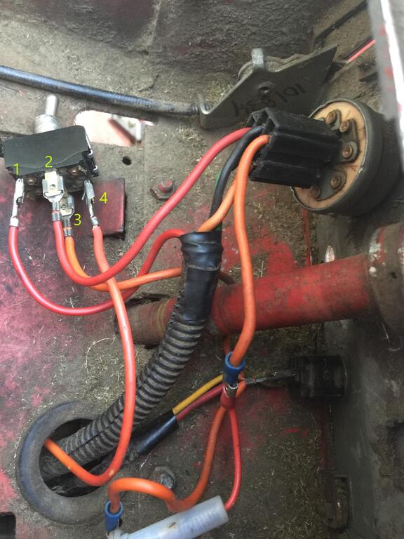

johnhon 7 #6 Posted August 6, 2020 Here's what I gathered from your comments. My clutch switch is in the off position. #1 - (R) to my solenoid #2 - (R) to S on ignition switch #3 - (O) to light switch and and fused to A on ignition switch #4 - (R) to my pto clutch The tractor starts fine but the pto still does not engage. After trying about a dozen different wiring configurations earlier today, there was one point where I could get the clutch switch to make contact with the clutch, but the tractor wouldn't start, so I guess the wiring to the clutch is fine. Do you have advice on where should I go from here? Thanks again! Share this post Link to post Share on other sites
johnhon 7 #7 Posted August 7, 2020 I also tried switching wires 1 & 2 with 3 & 4. The tractor wouldn't start until I switched the electric clutch switch to on. Turning the switch the other direction did not engage the clutch either. I apologize about being so dense about this. Thanks. Share this post Link to post Share on other sites
gwest_ca-(File Mod) 12,322 #8 Posted August 7, 2020 8 hours ago, johnhon said: I also tried switching wires 1 & 2 with 3 & 4. The tractor wouldn't start until I switched the electric clutch switch to on. - At this point the wires are on the wrong pair of pto switch terminals Turning the switch the other direction did not engage the clutch either - But you had the ignition switch in the RUN position. Had you turned to START position the pto clutch should have engaged. Sounds like you have the wiring correct. Make sure you have voltage at the #3 terminal with key in RUN position.. With pto switch ON you should also have voltage at #4 terminal. Now you should also have voltage at the +pto clutch terminal. If you do check for voltage on the -pto terminal. If you have voltage here the pto ground is bad. There is a chance the ignition switch is failing and you don't always get power to the Accssories terminal that powers the lights and pto. Garry Share this post Link to post Share on other sites

johnhon 7 #12 Posted August 7, 2020 Hmmm... my switch has only 3 positions. Is it possible I have the wrong switch? I don't remember ever having 4 positions and I've had the tractor for about 20 yrs. Maybe I should purchase a new generic switch at Tractor Supply? Share this post Link to post Share on other sites
953 nut 67,240 #13 Posted August 7, 2020 The three position switch should be fine, The four position switch was used for a few years (1968 to 1973 I think) but I have replaced one with a 3 position switch with good results. The lighting wire coming from the ignition switch "A" terminal should go to a fuse and then split int two wires, one to the light switch and one would be the orange wire to the PTO switch. 11 hours ago, johnhon said: The tractor starts fine but the pto still does not engage. If you run a small jumper wire from the battery "+" to the PTO does it work? Do the lights work with the key in the Run position? Could be the switches are fine but a fuse (or fuse holder) is causing the problem or the PTO isn't operable. Share this post Link to post Share on other sites

johnhon 7 #16 Posted August 7, 2020 It's fixed! It turns out the fuse holder had a broken contact in it. I replaced it with a new one and everything is good. Thank you all! This forum is great! I'm sure I'll be using it a lot in the future. Cheers, John 1 Share this post Link to post Share on other sites
