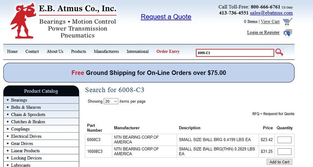

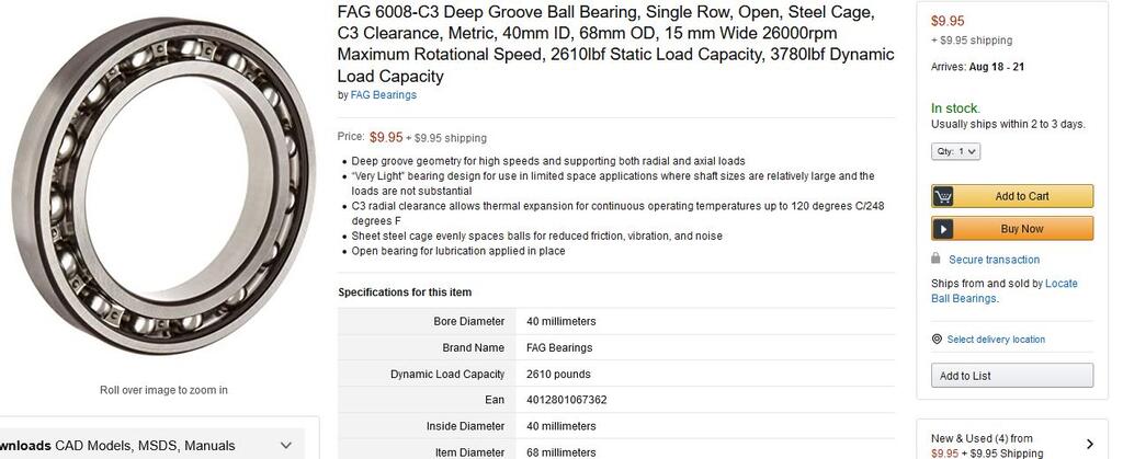

pfrederi 21,274 #5 Posted August 6, 2020 (edited) Inner bearing is 6008-C3 Edit That is # if eh inner bearing is a needle bearing. Edited August 6, 2020 by pfrederi Share this post Link to post Share on other sites

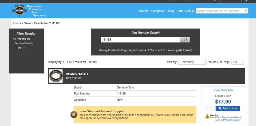

Jake Collie 3 #6 Posted August 6, 2020 Inner bearing is wheel horse # 111199 and is a 40mm ID ball bearing. Thank you for the other numbers. Share this post Link to post Share on other sites
pfrederi 21,274 #7 Posted August 6, 2020 1 hour ago, Jake Collie said: Inner bearing is wheel horse # 111199 and is a 40mm ID ball bearing. Thank you for the other numbers. Three options.. Share this post Link to post Share on other sites
