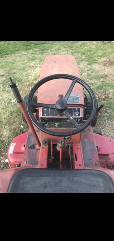

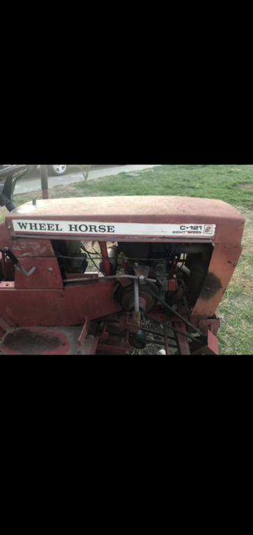

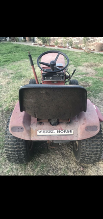

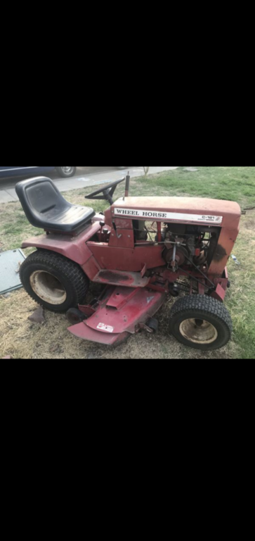

Vurge 158 #1 Posted August 6, 2020 Keep in mind I'm out in CA where Wheel Horses are uncommon. That means any repairs requiring heavy parts involve crazy shipping prices. I have a 606 that I'm currently working on, but now stumbled across a C-121 listed at $285. What do you all think? And what potential problems do you see? I'm new to Wheel Horse machines so please point out anything even if it seems obvious! ******Ad Text***** Selling pops old wheel horse C-121 model runs , and cuts ! With original Manuel ! No battery included. 2 Share this post Link to post Share on other sites
Stepney 2,356 #2 Posted August 6, 2020 Here in Maine the deck alone would bring that price.. I'd go for it. Share this post Link to post Share on other sites
oliver2-44 11,825 #3 Posted August 6, 2020 That's a great price. I've seen non-runners asking that price. A few observations. In the 4th picture, side view, the rear wheel looks dirty. Check if its dirt, or a leaking axle seal... negotiating point, but not a show stopper. In the photo that WH seat looks great. I would read that as a sign that its been keep inside and cared for. Share this post Link to post Share on other sites
8ntruck 9,386 #4 Posted August 6, 2020 It has a side discharge deck. The wheel is most likely dirty. Missing taillights, but I'd consider that to be minor. Seems like a good price. Share this post Link to post Share on other sites
