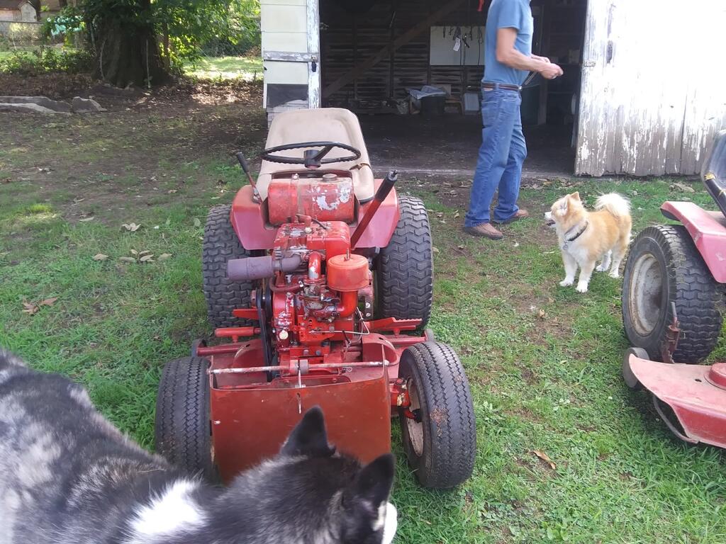

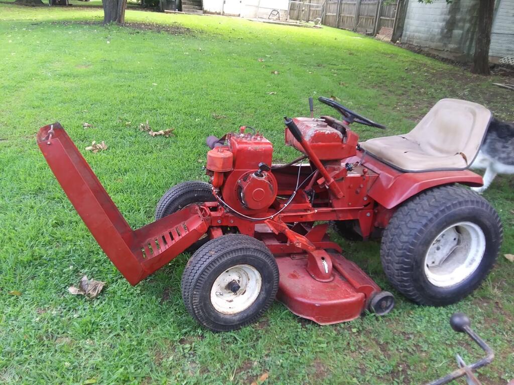

upstate yank 219 #1 Posted August 5, 2020 (edited) well guys here i am again;asking if any one might know the year or even the motor size of this older wheel horse with the briggs motor ;i am sure it has been changed from a kohler ;but heck for 75 bucks i couldn't go wrong as it runs great after a new set of cables and a new electronic ignition system ;here are the numbers if any one might know #1904-0206-4602-7309-2110 C-70388 thanks guys Edited August 5, 2020 by upstate yank Share this post Link to post Share on other sites
ebinmaine 81,046 #2 Posted August 5, 2020 Maybe a snowblower engine? Hydro transmission? So 65 or newer. Looks like the type of PTO from 65 to 67 or 8. That's set up similar to what we did with Trina's Pony. Hers is a Briggs 8 with a 3 speed. Share this post Link to post Share on other sites
gwest_ca-(File Mod) 12,519 #3 Posted August 5, 2020 Here is a parts list for the engine. https://www.partstree.com/models/190402-0646-xx-briggs-stratton-horizontal-engine/ If I remember correctly it was made September 21, 1973. Those model numbers start with the approximate cubic inch displacement and 19 is oftem advertised as 8hp. Engine operator manual Engine service manual Garry 1 Share this post Link to post Share on other sites
upstate yank 219 #4 Posted August 5, 2020 21 minutes ago, ebinmaine said: Maybe a snowblower engine? Hydro transmission? So 65 or newer. Looks like the type of PTO from 65 to 67 or 8. That's set up similar to what we did with Trina's Pony. Hers is a Briggs 8 with a 3 speed. thanks and yes that could be a snowblower motor who really knows what some will do no matter i am happy with it as it runs so nice and cuts the lawn ;and yep it is a hydro which i like more than the standard types Share this post Link to post Share on other sites
upstate yank 219 #5 Posted August 5, 2020 1 hour ago, gwest_ca said: Here is a parts list for the engine. https://www.partstree.com/models/190402-0646-xx-briggs-stratton-horizontal-engine/ If I remember correctly it was made September 21, 1973. Those model numbers start with the approximate cubic inch displacement and 19 is often advertised as 8hp. Engine operator manual Engine service manual Garry thanks so much as i thought it might be a 8 horse but i was confused with the year of the tractor but i am happy with it as it starts after the 2nd pull and mows very nice Share this post Link to post Share on other sites
Stepney 2,356 #6 Posted August 5, 2020 (edited) Looks like a 3 spoked steering wheel which generally tells me 1967-9. However it has stirrups instead of footplates and looks like a short frame?? Maybe an 875 with the wrong wheel? Cant really tell the frame from a pic like that but the deck looks pretty tight there. Is there a tag up under the dash? EDIT it must be 1967 or later due to the hand brake being up near the fender. Older ones were down low. So maybe a 1967 hydro of some sort? 1077? Was there an 877 short frame that year?? I'm getting a bit forgetful. Nothing really stops parts bodging but every long frame I've seen with an old style deck has an oversize driven pulley and uses the newer type PTO clutch. That had a foot pedal. Which goes along with the short frame/econohorse thought? Edited August 5, 2020 by Stepney 1 Share this post Link to post Share on other sites
953 nut 70,057 #7 Posted August 5, 2020 10 minutes ago, Stepney said: Was there an 877 short frame that year? Yes there is an 877 and I would agree that the three spoke steering wheel and the hand brake bring me to that conclusion too. The Sundstrand should be # 3100077. 1 Share this post Link to post Share on other sites
