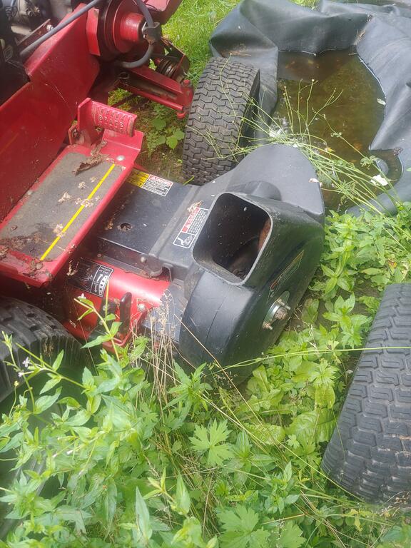

Pullstart 71,212 #6 Posted August 5, 2020 and sorry for your loss! I imagine with pictures, we might be able to survey the damage with you and figure out where to find parts... Share this post Link to post Share on other sites
Dan.gerous 2,696 #7 Posted August 5, 2020 6 minutes ago, pullstart said: and sorry for your loss! I imagine with pictures, we might be able to survey the damage with you and figure out where to find parts... Share this post Link to post Share on other sites

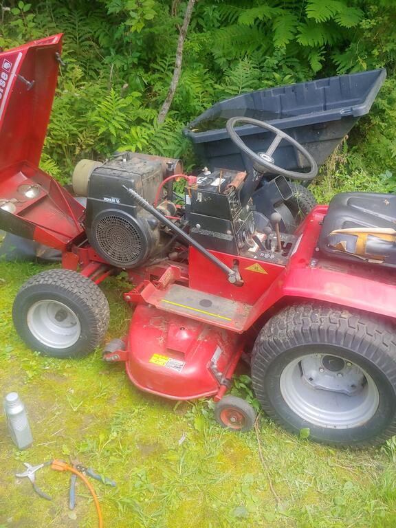

Bigben9664 14 #18 Posted August 5, 2020 This vacuume attachment took a good hit and it tweaked. If i get it running i know it is gonna make a lot of noise when i engage it! Share this post Link to post Share on other sites
