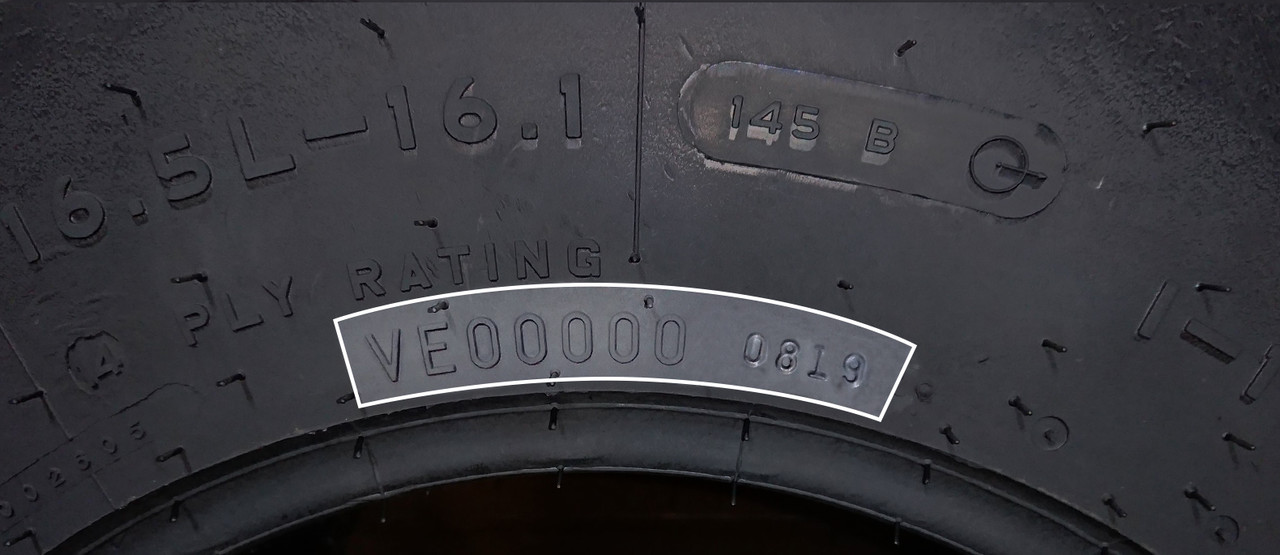

bc.gold 3,406 #2 Posted August 5, 2020 (edited) AG tires are date coded differently, they're not required to have a DOT number. 3. Date Code Date Codes tell you where your tire was made as well as what week of what year it was manufactured. - Code for manufacturing location - VE is the code for tires produced as Bridgestone/Firestone Des Moines, Iowa. - First two numbers - This is the week your tire was made - Last two numbers - This is the year your tire was made - "0819" 0 Indicates a tire manufactured on the 8th week of 2019 Edited August 5, 2020 by bcgold 3 Share this post Link to post Share on other sites
