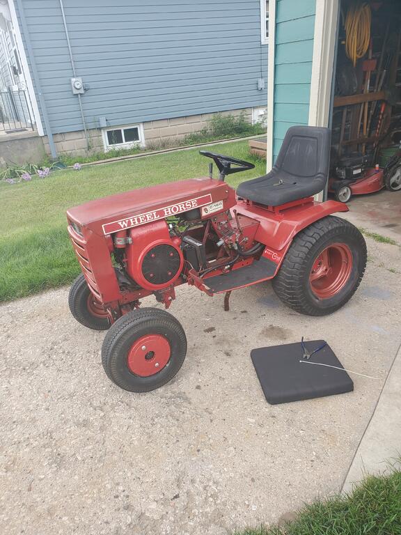

12Horse Paladin 1,038 #1 Posted August 4, 2020 (edited) I letout such a 'YeeeeHaaaw!', the neighbor i didnt notice outside, stuck his head 'round the corner of my garage, n asked 'whatsup?', when i fired it up again, today😅😁 Well, still more to do, so onto the next things. Y'all haveva good rest of the day!😊 20200804_122201.mp4 Edited August 4, 2020 by 12Horse Paladin Vid 5 6 1 Share this post Link to post Share on other sites
The Tuul Crib 7,339 #2 Posted August 4, 2020 48 minutes ago, 12Horse Paladin said: I letout such a 'YeeeeHaaaw!', the neighbor i didnt notice outside, stuck his head 'round the corner of my garage, n asked 'whatsup?', when i fired it up again, today😅😁 Well, still more to do, so onto the next things. Y'all haveva good rest of the day!😊 20200804_122201.mp4 Sounds good! Its a great feeling when they fire up for the first time ! 2 1 Share this post Link to post Share on other sites

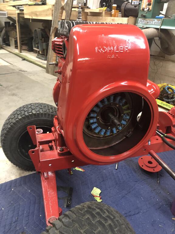

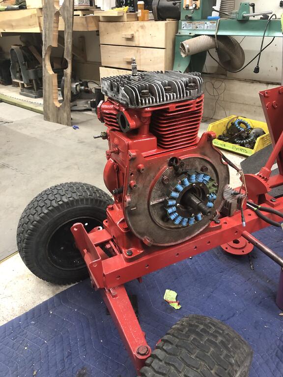

rjg854 12,376 #3 Posted August 4, 2020 Nothing like the thump of a 16hp Kohler, congrats 3 1 Share this post Link to post Share on other sites
The Tuul Crib 7,339 #4 Posted August 5, 2020 I cant wait to here this 30 over 16 hit that thump!! 3 2 1 Share this post Link to post Share on other sites
12Horse Paladin 1,038 #5 Posted August 5, 2020 3 hours ago, The Tuul Crib said: I cant wait to here this 30 over 16 hit that thump!! All i got is WOW. 👍🏼👍🏼 LIKEY!!!!😊 Share this post Link to post Share on other sites
