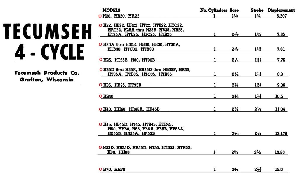

71_Bronco 1,072 #6 Posted August 4, 2020 Found the chart @oilwell1415 was referring to. The H was horizontal shaft, HH was horizontal shaft, heavy duty (cast iron block). No mention of HT though. Would it be safe to assume the HT55 would be aluminum, just made by Tecumseh versus Lauson? Share this post Link to post Share on other sites
gwest_ca-(File Mod) 12,146 #7 Posted August 5, 2020 Found this. Too hard to follow so added spaces between the models. Garry Share this post Link to post Share on other sites
