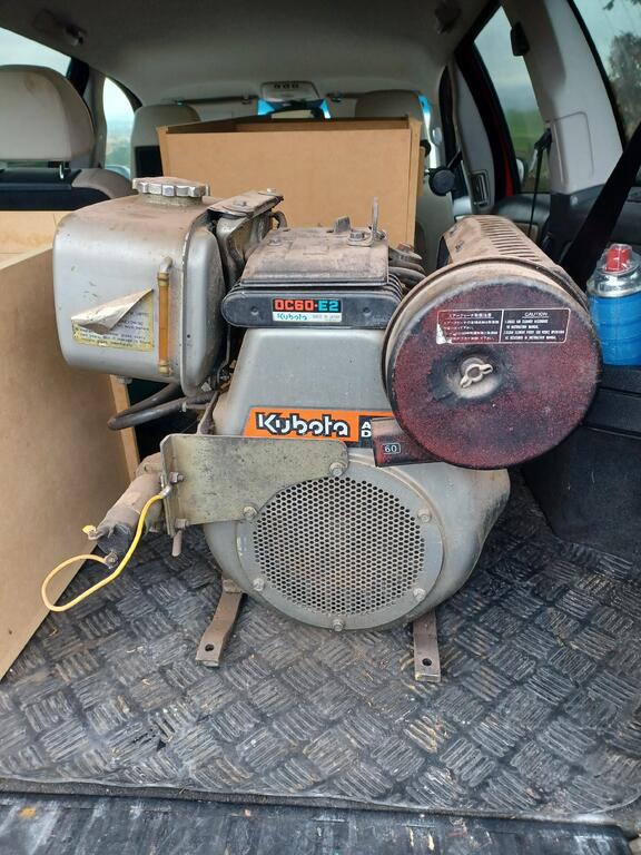

Dan.gerous 2,696 #202 Posted February 7, 2023 Couldn't resist buying this little beauty. Has electric start etc. 1 2 Share this post Link to post Share on other sites
ebinmaine 80,651 #203 Posted February 7, 2023 1 hour ago, Dan.gerous said: this Ain't that a cute little engine. What's the specs? Share this post Link to post Share on other sites
Dan.gerous 2,696 #204 Posted February 7, 2023 3 hours ago, ebinmaine said: Ain't that a cute little engine. What's the specs? Kubota OC60 - about 6hp compared to the Yanmar which is 7.5hp. Chatting to a guy that has a lot of little engines and he swears by them - better than the Yanmars but not quite as good as the Honda diesel he said. It's a little small, but I am just going to put it in anyway and see what it's like. Already sold the other two engines by accident! 1 Share this post Link to post Share on other sites

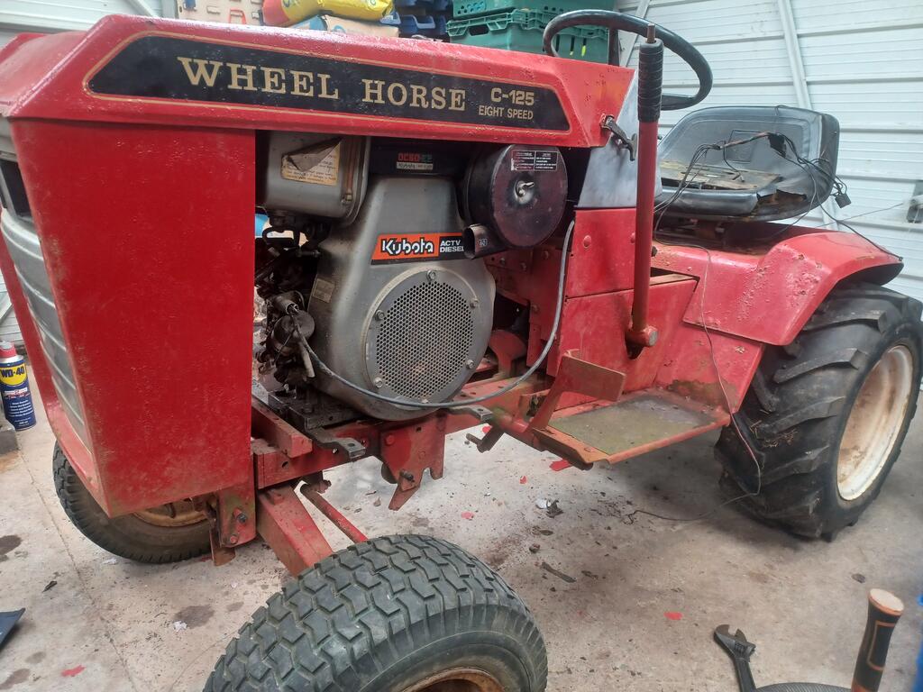

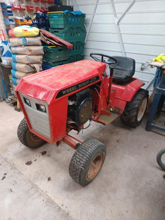

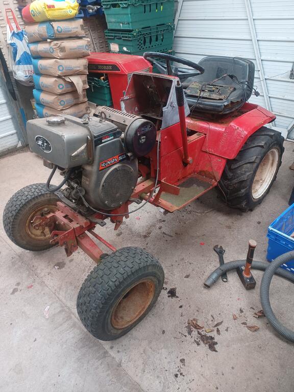

Dan.gerous 2,696 #206 Posted April 12, 2023 It's time. The C-125 is in for her new engine, I have procrastinated long enough. I also need it to mow the lawns as summer is nearly here! 1 Share this post Link to post Share on other sites

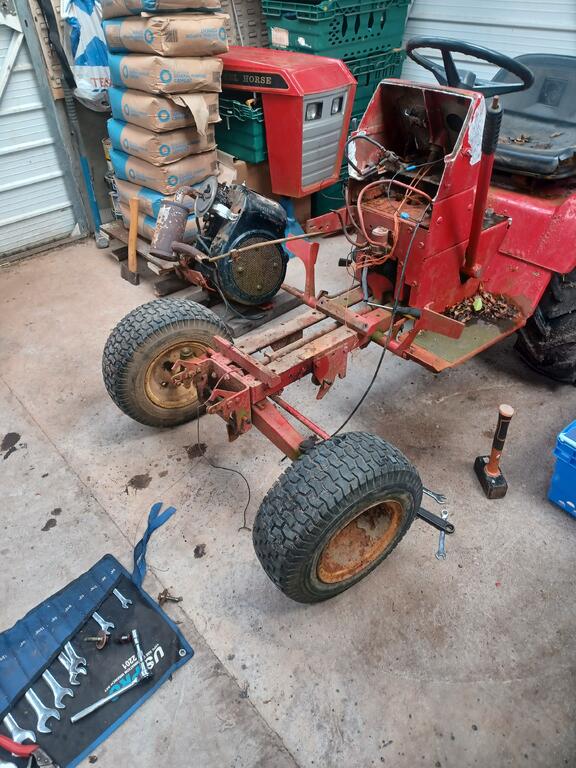

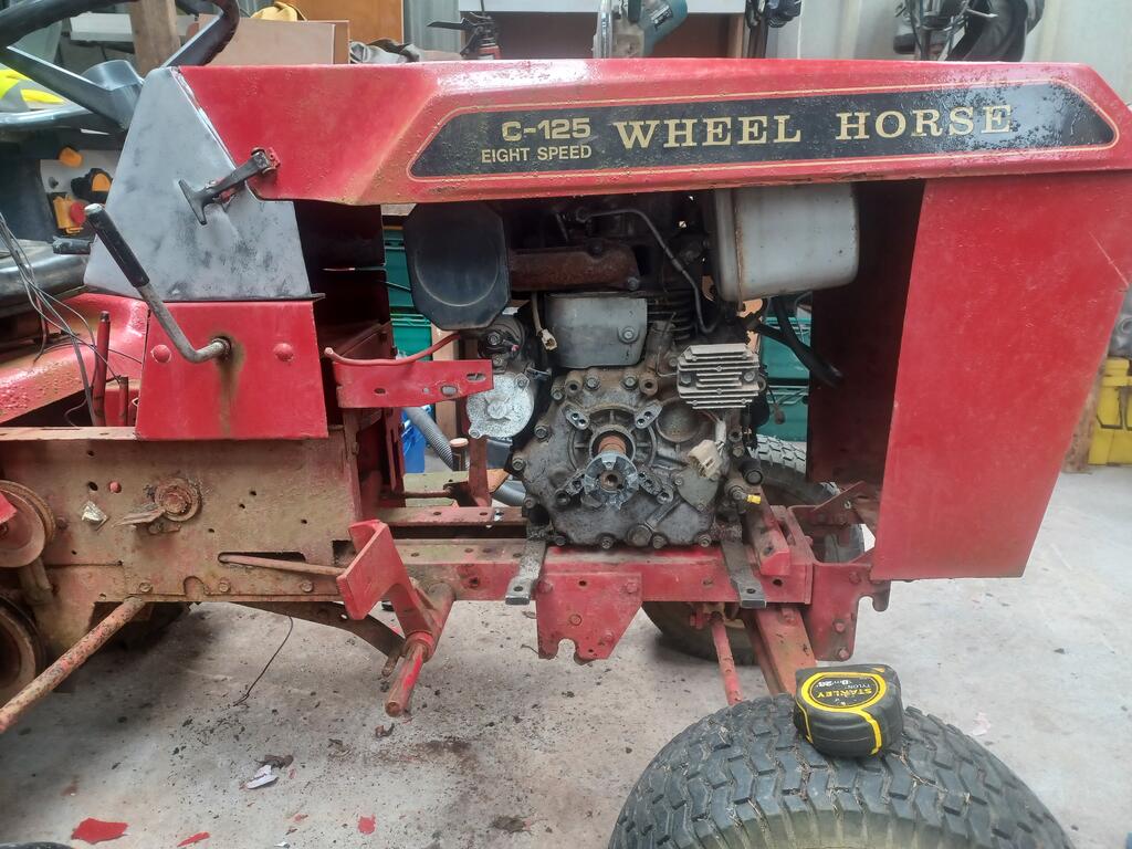

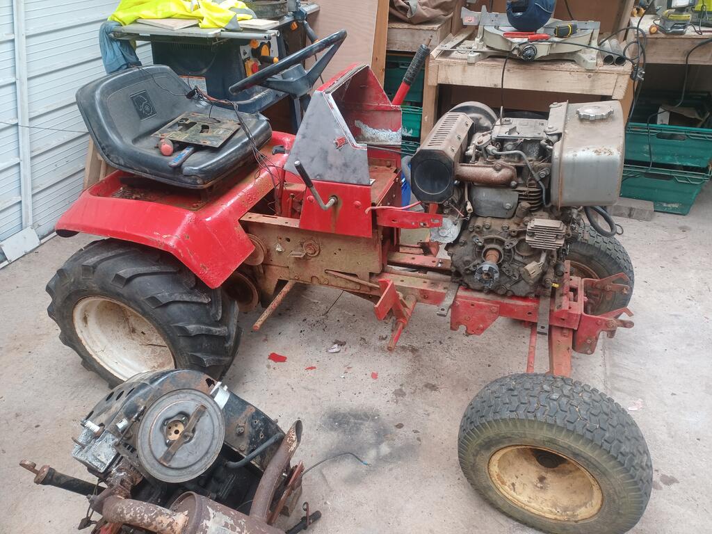

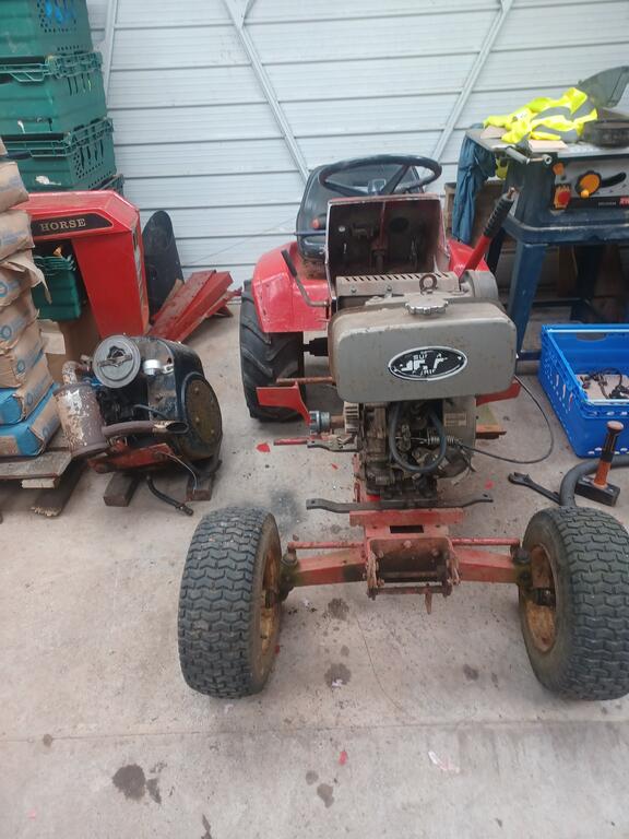

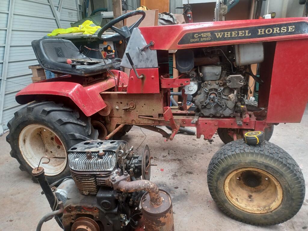

Dan.gerous 2,696 #207 Posted April 12, 2023 OK progress! Old unit out, new unit sitting in place - tons of room under the hood with this compact unit. Exhaust needs re-routing. No idea how on earth I am going to hook up the electrics. No idea how on earth I am going to hook up drive pulley and electronic clutch. Should be fun figuring it all out! Will give the horse a paint next winter, just getting a new heart will be a big enough project for the moment. 1 Share this post Link to post Share on other sites
ebinmaine 80,651 #208 Posted April 12, 2023 Looks like you have room for a jackshaft if needed for belt connection. 1 Share this post Link to post Share on other sites
Dan.gerous 2,696 #209 Posted April 12, 2023 19 minutes ago, ebinmaine said: Looks like you have room for a jackshaft if needed for belt connection. The drive shaft will be in exactly the same place as the kohler - it worked out perfectly. The engine will move forward a little yet as I haven't removed the last pesky shaker mount. 2 1 Share this post Link to post Share on other sites

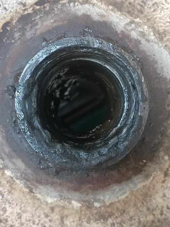

Dan.gerous 2,696 #210 Posted April 14, 2023 Thought I would replace the front wheel bearings while the horse is in surgery. Some animal welded one of the old bearings into the hub!! Luckily I have a few spare hubs laying about the place. 2 Share this post Link to post Share on other sites
ebinmaine 80,651 #211 Posted April 14, 2023 4 hours ago, Dan.gerous said: Some animal welded one of the old bearings into the hub!! Interesting "repair"..... 1 Share this post Link to post Share on other sites
Dan.gerous 2,696 #212 Posted April 14, 2023 59 minutes ago, ebinmaine said: Interesting "repair"..... Clever enough to use a welder, but not clever enough to figure out how a bearing works. 1 Share this post Link to post Share on other sites
