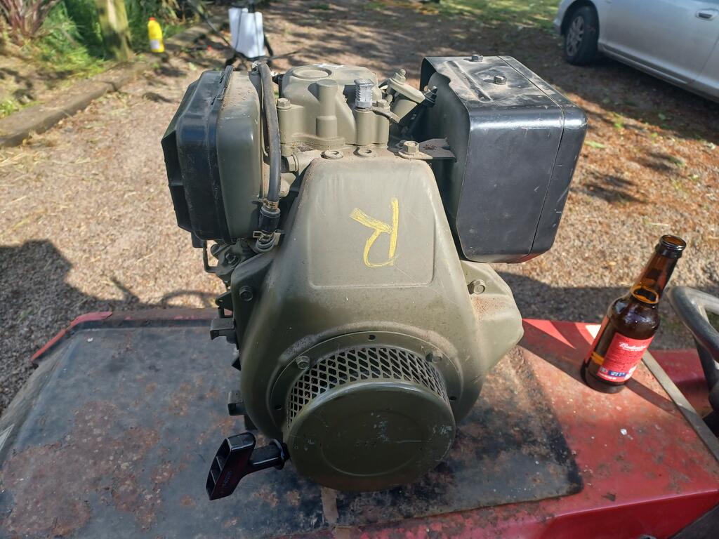

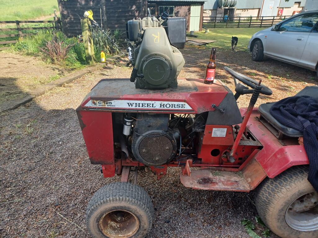

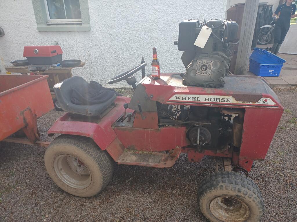

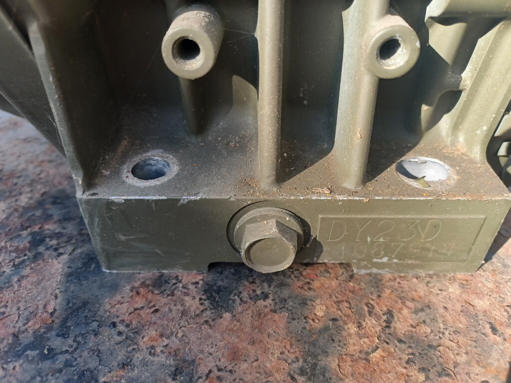

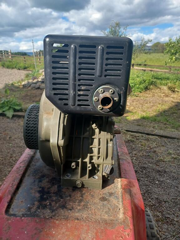

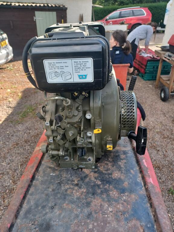

Dan.gerous 2,696 #133 Posted May 28, 2022 Some pics. Found an id number as well. Lovely night so painting sheds with bbq in background - this place will be immaculate by the time we leave. I hope new tenants look after the place. Share this post Link to post Share on other sites
Dan.gerous 2,696 #134 Posted May 28, 2022 Ha, would you believe they are Robin engines! 4.8hp - baby brothers of the ones wheelhorse used on the diesels. 1 Share this post Link to post Share on other sites
Dan.gerous 2,696 #135 Posted May 29, 2022 I wonder if 4 8hp would be too gutless, half tempted to just install one. Selling this stuff is a nightmare with scammers and people that get in contact then disappear. I guess it would be about the same as a 7/8hp petrol with the torque available. Share this post Link to post Share on other sites

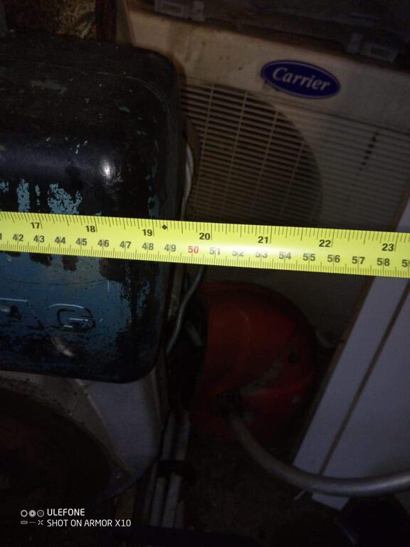

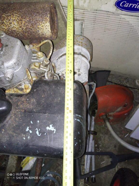

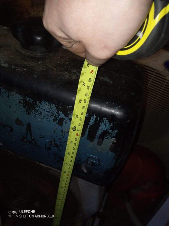

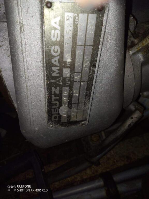

Dan.gerous 2,696 #142 Posted May 29, 2022 (edited) Here is the Deutz F1L 210 D - it's 13hp. The cooling fan is belt driven rather than off the crank. I think it also has a half speed pto for hydraulics. Tapered shaft and unknown service history, but I might just take the gamble - will study the manual in the morning and decide then. Dimensions are a bit big, but I think he has included the generator frame it sits on. Have found an online manual for correct dimensions, but it won't open on phone. This is also in Orkney, so could drop one engine off and pick another one up when the ship gets in on Thursday night. Edited May 30, 2022 by Dan.gerous 3 Share this post Link to post Share on other sites

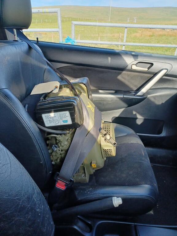

Dan.gerous 2,696 #144 Posted June 2, 2022 One of the little Robin engines on its way to a new owner in Orkney. Best way to stop it moving about was by using a seat belt 2 1 Share this post Link to post Share on other sites
Maxwell-8 4,371 #145 Posted June 2, 2022 2 hours ago, Dan.gerous said: One of the little Robin engines on its way to a new owner in Orkney. Best way to stop it moving about was by using a seat belt That wasn't a option when I picked up my lombardini, that thing was nice and greasy, weighing around 180lbs. That would have left a nice mark on those leather seats haha. I have a 14hp, the engine is tall, I need a 4" hood lift to have enough room for the diesel monster 1 2 Share this post Link to post Share on other sites
Dan.gerous 2,696 #146 Posted June 2, 2022 2 hours ago, Maxwell-8 said: That wasn't a option when I picked up my lombardini, that thing was nice and greasy, weighing around 180lbs. That would have left a nice mark on those leather seats haha. I have a 14hp, the engine is tall, I need a 4" hood lift to have enough room for the diesel monster That is a beast! I notice most of the diesels are tall engines compared to the petrol counterparts - just to make a suitable candidate harder to find! Using the height modification to add a winch is a great idea. 1 Share this post Link to post Share on other sites
