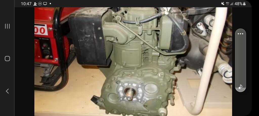

Dan.gerous 2,696 #78 Posted May 17, 2022 (edited) Came across 3 brand new military engines listed as "Yamaha single diesels". Looks to me like they are actually Yanmar and its a typo, which is great as people might overlook them at the auction. The reserve is £75 each which is worth a punt even though I am not sure of the HP and the auctioneers have limited information. Main question for you guys is.... Tapered shafts, its not a show stopper is it? Still getting the other engine on Saturday and that's a straight 1" shaft - these are just a bonus if I get any of them. Edited May 17, 2022 by Dan.gerous 2 Share this post Link to post Share on other sites

Handy Don 17,703 #80 Posted May 17, 2022 @Dan.gerous I'm sure you already realize that the tapered shaft is often to drive a generator so apologies if this is redundant! Typically, the generator would have only one end bearing on its armature and rely on the tapered shaft to align and support the other end. Also, out of the box a generator's diesel engine governor/throttle will typically be set to run at the one speed the generator needed -- 1800 RPM in the US (for 60hz) and 1500 RPM (for 50 hz) in the UK. As @JoeM noted, the sleeves are an easy adaptation! Good luck! 1 1 Share this post Link to post Share on other sites

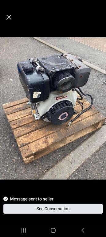

Dan.gerous 2,696 #96 Posted May 21, 2022 Woke up this morning ready to begin our long drive down to England for the Yanmar L100. Checked messages to see if guy had sent address yet, nothing, no communication at all. I don't understand people!!! Anyway, even though its still listed as "for sale" I'm not prepared to drive 10 hours on the off chance he gets in contact. This has been planned for weeks. Nevermind, will look again and the smaller L70 is still available only an hour away. Sigh 😕 1 Share this post Link to post Share on other sites
JoeM 10,318 #97 Posted May 21, 2022 7 minutes ago, Dan.gerous said: I don't understand people!!! Well when you figure it out let us know! I know I run into some that for some reason don't want to tell you their address. I just laugh because if I have a general location and name, thirty seconds later I am looking at the map where the live. I suppose some still think all is hidden? 1 1 Share this post Link to post Share on other sites
Dan.gerous 2,696 #98 Posted May 21, 2022 3 minutes ago, JoeM said: Well when you figure it out let us know! I know I run into some that for some reason don't want to tell you their address. I just laugh because if I have a general location and name, thirty seconds later I am looking at the map where the live. I suppose some still think all is hidden? It is perplexing! I just want a motor, not the contents of your house and bank account!! I might just go for the L70 and stick it in one of the C125 - 8's as a general use machine with the mower deck. That would give me a spare Kohler for the other two machines The C161 Auto can wait until a bigger unit turns up as that's the bigger FEL project. Will see how motivation goes today. Share this post Link to post Share on other sites

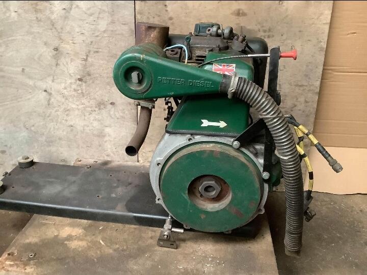

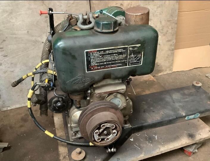

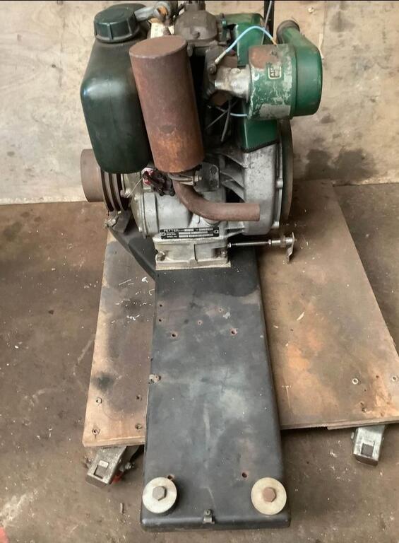

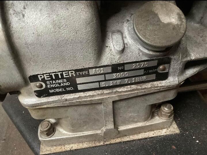

Dan.gerous 2,696 #99 Posted May 21, 2022 (edited) Any thoughts on lister or petter engines? I wonder if they are larger than a similar yanmar. Pickings are slim so casting the net wider to see what else is about. Have a petter ad1 on marketplace at moment.... Edited May 21, 2022 by Dan.gerous Share this post Link to post Share on other sites

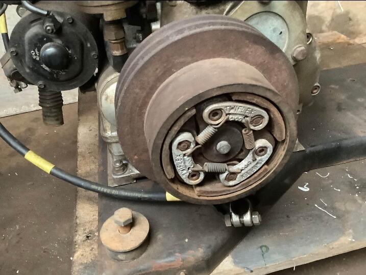

Dan.gerous 2,696 #100 Posted May 21, 2022 Looks like it has an electric clutch. 1 Share this post Link to post Share on other sites
