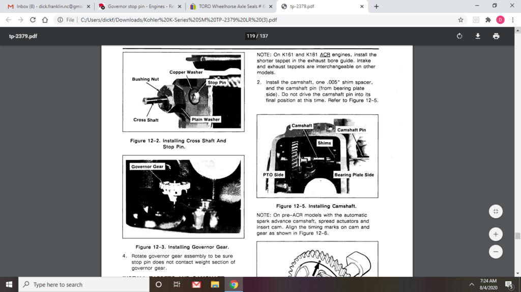

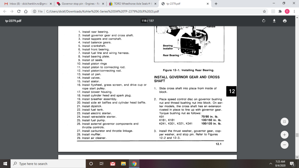

953 nut 64,136 #5 Posted August 4, 2020 Here are screen shots from the Kohler manual and a great photo from @prondzy's thread on engine rebuilding. 1 Share this post Link to post Share on other sites
