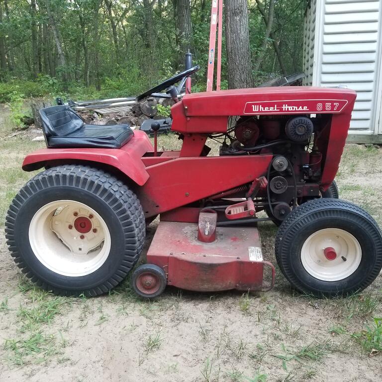

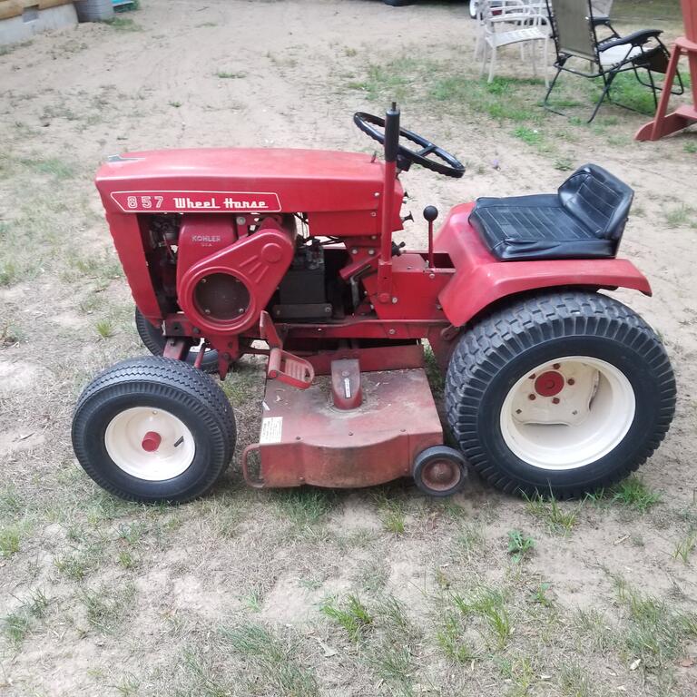

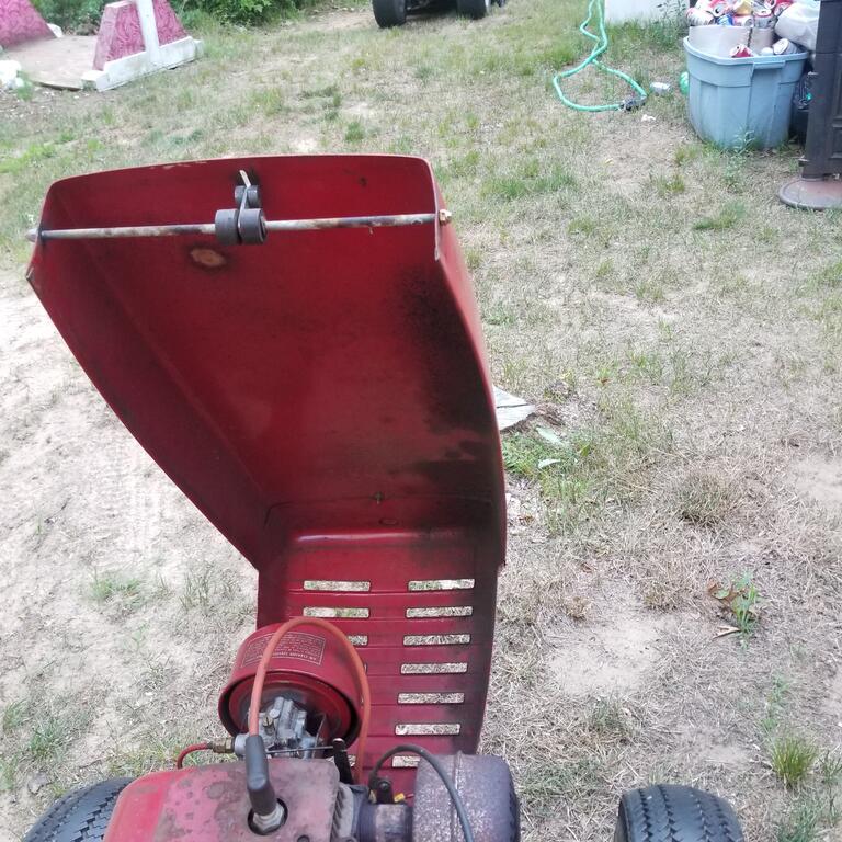

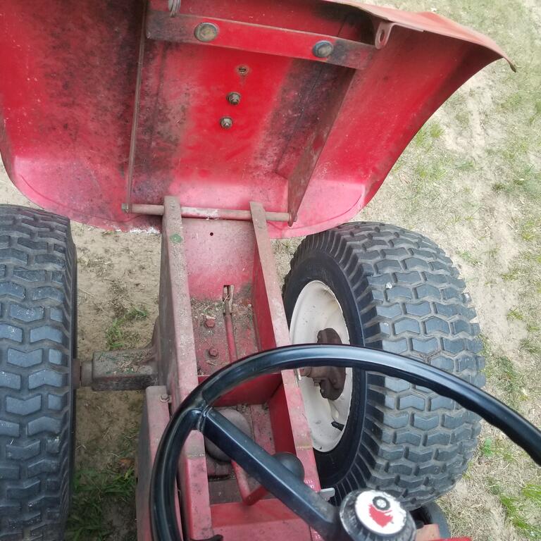

Edgee 12 #8 Posted August 3, 2020 13 hours ago, 953 nut said: Glad you found us, any questions that come up please feel free to ask them. One thing we ask of all new members, Here are some pictures 3 1 1 Share this post Link to post Share on other sites

WHX?? 58,230 #12 Posted August 3, 2020 Good advice Tuneup let us know if that helps Edgee. Sure is a nice looking all original! The 857 is a favorite model of everyone around here. 1 Share this post Link to post Share on other sites
