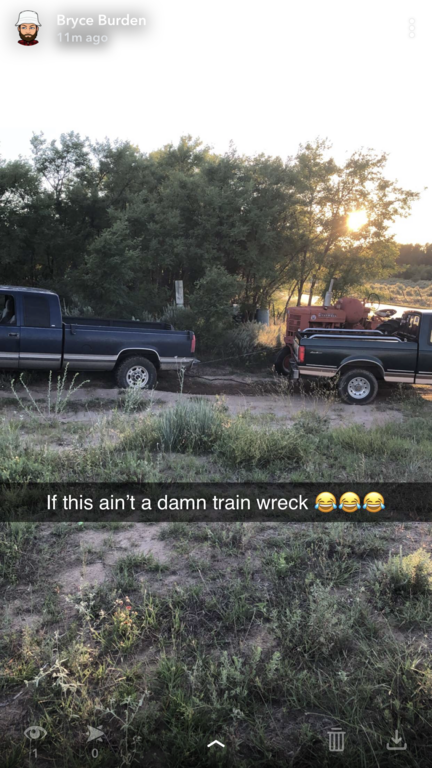

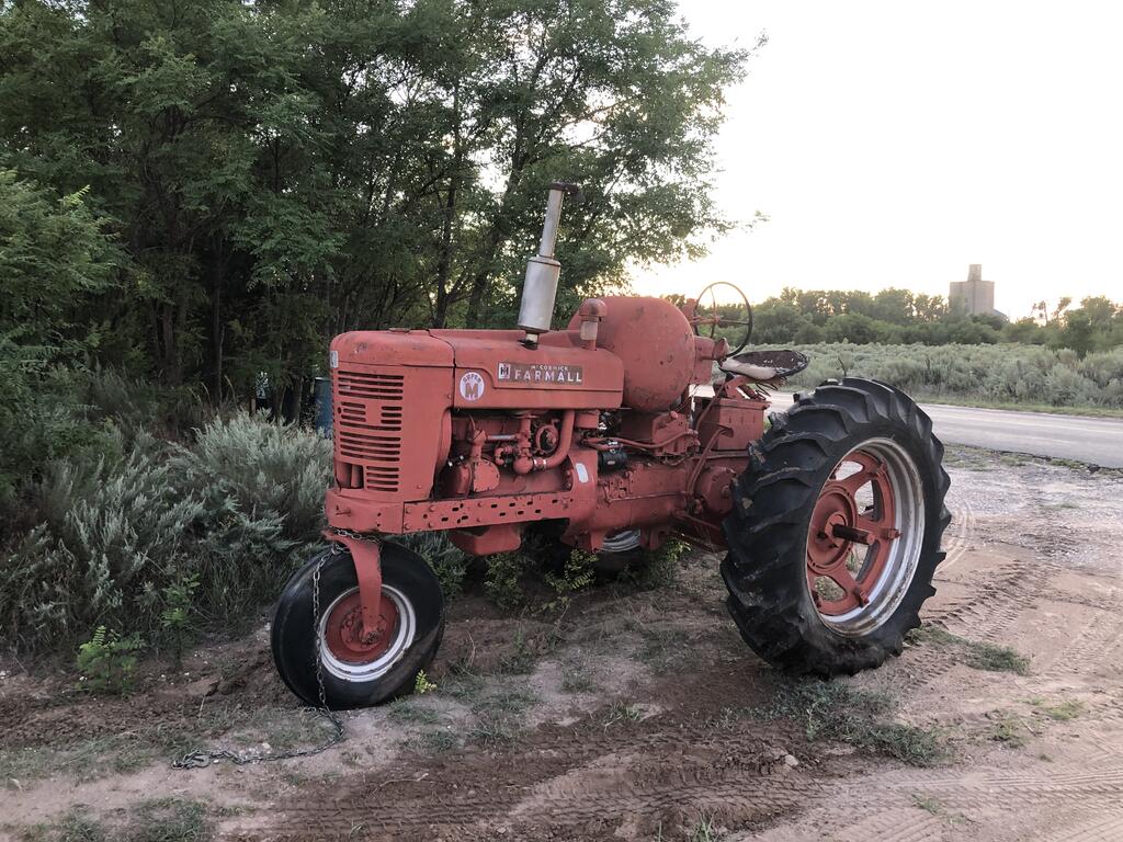

ClassicTractorProfessor 5,455 #1 Posted August 1, 2020 I was so broken hearted over selling my 48 M, that I upgraded...to a 1953 Super M on propane with a single front wheel. Got a good deal on it at a friend of mines estate sale, his daughters wanted his tractor to go to a good home...put a battery in it filed the points and she came to life after sitting several years. Now for the bad, the transmission won’t shift into any gear...hoping it’s not a major issue...have to get a friend of mine to bring his tractor over in the morning and drag it the rest of the way up in the yard. We got it as far as we could before we buried the truck in the sand 1 5 1 Share this post Link to post Share on other sites

ZXT 2,402 #4 Posted August 1, 2020 Nice buy! Single front wheel Farmalls are like finding hens teeth around here. Definitely cool. Looks like neither the Chevy nor the Ford could do it.. Looks like you need to find a Dodge 1 3 Share this post Link to post Share on other sites
ClassicTractorProfessor 5,455 #5 Posted August 1, 2020 20 minutes ago, ZXT said: Nice buy! Single front wheel Farmalls are like finding hens teeth around here. Definitely cool. Looks like neither the Chevy nor the Ford could do it.. Looks like you need to find a Dodge I would have made it with the Chevy no problem if I hadn’t forgotten about that washout on the far side of the driveway...dropped the right rear tire off in it and then it was over...had to walk to the house and get the little F150 to pull the Chevy back enough I could unhook my chain. 2 Share this post Link to post Share on other sites

bc.gold 3,406 #8 Posted August 3, 2020 (edited) If the clutch disk is rusted to the flywheel, remove the starter for access, put a brass, aluminum or copper block against the flywheel to protect it. Use a short throw pneumatic chisel with a blunt hammer against the soft metal block while the clutch pedal is depressed, turn the flywheel a quarter turn and repeat. I use a 20 lb tank filled with propane as my propellant to operate the pneumatic hammer, since your hammering against a non ferrous metal no fear of sparks. This simple procedure may save you from having to split the tractor. Edited August 3, 2020 by bcgold Share this post Link to post Share on other sites
