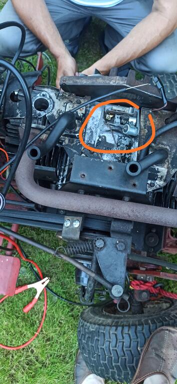

gwest_ca-(File Mod) 10,444 #22 Posted August 6, 2020 17 hours ago, mariuszaerox said: near the circuit breaker I noticed that sometimes it sparkles well? What are you calling the circuit breaker? Is it the kill relay? It must be bolted on to provide a ground. What you you doing to make it sparkle? Garry Share this post Link to post Share on other sites
mariuszaerox 12 #23 Posted August 6, 2020 hmm here it sparkles sometimes when the engine is running 1 Share this post Link to post Share on other sites
gwest_ca-(File Mod) 10,444 #24 Posted August 7, 2020 I did not think you could make the engine run. What is the problem with it now? It is normal for the circuit breaker to sparkle. Garry 1 Share this post Link to post Share on other sites
