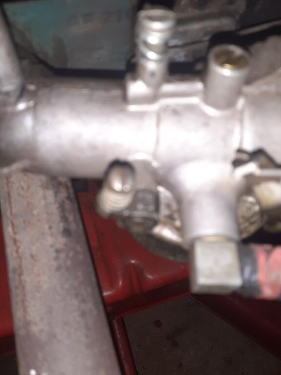

Renrag 69 #1 Posted July 31, 2020 Ok motor runs good ecept not as smooth as it should. I adjusted carb the best it'll run, after doing head gasket 4 times, but still has a slight sputter here and there. I cant adjust it totally out. And bottom saperation and somewhere around a few screws in getting oil leakage, should i worry about doing anything else to reseal that seperation, and gasket/ permatex or just tighten bolts down. I dont want to mess up motor, its strong and does run good for most part. Share this post Link to post Share on other sites

oliver2-44 11,632 #4 Posted July 31, 2020 1 hour ago, Renrag said: , but cant work that slight stumple when i throw the throttle quickly or at low idle Check for air leakage around the carb to block flange and around the carb throttle shaft. With the tractor idling spray some carb cleaner in those areas and see if the engine speeds up a little. If it does, thats where its leaking air. 1 Share this post Link to post Share on other sites

Renrag 69 #9 Posted August 24, 2020 Ok i found the air leak on the idle screw shaft, so now how do i seal it? Ive never messed with that shaft, is there a o ring? Share this post Link to post Share on other sites
oliver2-44 11,632 #10 Posted August 28, 2020 (edited) Today I’m more familiar with Kohler carbs than Briggs although I kept.a Briggs 16 hp for running for 25 years. While not a permanent fix you might try putting a coating of some heavy grease around that shaft. The grease might be enough to block air leakage at least to confirm that’s the problem. Then it may be time for a new carb. Others can chime in here with a better permanent repair solution Edited August 28, 2020 by oliver2-44 Share this post Link to post Share on other sites
