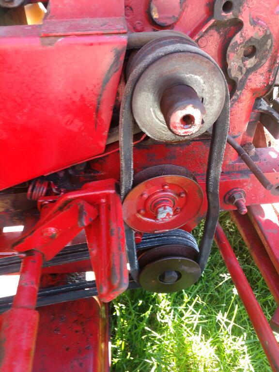

seven 202 #1 Posted July 30, 2020 This i just picked up last week . Spring is broken and I don't think it has the right belt length. Any belt / spring length ? Share this post Link to post Share on other sites
gwest_ca-(File Mod) 12,511 #2 Posted July 31, 2020 Belts are listed on this page. Click on the fuzzy picture Ironically the spring is in the parts list for the tractor - not the mower deck. Part number 5714. Here are some threads on searching for a replacement. Looks like McMaster Carr has a good replacement 9433K111 https://www.wheelhorseforum.com/search/?q=5714&quick=1 This will give you the spring specs https://www.mcmaster.com/catalog/126/1364/ Garry Share this post Link to post Share on other sites
