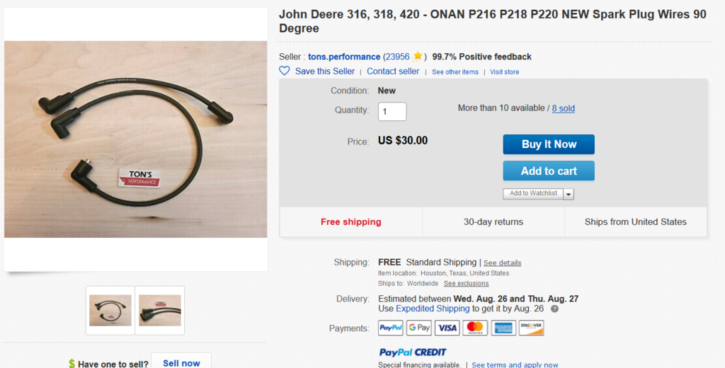

mort 24 #11 Posted August 19, 2020 I ordered an ignition module and tried to order some new spark plug wires but Onan has them discontinued....................167-1615-01 9" long and 167-1615-04 18.5" long. Where can I get new spark plug wires and do you have a part number for them? Thanks, Mort Share this post Link to post Share on other sites

Bill D 3,119 #16 Posted August 19, 2020 I make my own plug wires. Napa should have all the pieces you will need. Check your 9 pin connector. Make sure all connections are clean, tight and not burnt. Also check the fuse block for melted fuse holders. Replace the condenser when you replace the ignition module and make sure it is connected to the positive terminal on the coil. Also make sure the flywheel key hasn't sheared. If someone already replaced the module once they may not have torqued the flywheel properly. Bill Share this post Link to post Share on other sites
mort 24 #17 Posted August 19, 2020 Since I have never changed the ignition module on an Onan before I didn't realize I needed to take off the flywheel to get at it. What is involved on taking it off and what does it need to be torqued at? I stopped by Napa yesterday and they never suggested making my own spark plug wires. I saw online that people were selling spark plug wire kits and I thought if Napa couldn't help me with a replacement I would go that route. Where are the points located on an Onan 16 hp? I know where they are at on a Kohler. Are the points a 160-1183 and the capacitor 312-0256? I am not seeing the points in the parts manual. Can an ONAN Condenser 312-0246 be used since it is for a twin cylinder and 300VDC? Thanks, Gary Share this post Link to post Share on other sites
lynnmor 9,025 #18 Posted August 19, 2020 (edited) You need to remove the coil and the screws down there, and all of the screws holding the blower housing. There are two screws kind of hidden up from the bottom. A puller with 4 bolts is best to pull the flywheel. Loosen the center bolt 2 turns and then pull. It is all right there in the Onan manual. Flywheel bolt is torqued to 55lbs. You will need 7mm spark plug wire with 90 degree ends. Later model Onan engines had no points, I believe that WH never used the old ones with points. There is a condenser fastened to the air filter mount, I don't know if it is used just radio interference or if it does serve a purpose in the ignition, I've never replaced one. Edited August 19, 2020 by lynnmor Share this post Link to post Share on other sites
