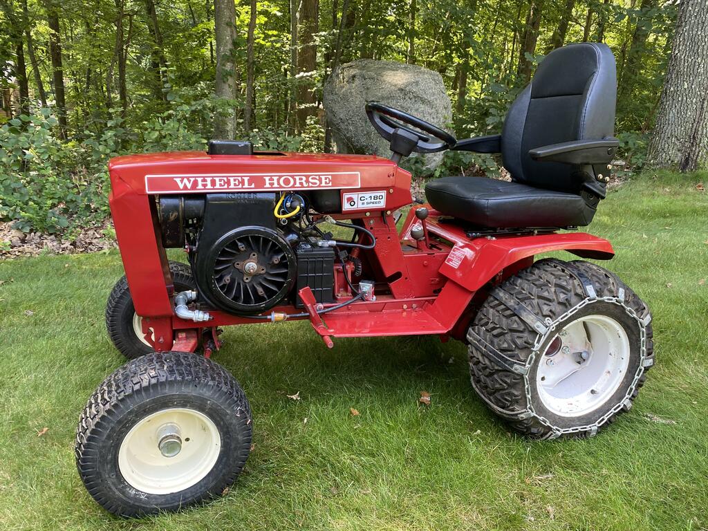

WheelHorseSteve 56 #1 Posted July 27, 2020 Introducing the latest Frankenstein / custom Wheel Horse -- my 1975 C-180. It's not complete but the idea is to dedicate this as a loader machine: it is my most stout mid-70s C-series. The K361 on it needs some attention; blown head gasket. Does anyone have familiarity with doing a head gasket on this OHV engine? I am going to do a breather in the valve cover and close off the factory breather to encourage the oil mist to get to the top. 5 2 2 Share this post Link to post Share on other sites

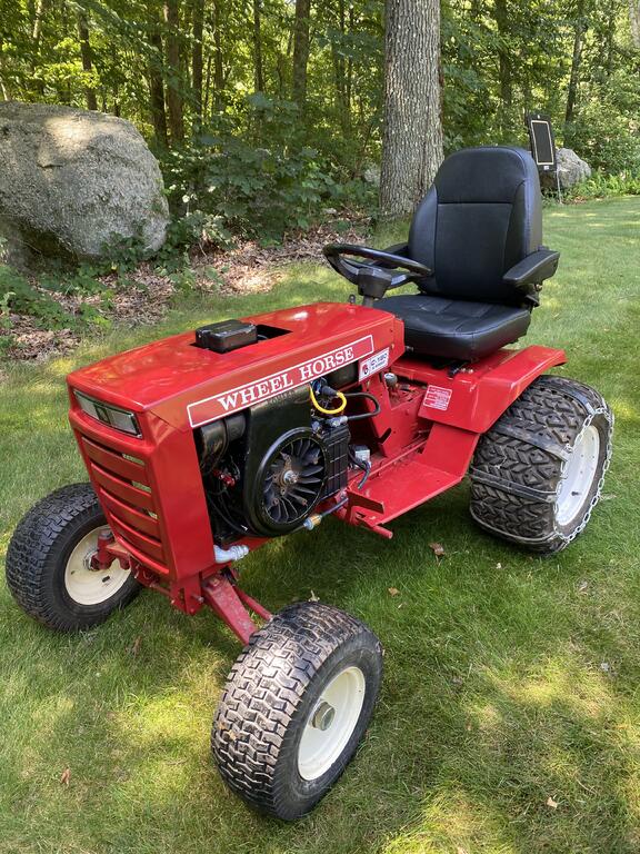

Pollack Pete 2,273 #2 Posted July 27, 2020 Nice.I like the valve cover poking through the hood.I've got a 1556 Bolens with that overhead valve engine.Your Wheel Horse looks much better than my Bolens. Share this post Link to post Share on other sites
WheelHorseSteve 56 #3 Posted July 27, 2020 8 minutes ago, Pollack Pete said: Nice.I like the valve cover poking through the hood.I've got a 1556 Bolens with that overhead valve engine.Your Wheel Horse looks much better than my Bolens. Thanks Pete! It's kind of like the bulge you see on some hoods... or a scoop. Fun to look over to remind you that you have the 18HP. Not fun if this ends up being as unreliable of an engine as I've read. A rare bird... especially in the world of Wheel Horse. 2 Share this post Link to post Share on other sites

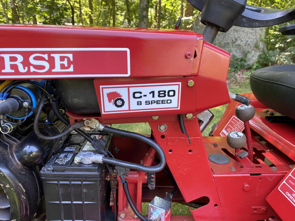

Redneckdavis 308 #8 Posted July 27, 2020 Can anyone tell me what years,models your decals are on? Those are perfect for my new project Share this post Link to post Share on other sites

WheelHorseSteve 56 #10 Posted July 27, 2020 4 minutes ago, pullstart said: Was there indeed a C-180, or is that part of the Frankenstein in the tractor? I have heard about the OHV Kohler, but haven’t ever seen one up close. There wasn't... C-160 was the most powerful C-series in 1975. The 18HP K361 engine was on certain Powerking, Allis Chalmers, Bolens and other machines in the late 70s but Wheel Horse never adopted it. Wanted to shoehorn one into a roller and see if I could get it working well. Crossing fingers I can make it work, avoiding the problems others have had. 3 Share this post Link to post Share on other sites
ebinmaine 81,153 #11 Posted July 27, 2020 2 hours ago, Redneckdavis said: Can anyone tell me what years,models your decals are on? Those are perfect for my new project I think those are stuck decals for that era. Check the pictures section here on the site. If you want to order some, Vinyl guy can help you out. That's a neat looking rig with that 18. It's been a couple years since I looked into those but I think your reliability problems can be solved fairly easily. Something to do with the breather like you stated above. 1 Share this post Link to post Share on other sites

953 nut 70,352 #14 Posted July 27, 2020 (edited) There was a single cylinder OHV engine used in a small number of Wheel Horses, but it was a Tecumseh HH160. It was a C-162 and the hood pivot point and dash tower were raised a couple inches to allow for the OHV. Edited July 27, 2020 by 953 nut 3 Share this post Link to post Share on other sites
