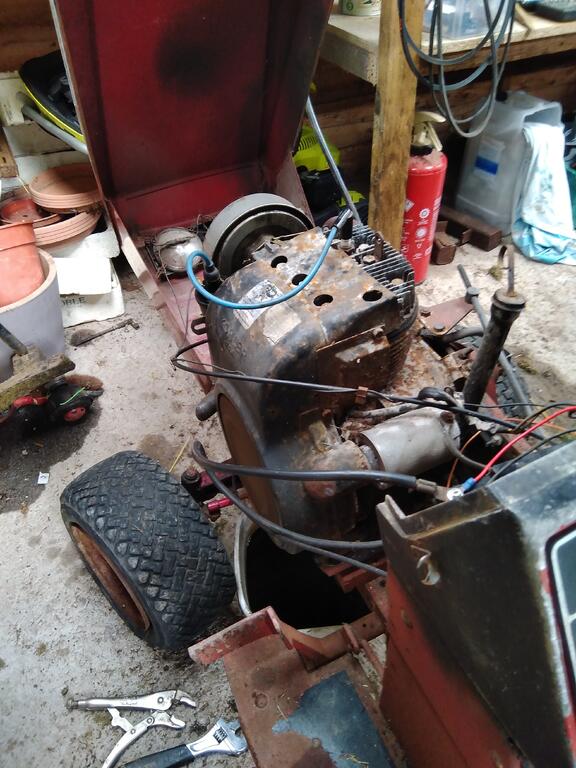

Dan.gerous 2,696 #29 Posted August 7, 2020 (edited) It's alive, after a bit of messing about managed to get some life into the little C125. Needed new coil and condenser and using an external tank as haven't cleaned the main one yet. Will have it out workng in no time though. What an excellent afternoon! 😁😁😁 Edited August 7, 2020 by Dan.gerous 1 1 Share this post Link to post Share on other sites

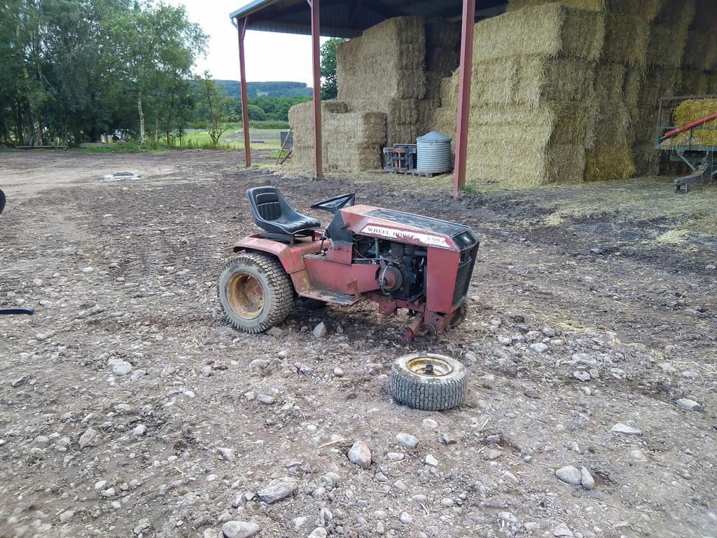

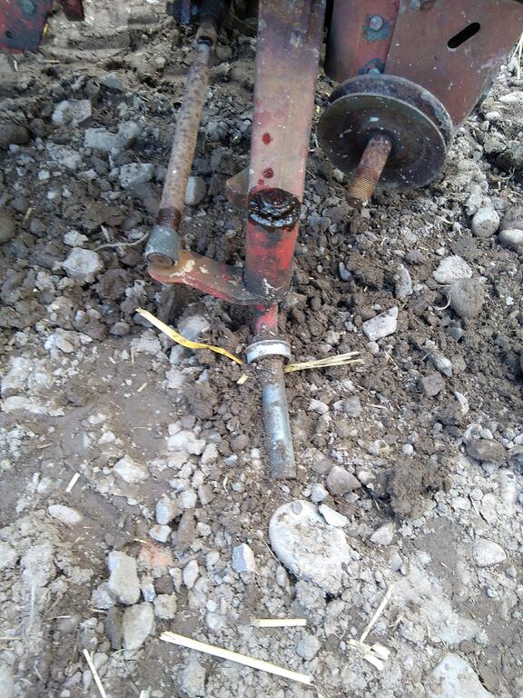

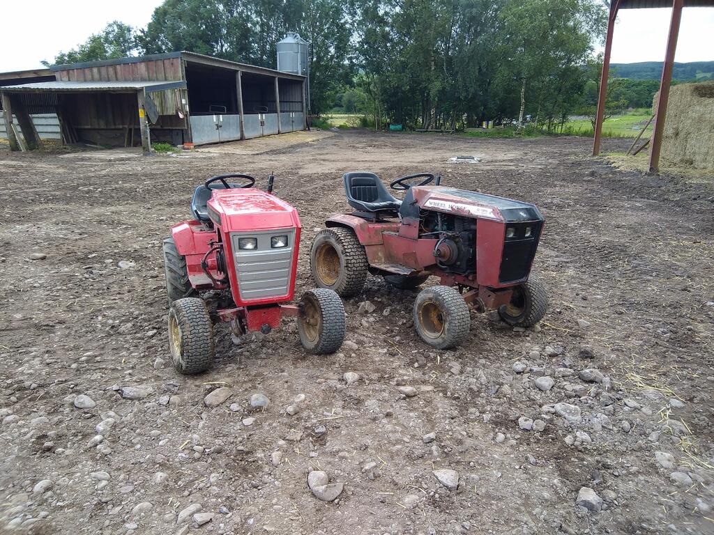

Dan.gerous 2,696 #32 Posted August 7, 2020 Woops! It felt faster than my main C125 so we took them down to the courtyard for a drag race. It's way way faster! But the wheel fell off at the end of the run. The engine seems to rev much higher or something, not really sure. Also not 100% sure if it's charging but that's tomorrow's problem. Will try and get all the C125's out for a photoshoot tomorrow 1 Share this post Link to post Share on other sites
Stormin 9,988 #33 Posted August 7, 2020 (edited) Be carefull of over reving it. Check in the manuals section for max revs. Can't remember off hand, but someone will chip in. Check if the drive pulleys are the same as well. It may have been geared up. Edited August 7, 2020 by Stormin 1 Share this post Link to post Share on other sites

Dan.gerous 2,696 #38 Posted August 7, 2020 Forgot to say, I changed all the oil today once it was running. Engine had good levels and was clean but replaced it anyway, who knows how long is been in there. Gearbox had no water in it, always a bonus. However it was also bone dry, didn't register on the dipstick at all. Filled it up and it all works fine, was a little noisy for first 100m or so but then quietened down. Tough little machine these. 1 Share this post Link to post Share on other sites
