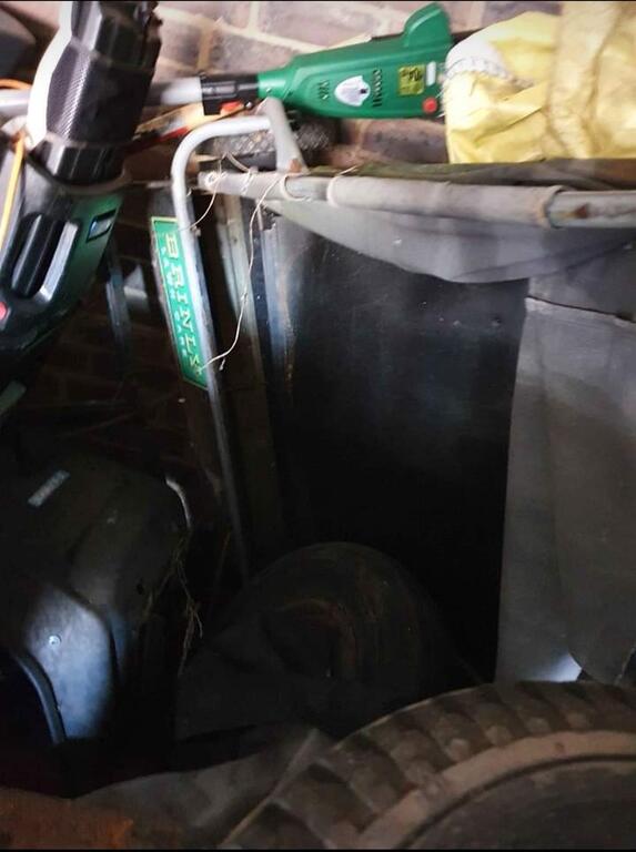

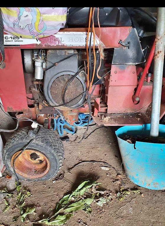

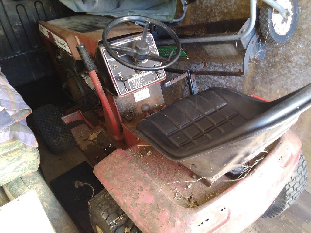

Dan.gerous 2,696 #1 Posted July 25, 2020 Another C-125 has found it's way into my herd. Although it's a 14 hour round trip, it was cheap, has an attachment I wanted and could be a spare parts machine.....although that never happens! Comes with a wheelhorse sweeper, they fetch about £70-£100 over here and I got the whole lot for £200. Should be a winner even if it never starts. My wife is so understanding, I think she enjoys the wheelhorses as much as I do. 5 1 Share this post Link to post Share on other sites

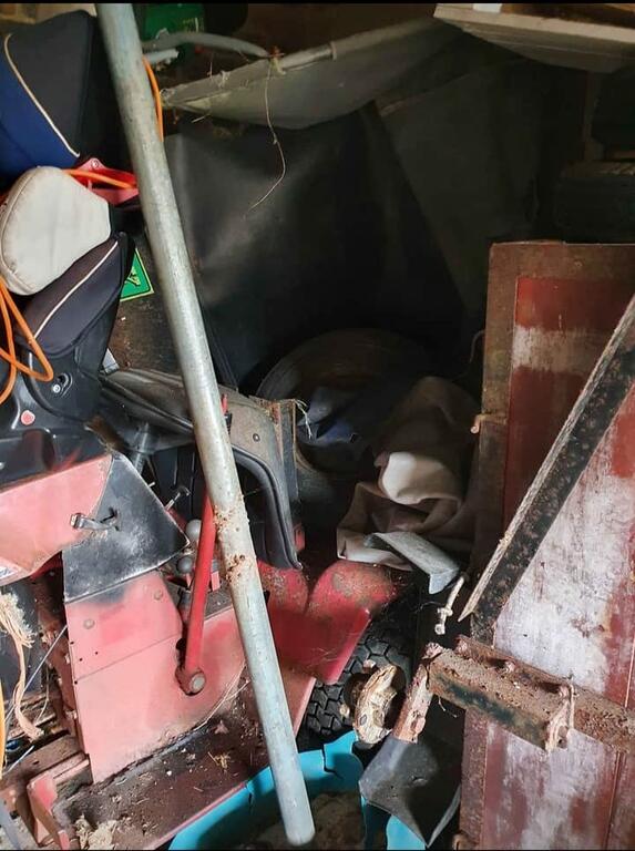

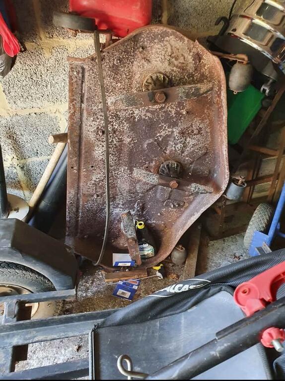

Sparky-(Admin) 26,693 #3 Posted July 25, 2020 Congrats! So that rear discharge mowing deck looks odd...unless the picture is distorted. Is the blade at the bottom (of the pic) really that small? Even the deck shell has an odd shape 1 Share this post Link to post Share on other sites
Dan.gerous 2,696 #4 Posted July 25, 2020 23 minutes ago, Sparky said: Congrats! So that rear discharge mowing deck looks odd...unless the picture is distorted. Is the blade at the bottom (of the pic) really that small? Even the deck shell has an odd shape Thanks 😊 It must be perspective for the deck, otherwise I specialise in picking up odd decks! The deck I got on Thursday had the odd off set mounting point for doing kerbs. It does however look a bit bent - I'm sure someone will be asking to advise us shortly.... 1 Share this post Link to post Share on other sites

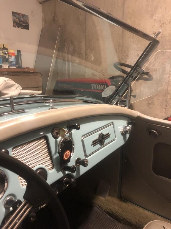

WheelhorseBob 1,550 #8 Posted July 27, 2020 i like nice things as well and my wife is very understanding. pic for you..... 4 Share this post Link to post Share on other sites
Dan.gerous 2,696 #9 Posted July 27, 2020 6 hours ago, WheelhorseBob said: i like nice things as well and my wife is very understanding. pic for you..... What is it? Share this post Link to post Share on other sites
WheelhorseBob 1,550 #10 Posted July 27, 2020 It's a 1959 MGA 1600 parked next to my 520H. It was meant for cruising the country roads on your side of the pond. 3 Share this post Link to post Share on other sites

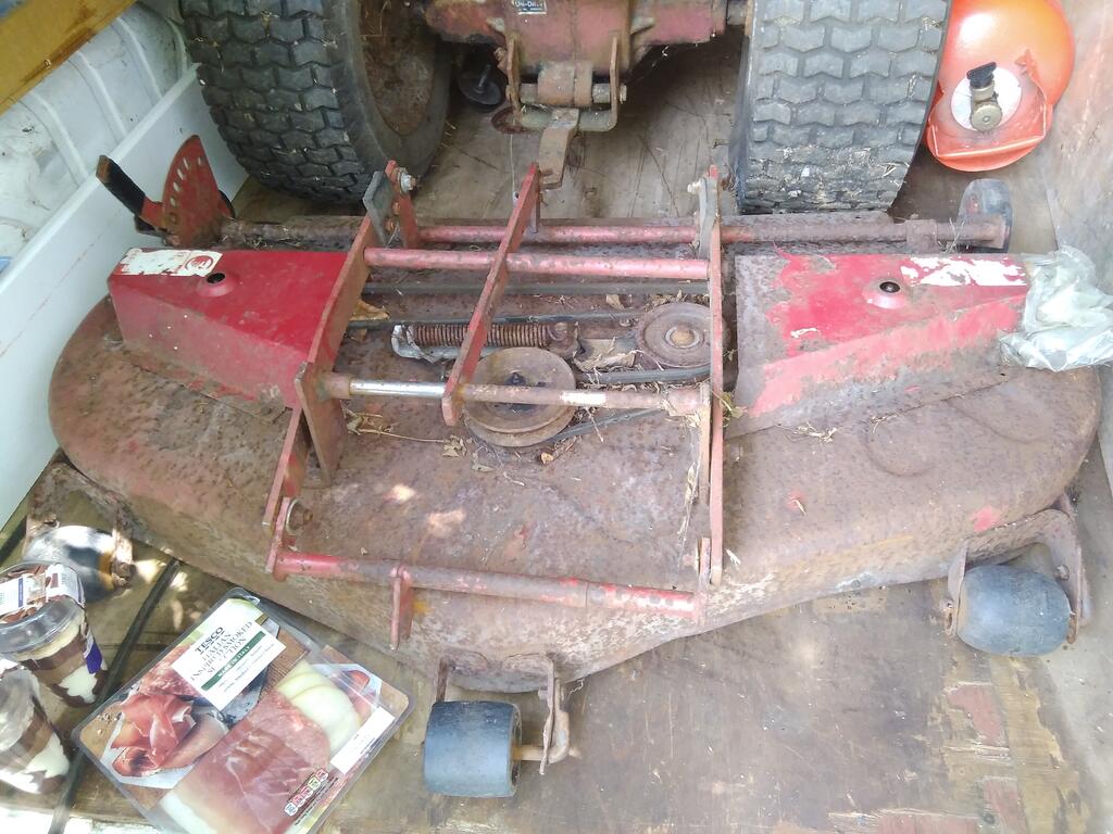

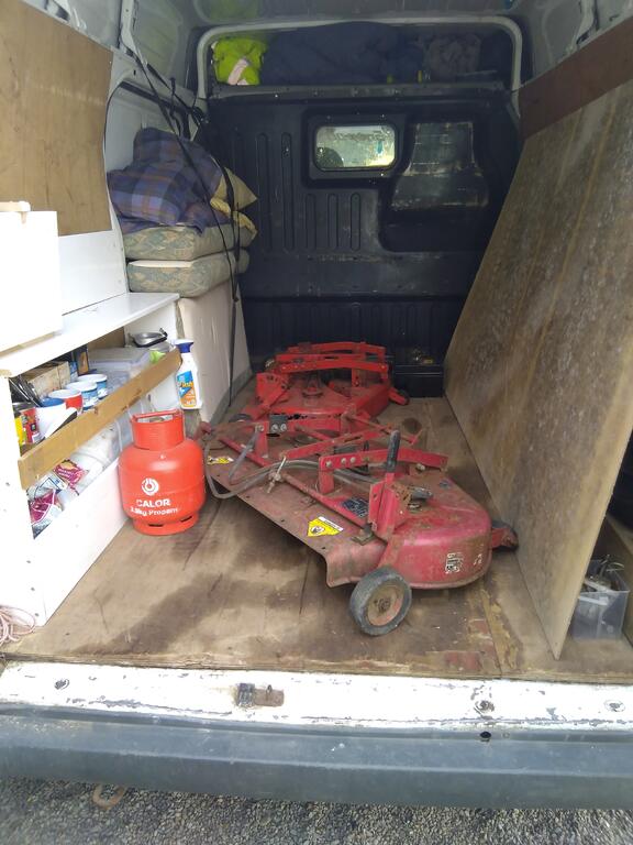

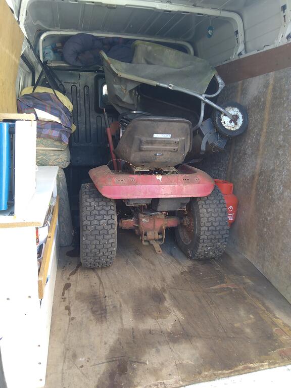

Dan.gerous 2,696 #14 Posted July 30, 2020 Van loaded, heading north again 😊 Mower deck has a couple of fractures but otherwise looks in ok shape, certainly salvageable. It comes with a grass sweeper - awesome! Wheelhorse has seen better days but it all looks very original, no bodged jobs on it. Will put fresh oil in, clean carbs and see if it runs once we get home. Great to meet Mick, pity we couldn't hang around long. 2 3 Share this post Link to post Share on other sites

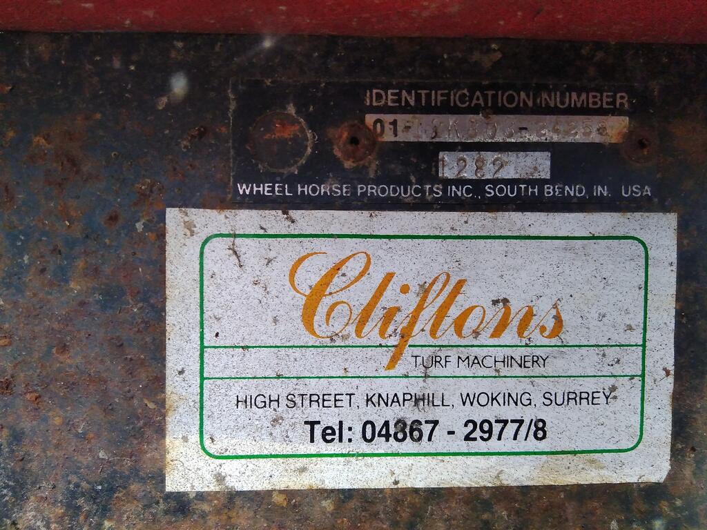

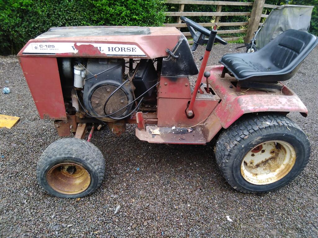

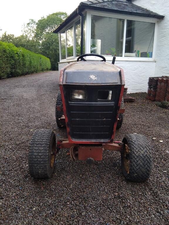

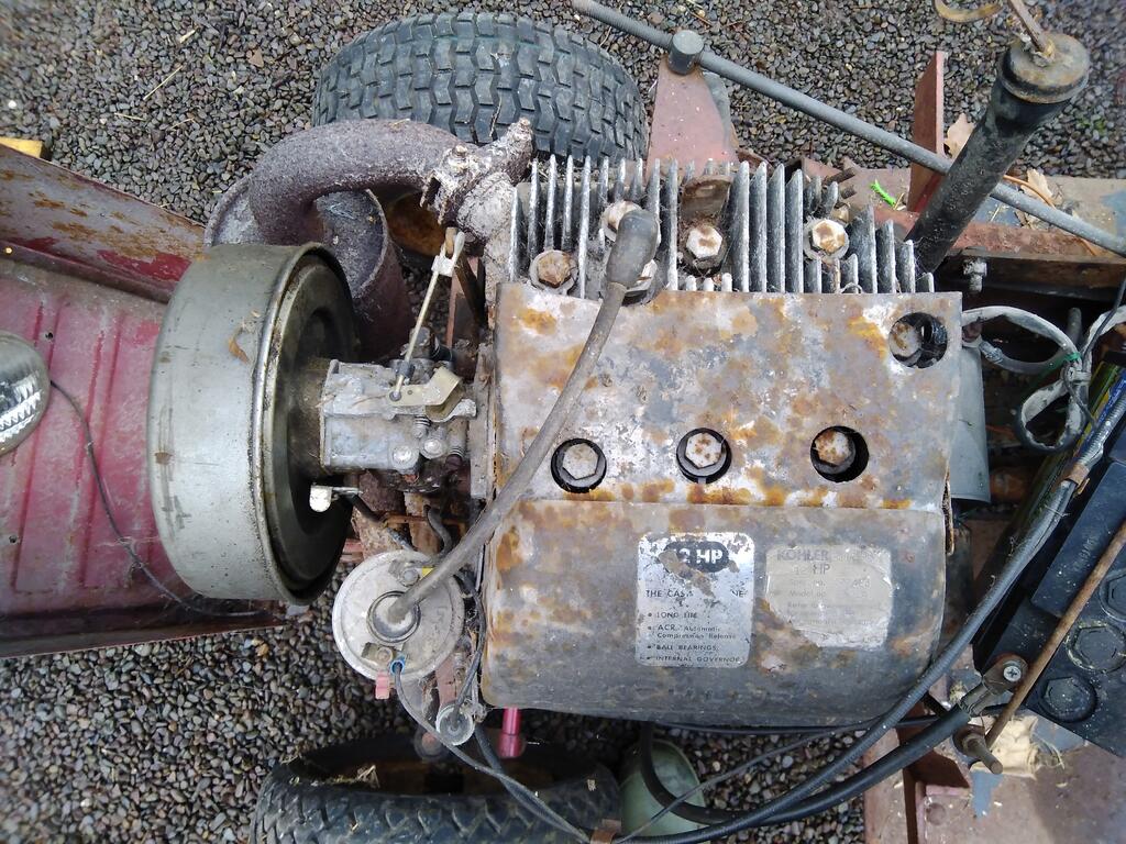

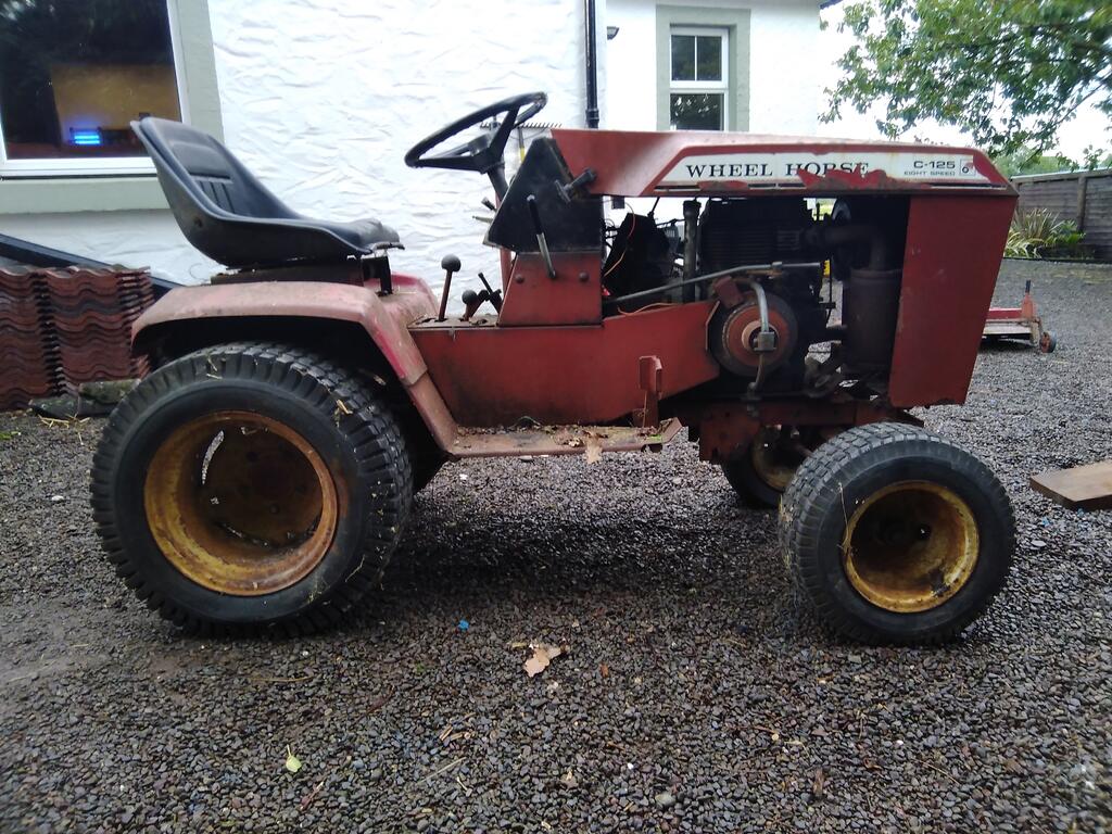

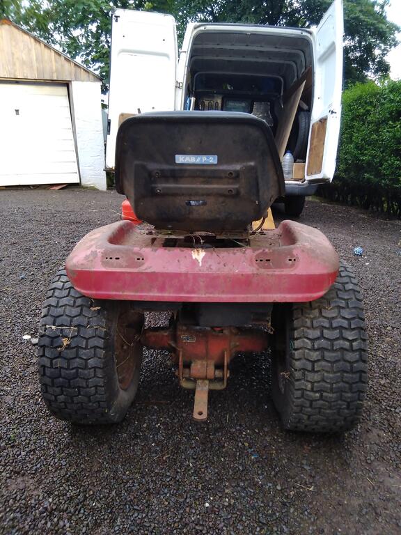

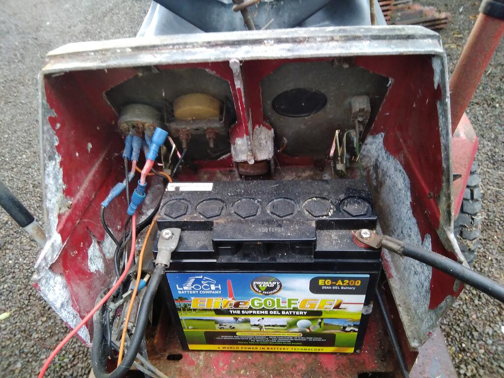

Dan.gerous 2,696 #19 Posted July 30, 2020 I'm home. Grabbed everything out of the van for some quick photographs. Checked fluids, all good so turned it over on the starter - all nice and free. Need to hook up an external fuel tank in the morning and see if I have spark and then try get this thing running. There is no key but I think a screw driver will work for now. You guys can judge the machine based on the photographs 😊 It ended up being an 850 mile round trip trip, but another wheelhorse in the stables has to be worth it. Now I just need to get all of mine looking half as good as Mick's! 1 2 Share this post Link to post Share on other sites

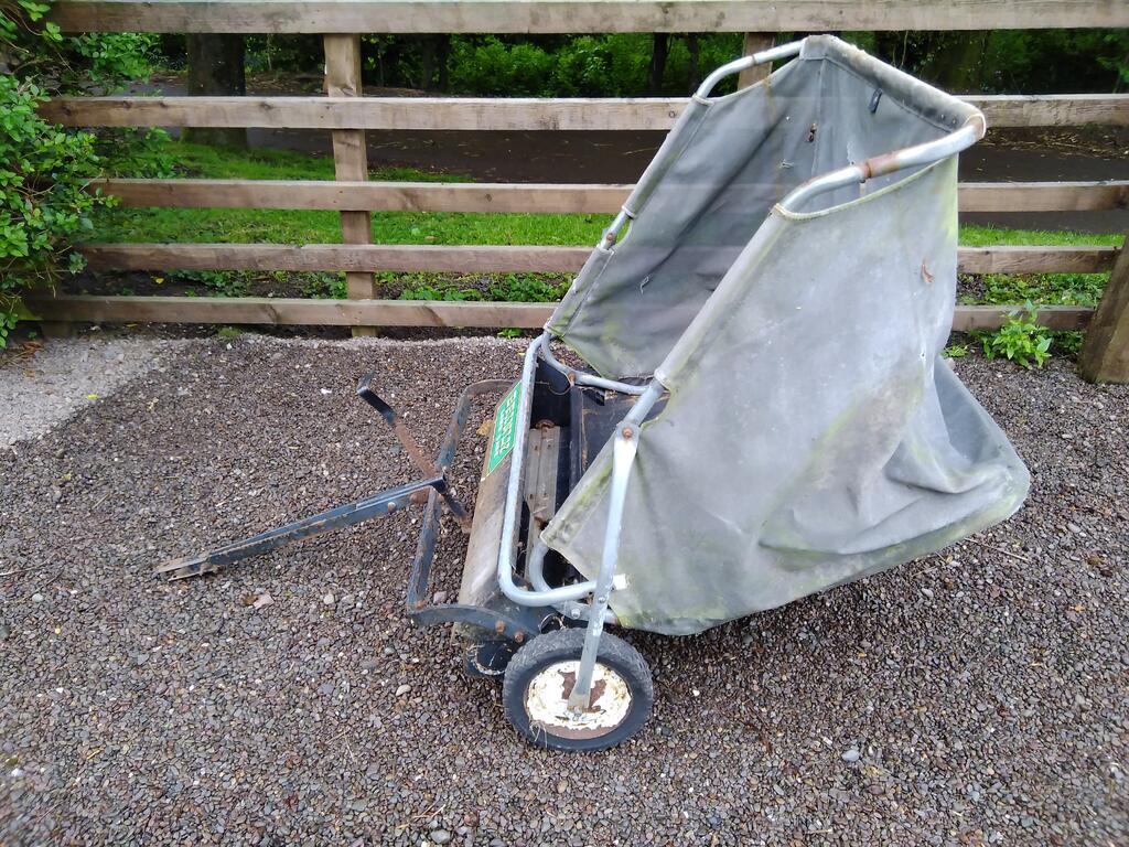

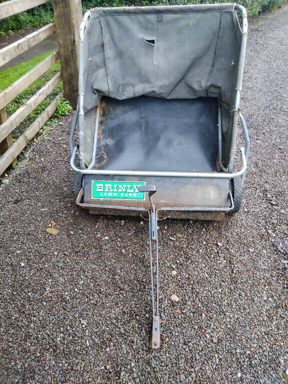

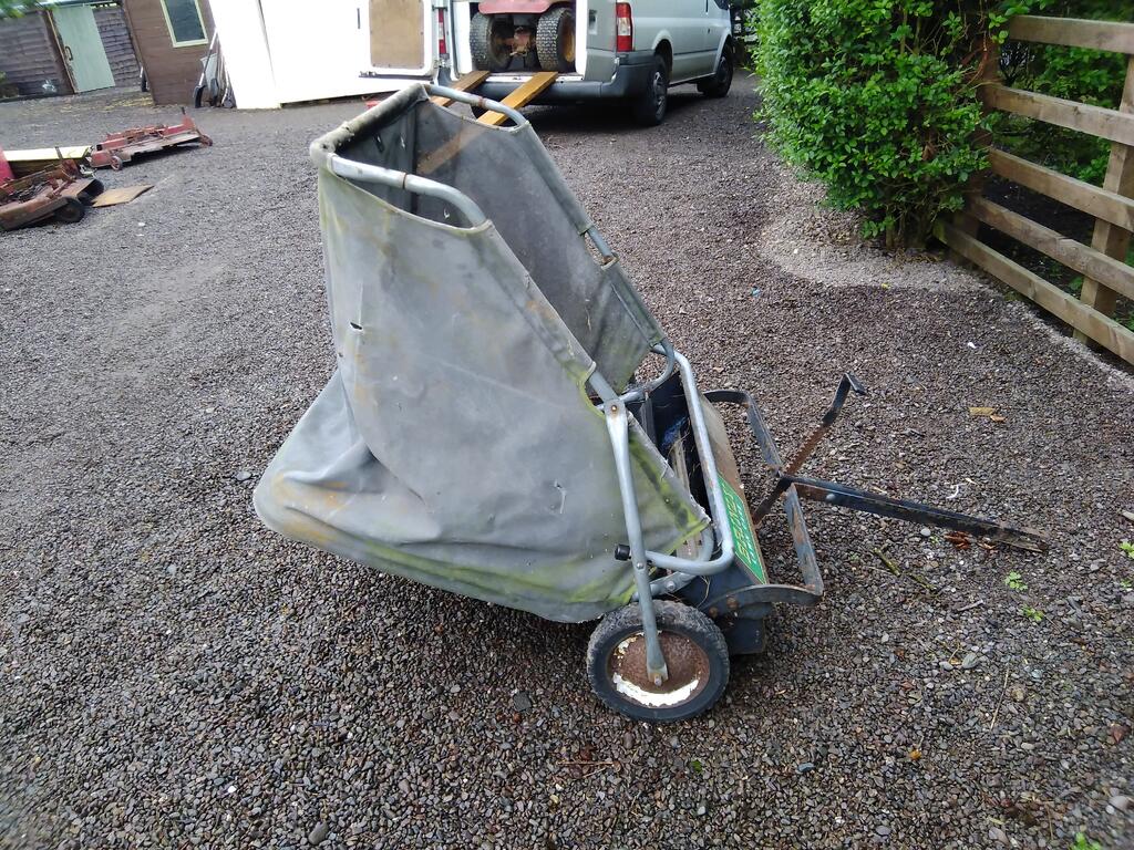

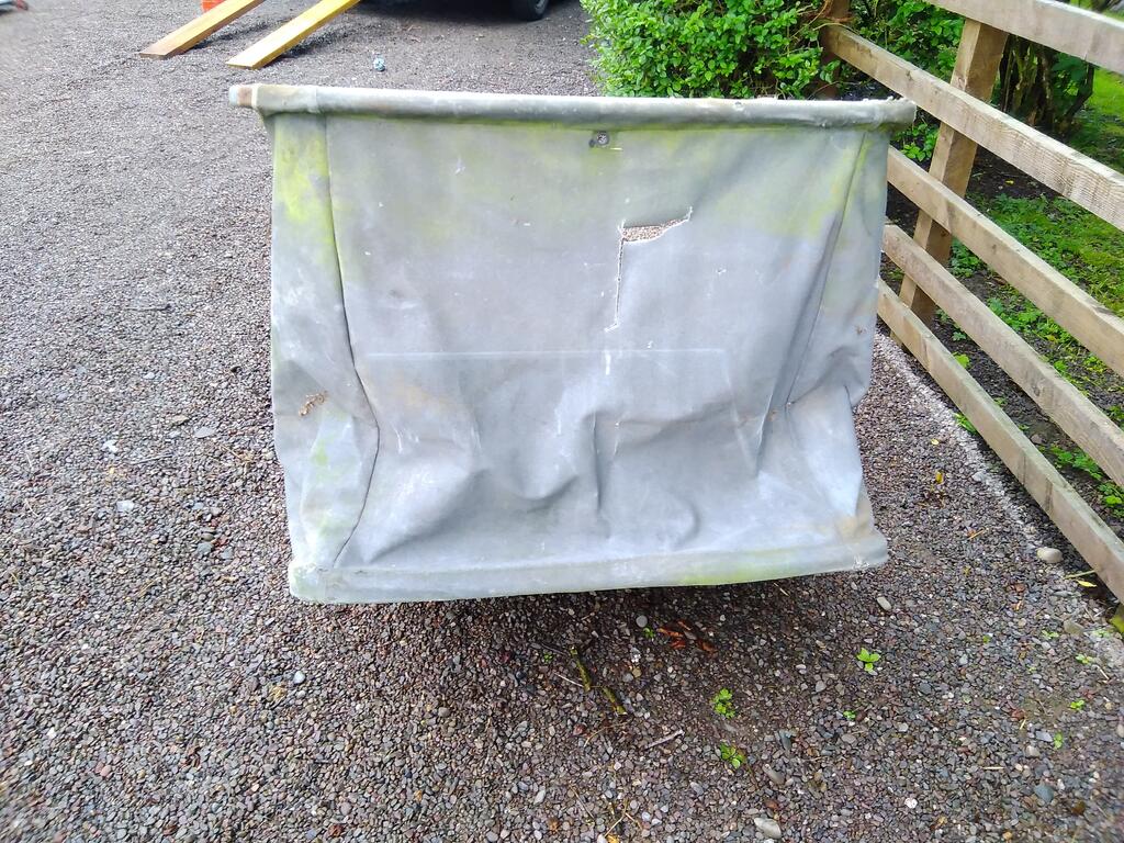

Dan.gerous 2,696 #20 Posted July 30, 2020 The sweeper, it's in ok condition - no idea how to get it to work properly but will hook it up to Marie's wheelhorse in the morning and have a play. 2 1 Share this post Link to post Share on other sites

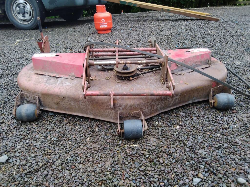

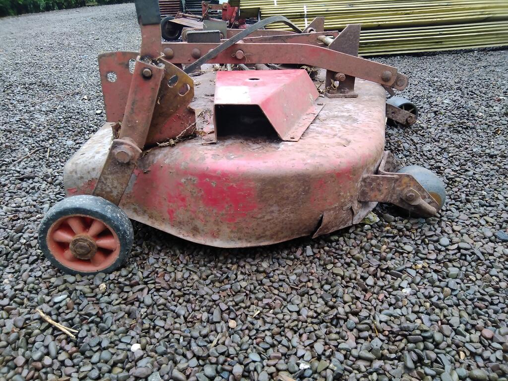

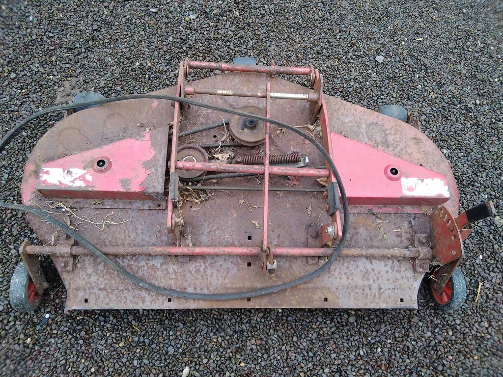

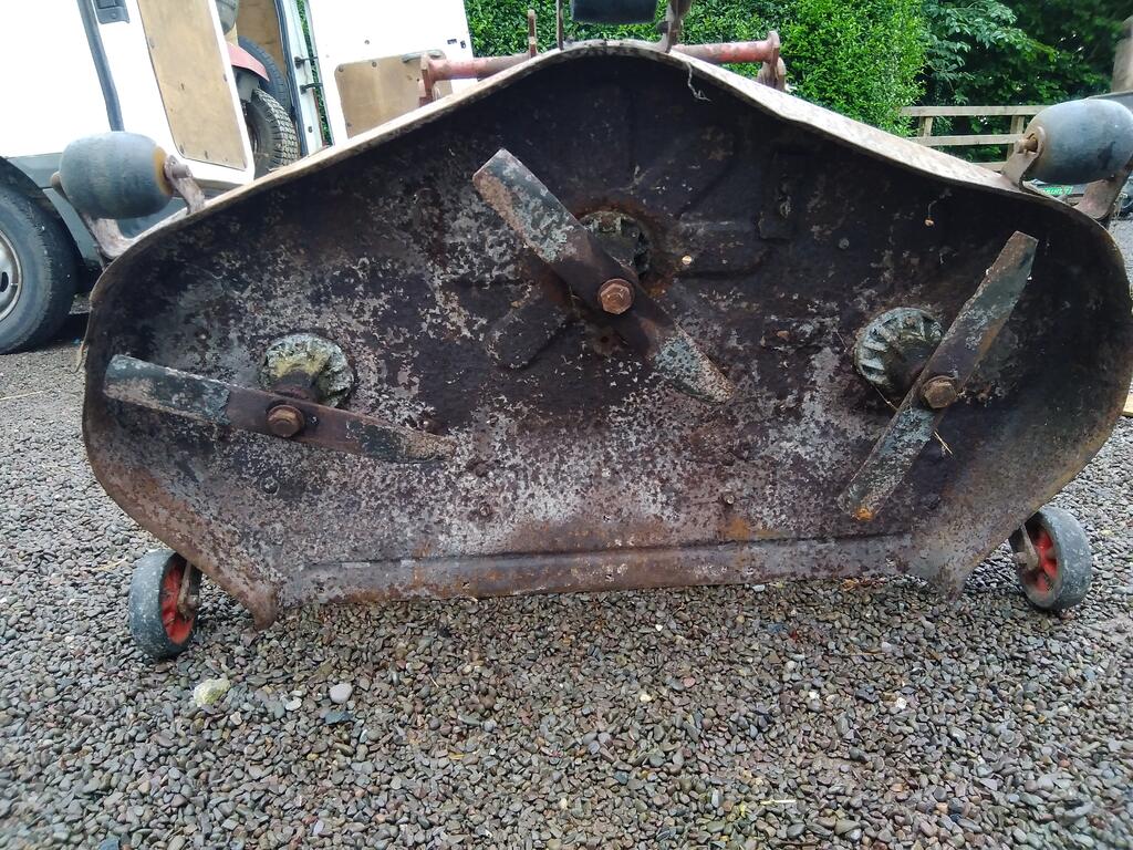

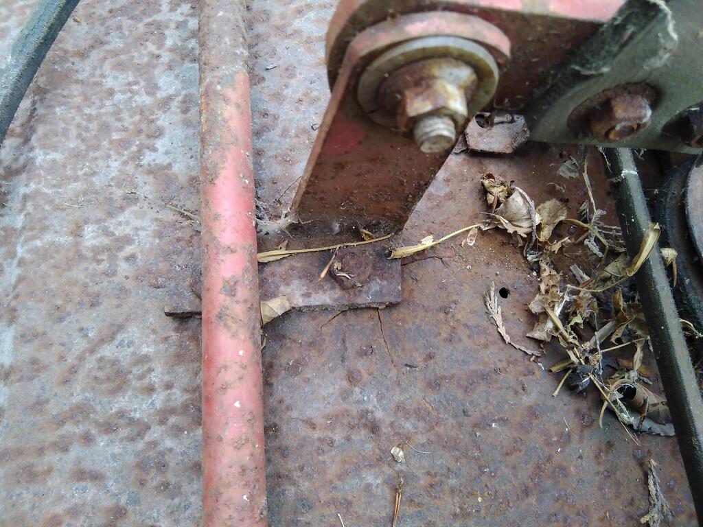

Dan.gerous 2,696 #21 Posted July 30, 2020 And finally the mower deck - it's not rusted out which is a nice surprise! See the fractures, what's the best way to fix them? Once that's done will get it blasted and repainted. It will be great having a side discharge and a rear discharge in the collection 😁 1 Share this post Link to post Share on other sites
Pullstart 71,521 #22 Posted July 30, 2020 If you disassemble the deck, I’d suggest plating the cracked area. Drill an 1/8” or so (1mm?) hole at the end of each crack to prevent it spreading, then grind a V notch along the crack and weld it up! 2 Share this post Link to post Share on other sites
Dan.gerous 2,696 #23 Posted July 30, 2020 1 minute ago, pullstart said: If you disassemble the deck, I’d suggest plating the cracked area. Drill an 1/8” or so (1mm?) hole at the end of each crack to prevent it spreading, then grind a V notch along the crack and weld it up! Thanks, I'm a novice at this stuff so the advice is appreciated. Three of the brackets have the fractures. Share this post Link to post Share on other sites
Tractorhead 9,218 #24 Posted July 30, 2020 If you be able you can reinforce them maybe after doing Pullstarts rework advice with an added Steelplate in the broken section to stiffned the Welded sections a bit more. 1 Share this post Link to post Share on other sites
AHS 1,703 #25 Posted August 1, 2020 @Dan.gerous Restore the deck! There aren’t many left, many rear discharges!! I restored a 42” RD, with new bearings, and some welding, and it’s a new deck to my collection. 1 Share this post Link to post Share on other sites
