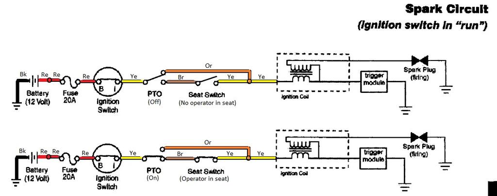

gwest_ca-(File Mod) 12,489 #2 Posted July 25, 2020 Welcome to the forum. The first thing I would do is check the function of the switch. Sounds like it is failing to power the I (eye) terminal with key in start position. Very common switch. Click on the picture for the procedure Garry 1 Share this post Link to post Share on other sites

Koobs 0 #6 Posted July 25, 2020 I replaced the ignition switch, and that didn’t help. I should of mentioned that. I tested the terminals in the different positions, and the new switch functioned properly. Any other ideas guys? Share this post Link to post Share on other sites

lynnmor 9,042 #9 Posted July 26, 2020 Your tractor has several relays that control the ignition, if one of these are bad it might be your problem. Download the demystification guide and check the circuits pertaining to starting and ignition. Share this post Link to post Share on other sites
gwest_ca-(File Mod) 12,489 #10 Posted July 27, 2020 Garry Share this post Link to post Share on other sites
gwest_ca-(File Mod) 12,489 #11 Posted July 27, 2020 If the ignition switch is working properly the ignition power from the ignition switch is the same in START and RUN. Garry Share this post Link to post Share on other sites
