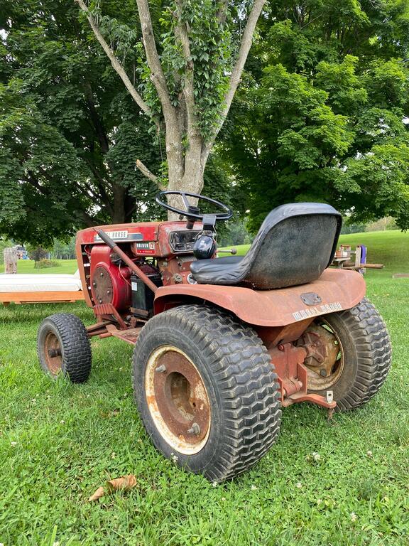

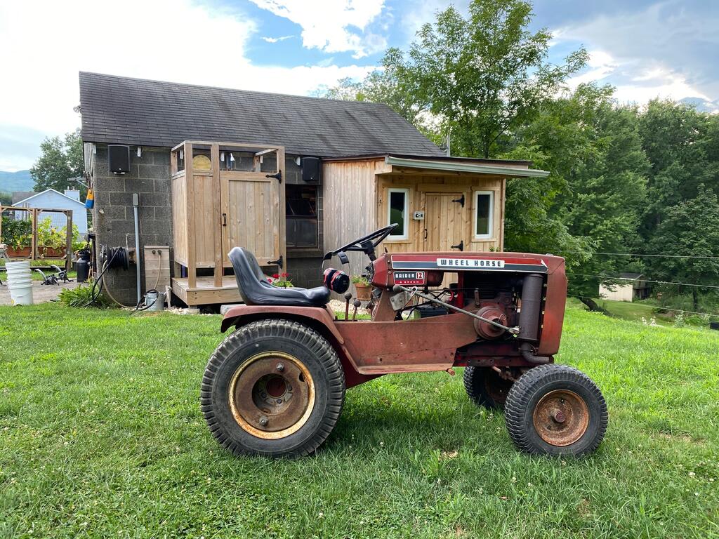

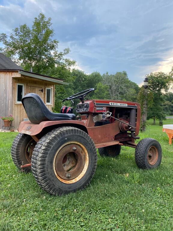

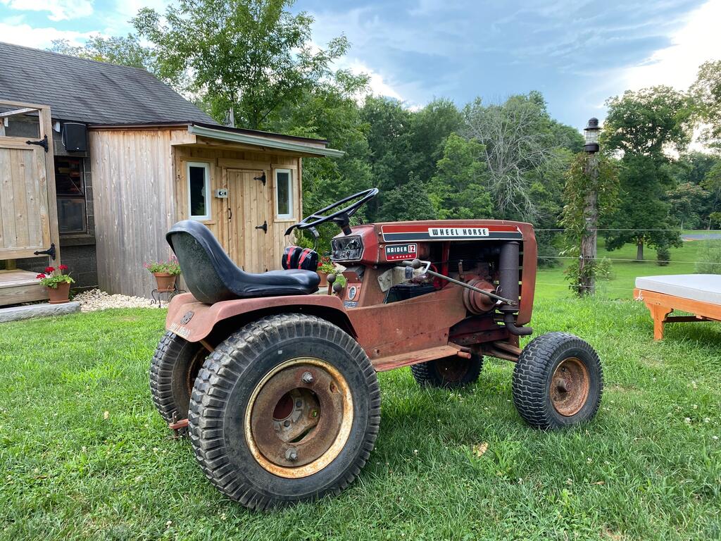

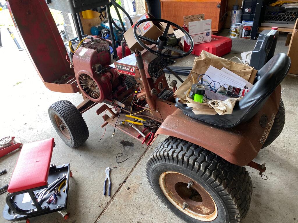

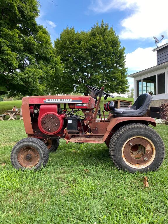

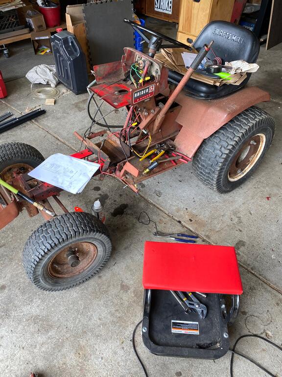

Ro-Go 76 #1 Posted July 23, 2020 All pics are from today. This is the 2nd Wheel Horse I inherited from my grandfather. A '72 Raider 12. Not the prettiest, but it's back to work. I mowed with this one at my house about a decade ago and it worked well. Now it's spinning like a top. Work done: Oil pan gasket; New ignition system: Dave Kirk Transducer Ignition (2nd one I've installed, all good) and yellow plug wire; iSavetractors new coil and points; New ignition switch. fixed/cleaned/lubed/patched wiring; cleaned up regulator/rectifier; Facet 1077 solid state electronic fuel pump; Replaced head and head gasket; New Champion plug; Valvoline VR1 racing oil 10w-30; Fresh 80w-90 tranny fluid. General (not thorough) grime cleaning. Added Gibbs oil to all bolts I unscrewed. QUESTION: Which model mower decks work for this model? I had an old beat up one that I'd like to replace. Cheers. 4 1 Share this post Link to post Share on other sites

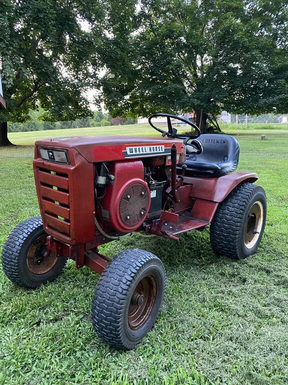

D_Mac 9,337 #5 Posted July 24, 2020 That sheet metal is begging for some attention. I would rub it all down with some boiled linseed oil and see what you got there. Then I would rub it all down again ! Share this post Link to post Share on other sites
Ro-Go 76 #6 Posted July 24, 2020 (edited) On 7/23/2020 at 11:51 PM, D_Mac said: That sheet metal is begging for some attention. I would rub it all down with some boiled linseed oil and see what you got there. Then I would rub it all down again ! I know Mac -- I'll get on it. One thing at a time, garage needs cleaning now. I use Gibbs oil. BLO I use for wood.... Edit: Ok, Mac, better? Edited July 27, 2020 by Ro-Go add a pic. Share this post Link to post Share on other sites
