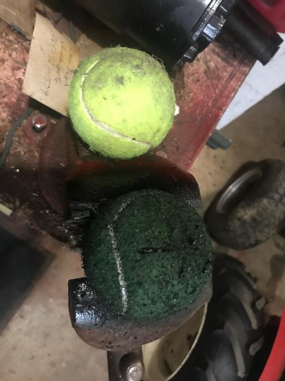

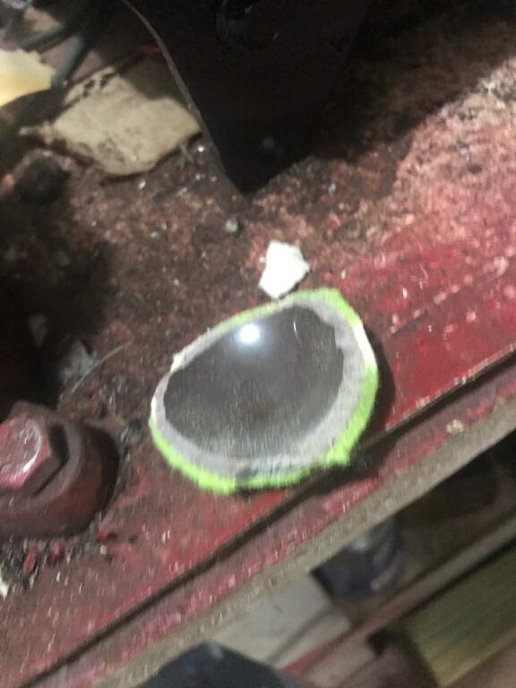

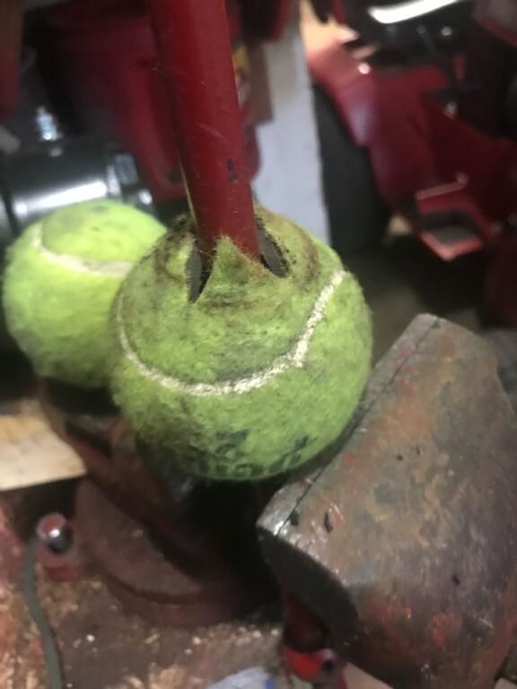

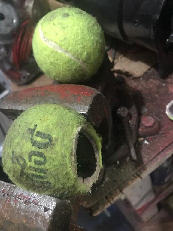

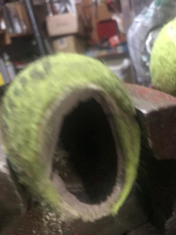

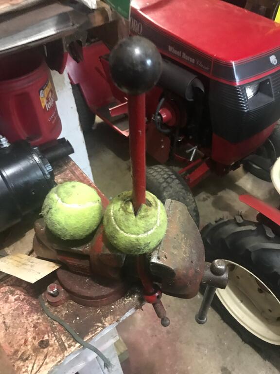

Lane Ranger 11,681 #5 Posted July 22, 2020 This is one item I made several replacement boots out of tennis balls! They are thicker and can be cut with a hack saw on bottom and drilled through on top for shifter! These will last longer than the Wheel Horse boot! 2 2 Share this post Link to post Share on other sites

Felix 145 #9 Posted July 22, 2020 51 minutes ago, Lane Ranger said: This is one item I made several replacement boots out of tennis balls! They are thicker and can be cut with a hack saw on bottom and drilled through on top for shifter! These will last longer than the Wheel Horse boot! I will give the tennis ball trick ago. sounds good. Is it a tight fit on the gearbox or would it need a jubilee clip to secure it? 1 Share this post Link to post Share on other sites
Lane Ranger 11,681 #10 Posted July 22, 2020 (edited) The size of the top cut determines how tight the rest of the ball fits over the shifter and the transmission . No clips should be needed! Edited July 22, 2020 by Lane Ranger Share this post Link to post Share on other sites

Lane Ranger 11,681 #12 Posted July 22, 2020 Ok I found some pics from 2019 (last time I made one of the tennis ball boots for a Wheel Horse shifter on the transmission). This may give you a better idea how to make one of these tennis ball boots for your tractor! 2 1 Share this post Link to post Share on other sites
roadapples 6,985 #13 Posted July 22, 2020 Good idea Lane, but wouldn't it be better to drill the top hole for a tighter fit on the rod... 1 Share this post Link to post Share on other sites
Lane Ranger 11,681 #14 Posted July 22, 2020 I usually do with a wood bit but this was a quick job on a Work tractor. You do have to cut bottom out first before drilling! 3 Share this post Link to post Share on other sites
