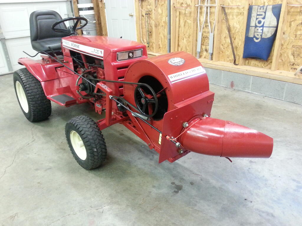

JAinVA 4,638 #4 Posted July 21, 2020 Paul that is a slick blower setup.Do you remember where the squirrel cage came from? Neat repurposing of the blower chute. 1 Share this post Link to post Share on other sites
oldredrider 2,554 #5 Posted July 21, 2020 Jim, it kinda "showed" up here. Buddy of mine had an idea and 1 1/2 hours later it was born and operating. Everything to build it and make it operational was repurposed from stuff I had in the shop. Best implement I've ever used because it works perfectly on my property with a huge abundance of leaves. 2 1 Share this post Link to post Share on other sites

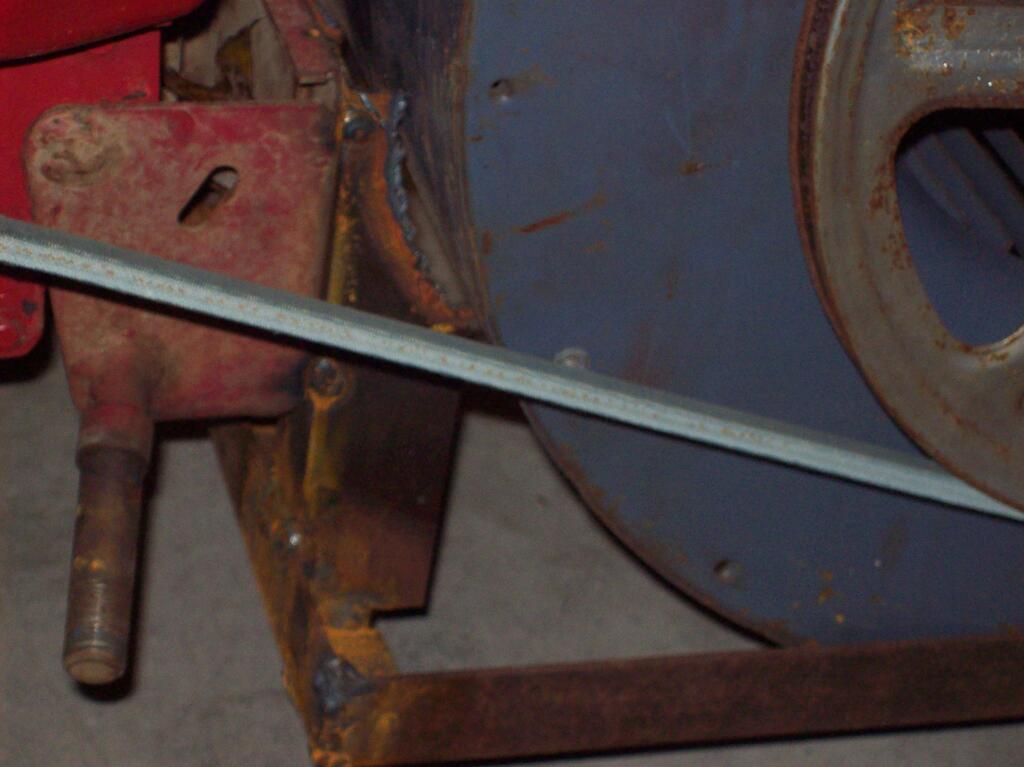

953 nut 70,352 #9 Posted July 21, 2020 4 hours ago, JAinVA said: Paul that is a slick blower setup.Do you remember where the squirrel cage came from? Neat repurposing of the blower chute. Talk to any heat/air conditioning contractor the does commercial work. When units are replaced the belt driven fan is tossed out. A six pack should get it done for you. Mine was on the way to the scrap metal dumpster and the guy was glad to toss a couple into the bed of my truck. Used an old muel drive and some bed frame metal to mount it. 5 1 Share this post Link to post Share on other sites
