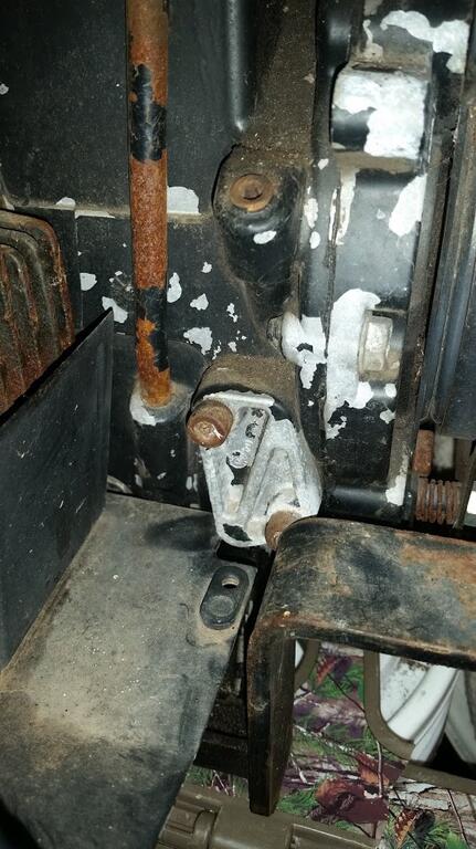

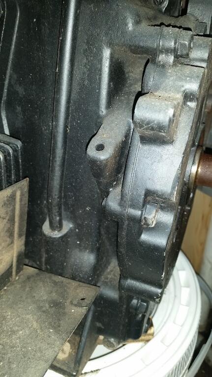

bottjernat1 2,197 #3 Posted July 20, 2020 (edited) Here is the easiest way 1st photo is a series 1 2nd photo is a series 2. See the series 1 doesnt have the block to mount a oil filter the second does. These where 2 motors i had but sold. You need to look for this on the right side of the engine as it sits in the cradle. Edited July 20, 2020 by bottjernat1 Share this post Link to post Share on other sites
