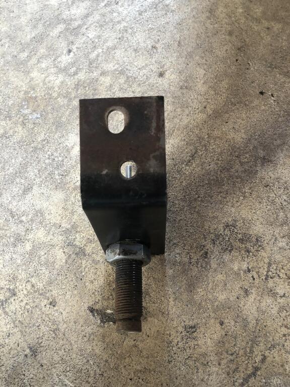

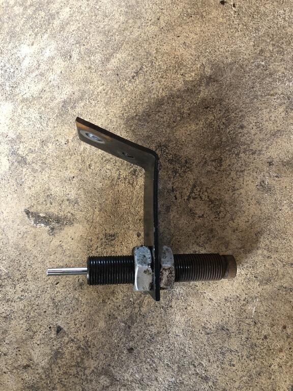

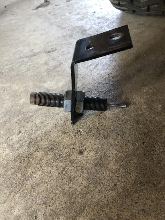

Bill G 24 #1 Posted July 17, 2020 So I started to rebuild my 312-8 . I’m in the process of putting it back together. Unfortunately this is the only part I can’t remember what it is or were it goes . Any help would be greatly appreciated. Thank you Share this post Link to post Share on other sites
Bill G 24 #2 Posted July 17, 2020 The year of my horse is 1988 if that helps Share this post Link to post Share on other sites
Lee1977 7,809 #3 Posted July 17, 2020 (edited) 12 minutes ago, Bill G said: The year of my horse is 1988 if that helps Not sure exactly what the name is but if you have a clutch spring on the left side of the tractor. Throw that thing in the trash. You will be a lot better off. Edited July 17, 2020 by Lee1977 Share this post Link to post Share on other sites
gwest_ca-(File Mod) 12,535 #4 Posted July 17, 2020 Item number 53 in this drawing. I call it an air shock and they get full of dirt and crap. Wash it out and it may still work well. https://www.partstree.com/models/21-12k805-312-8-toro-garden-tractor-1988/clutch-brake-and-speed-control-linkage-5/ Garry Share this post Link to post Share on other sites
The Tuul Crib 7,354 #5 Posted July 17, 2020 (edited) This is the part that prevents the wheely effect when the clutch pedal iz released. Have one on my 414-8 an 87 model. Edited July 17, 2020 by The Tuul Crib Share this post Link to post Share on other sites
Bill G 24 #6 Posted July 17, 2020 Thank you for the replies with all your help I have figured it out . 1 Share this post Link to post Share on other sites
