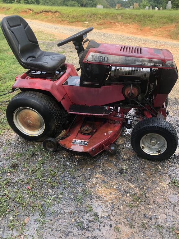

Silveradojeff 13 #1 Posted July 16, 2020 The o’l 520 looks a lil better after pressure washing and a new seat. Runs great and hydraulics work well. Still a long ways to go 7 Share this post Link to post Share on other sites

Pollack Pete 2,273 #4 Posted July 18, 2020 Lookin' good.Get those hub caps shined up! Share this post Link to post Share on other sites
bds1984 1,519 #5 Posted July 18, 2020 She is still better looking than mine! I bet that with some wet sanding and oiling on the paint, it'll clean up even more. 1 Share this post Link to post Share on other sites
