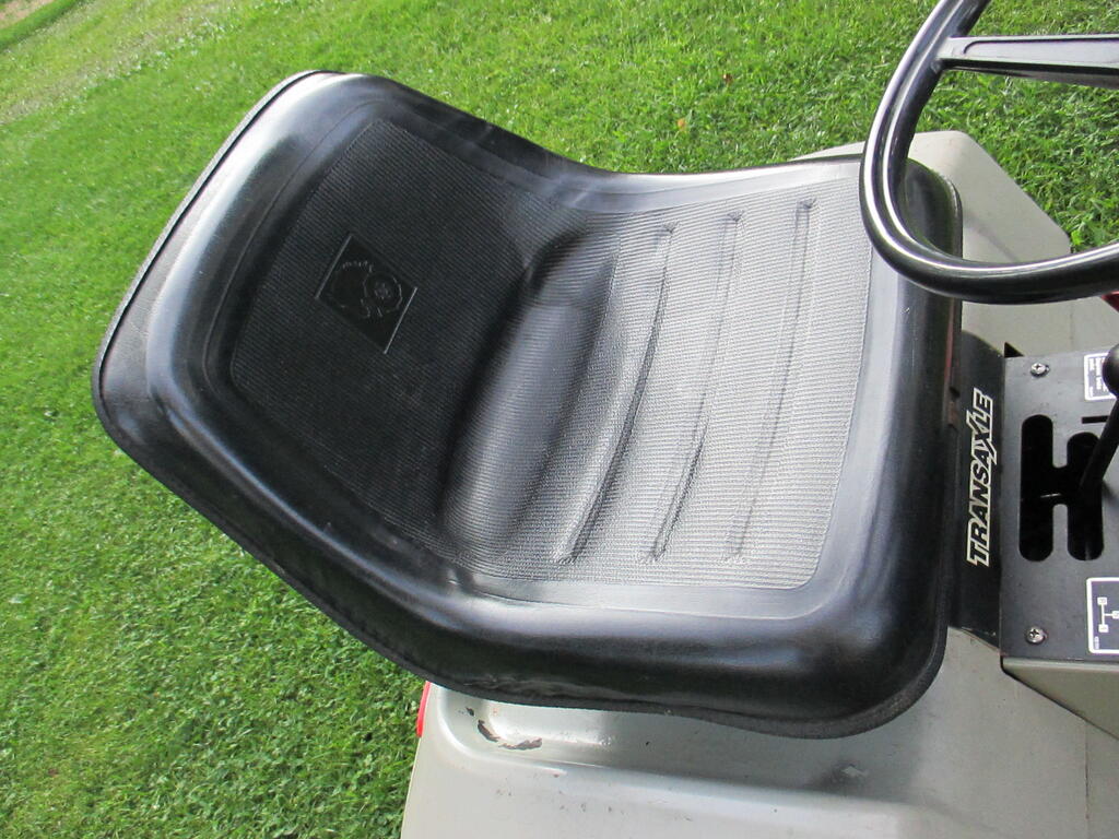

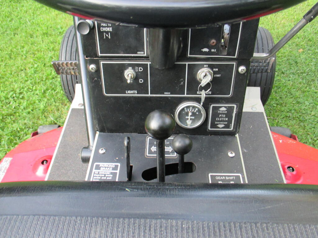

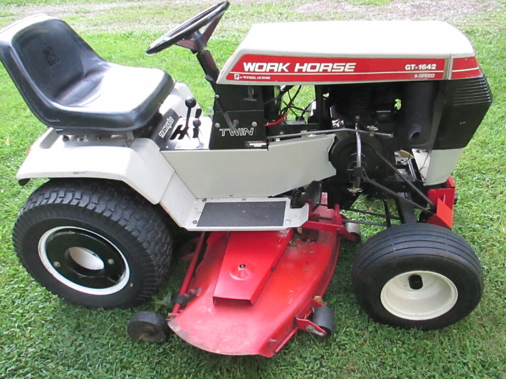

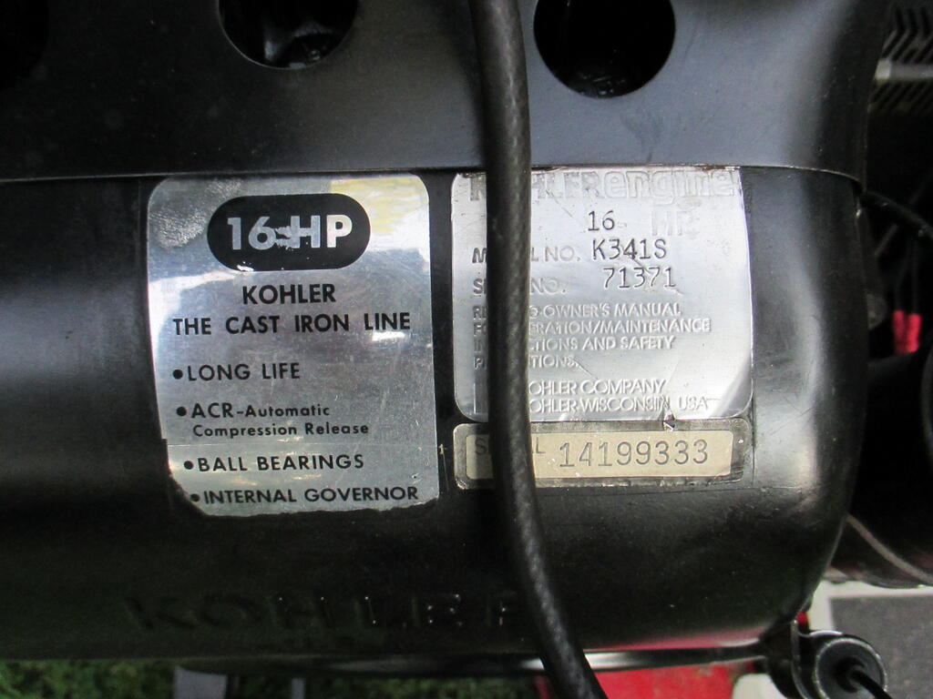

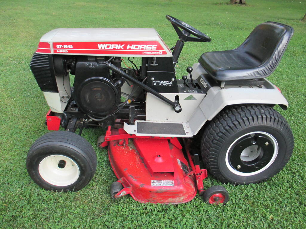

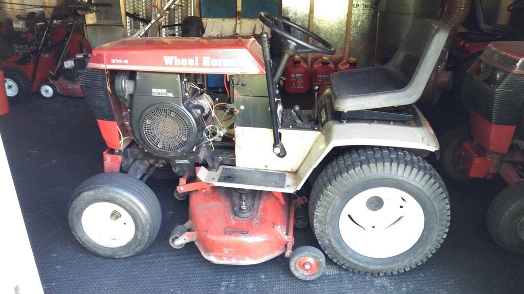

budman2 57 #27 Posted August 26, 2020 (edited) Here is a picture of the workhorse with the 16kohler, I had it wired by a pro! and it runs great! Thanks for all your help guys!!!!!! (budman2) Edited August 26, 2020 by budman2 picture 1 2 2 Share this post Link to post Share on other sites

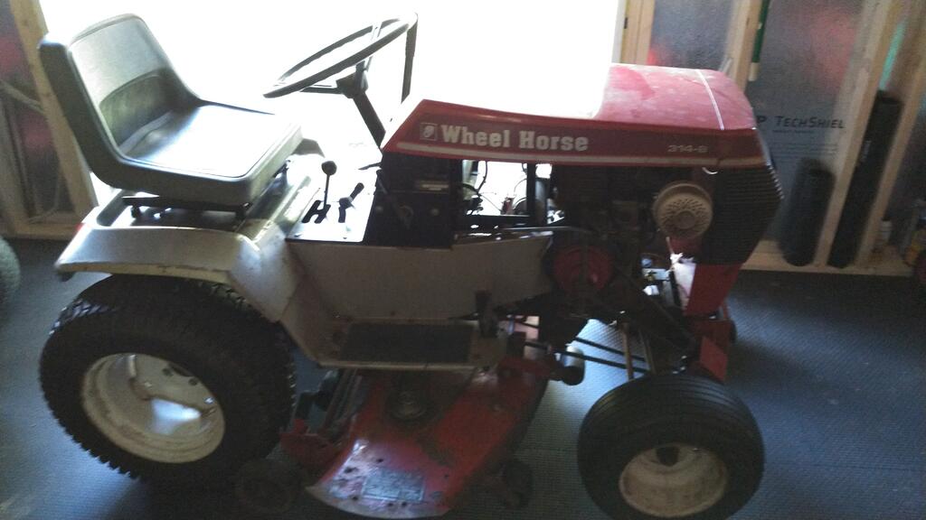

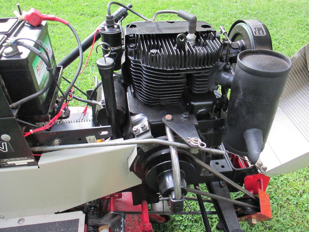

Bill D 3,158 #28 Posted August 26, 2020 Beautiful machine! You will love it even more with a 15" wheel. Makes steering even easier. I also made a new steering column cover by sleeving 3 pieces of plastic pipe together. A piece of 2" IPS, 1" PVC and 3/4" IPS. Cut them at a 46-47 degree angle. I got them all from Home Depot. They sell them in 2' lengths. I wish I had a better picture of how it came out on this machine. Good luck with it. Bill 2 1 Share this post Link to post Share on other sites
budman2 57 #29 Posted August 26, 2020 I copy the bigger steering wheel! it is kind of rinkydink! the 13" one, thanks (budman2) Share this post Link to post Share on other sites
peter lena 10,076 #30 Posted August 26, 2020 BILL D , thanks for the steering column sleeve idea ! all too often answers are hiding in plane site , going to give that a try shortly , pete Share this post Link to post Share on other sites
Bill D 3,158 #31 Posted August 26, 2020 I've done that on a couple of machines now. Use a chop saw with a good sharp blade to cut the pipes. Wear safety glasses! I had a pipe jam up and shatter on me. I was trying to cut all three pipes at once. Cut one at a time. Bill Share this post Link to post Share on other sites
