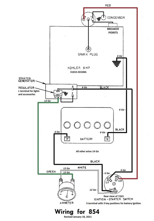

DBlackston 323 #5 Posted October 2, 2022 (edited) Well I am finally getting back into some of my projects after a long hiatus. I found this diagram to help me out in the manuals section. Can anyone tell me if the red wire on the right hand side should be the 12ga or the 5awg? I plan on using 4awg and 14awg as suggested here. Edited October 2, 2022 by DBlackston Typo Share this post Link to post Share on other sites
ebinmaine 77,806 #6 Posted October 2, 2022 24 minutes ago, DBlackston said: Well I am finally getting back into some of my projects after a long hiatus. I found this diagram to help me out in the manuals section. Can anyone tell me if the red wire on the right hand side should be the 16ga or the 5awg? I plan on using 4awg and 14awg as suggested here. Likely was 14 from the factory. I'd use 12 gauge FULL Copper if possible. Share this post Link to post Share on other sites
Handy Don 16,060 #7 Posted October 2, 2022 15 minutes ago, ebinmaine said: Likely was 14 from the factory. I'd use 12 gauge FULL Copper if possible. 41 minutes ago, DBlackston said: I plan on using 4awg and 14awg as suggested here. 4 Ga is overkill, really, IMHO. The recommended 6 ga is perfectly adequate as even stranded can be quite hard to wrangle, especially at the ends connected to the ignition switch. Similarly, I used the recommended 14 Ga (see the "all other wires 14 Ga" note) for the ignition to coil (red) connection on my 854. Probably more important is to make sure the connections are solid and protected from corrosion--I use dielectric grease but others use vaseline! BTW, if you plan to add lights or other powered accessories and don't have an L connector at the Voltage Regulator, attach them via a fuse at the IGN connection at the switch. 1 Share this post Link to post Share on other sites
953 nut 64,647 #8 Posted October 2, 2022 1 hour ago, DBlackston said: I plan on using 4awg As @Handy Don said the 4 AWG is overkill. Go to your favorite welding supply house with the old cables in hand and have them make up a new set of 6 AWG cables with the correct ends. Connections to the ignition switch behind the dash will be much easier with supple new wire. Share this post Link to post Share on other sites
