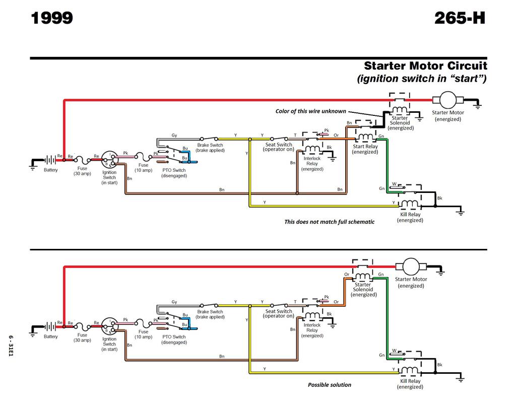

ZX500 0 #1 Posted July 15, 2020 Hello haven't been here in a while. My 265h sometimes doesnt start. Turn key and nothing. Now with key on run if I pull the pto switch to on it will click then I push it back in turn key to start and it starts right up. Is this the pto switch a relay or the pro itself? Ps bypassing seat switch to rule out Thanks Also how can I find an old topic on same machine for low voltage module? Share this post Link to post Share on other sites

gwest_ca-(File Mod) 12,416 #3 Posted July 15, 2020 Happen to be in the middle of adding color to the wiring pages for this model. What is done is now with the file above. I disconnected one relay as I don't think this model uses it. Added color to wires that go to switches and relays but are not used in each illustration. The reason I did that is you have no way of knowing what relay does what. This way you can identify them by the colors that go to the component. Still have 2 pages to do. Keep us posted with your progress. Garry Share this post Link to post Share on other sites
gwest_ca-(File Mod) 12,416 #4 Posted July 15, 2020 Finished coloring the wiring. If you need to test the pto switch the procedure is in this file Garry 1 Share this post Link to post Share on other sites
gwest_ca-(File Mod) 12,416 #5 Posted July 16, 2020 Could use your help here or from anyone that has this model. The large schematic does not match the detailed drawings at the starter. They may be confusing a start relay with the starter solenoid or it may have both. What colors are the small wires going to the starter solenoid? Garry Share this post Link to post Share on other sites

ZX500 0 #7 Posted July 17, 2020 13 hours ago, gwest_ca said: Could use your help here or from anyone that has this model. The large schematic does not match the detailed drawings at the starter. They may be confusing a start relay with the starter solenoid or it may have both. What colors are the small wires going to the starter solenoid? Garry Orange & green Share this post Link to post Share on other sites

gwest_ca-(File Mod) 12,416 #9 Posted July 17, 2020 10 hours ago, ZX500 said: Orange & green Thank you. I could not see the need for a start relay so will change the drawing. They did use one on an earlier model. Garry 1 Share this post Link to post Share on other sites
