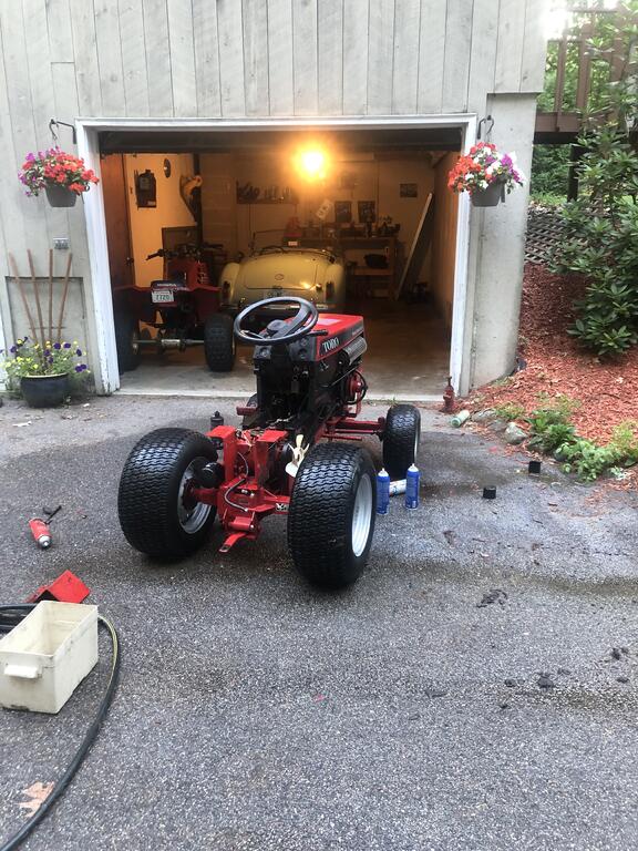

Well today I stripped the 520 down for a though cleaning. This machine only has 318 hrs on the clock but what a mess! I've never owned a rear discharge deck but this is making me think rear discharge isn't a great idea with a hydro tractor. I've never seen so much debris packed in the rear as on this one. All the dirt and clippings blow out the back for the hydro fan to blow all over the transaxle. Oh well she cleaned up well. The bad, seems oil is leaking some where. The right side or fan side was encrusted in dirt that looks to be oil soaked. Now that its clean I have a shot at finding what is leaking. Second, I've already experienced electrical gremlins. It charges at 17+volts verified with a meter. I cleaned all terminals on the VR and mounted it with a new bolt. Still 17+. Also the head lights only work sometimes. I've replaced and cleaned all fuses and will work my way through all electrical connections. My neutral switch was jumped, found that after it wouldn't turn over after cleaning. New switch is probably needed. Good news, the Onan runs like a top and has zero debris in the cooling fins. BTW does Toro still sell the rattle cans of paint? I need to redo the floor board and I've used tat years ago.

I've seen the rattle cans of Toro paint on ebay, but don't know whether the Toro dealers still can get it.   Many of us use Rustoleum Regal Red for a good color match.  There are some 520H expects here on the forum who should be able to advise you on the voltage output.   Might need a new regulator.
Is that an MG in your garage.  Nice car.  Which model?

MG...not Whee lHorse

Thanks for the input guys, I'll check the dip stick and headlight ground. I already ordered an eBay regulator. @ SPINJIM, yes that is my 1959 MGA 1600.
