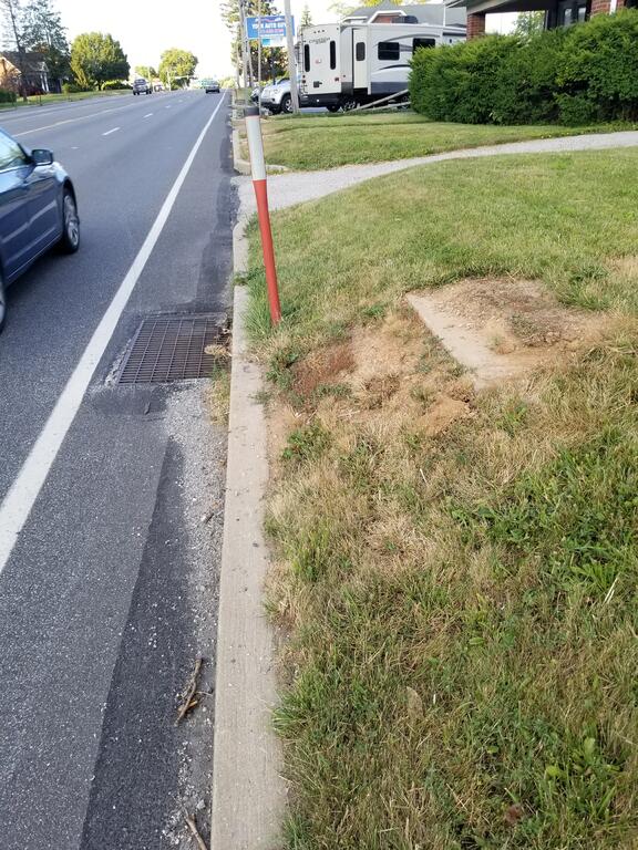

cafoose 3,636 #1 Posted July 12, 2020 Almost twenty years ago they widened the street in front of my house before I bought it. They put a set of pre-cast concrete steps in front of the house right by the right lane of the road which is heavily traveled. There is no sidewalk and no reason for anyone to walk down those steps into traffic. I would like to remove the steps and would like to know if anyone has any ideas how to safely remove them in one piece so I can fill in the spot where they are and plant grass there. I tried covering the steps over a couple years ago with dirt and planted grass but the soil wasn't deep enough for it to grow properly. Share this post Link to post Share on other sites
wallfish 19,400 #2 Posted July 12, 2020 Why does it need to be removed as one piece? Search around for a guy with a backhoe. There's a bunch of guys around here on Craigslist looking to do work like that. Most are retired guys looking to make some extra income with their tractors. Or, check out a local tool rental if you want some seat time in a machine. Skid steer or .... 1 2 Share this post Link to post Share on other sites
Darb1964 1,151 #3 Posted July 12, 2020 If you want to get it out in one piece you could drill holes in it and secure I hook bolts in the concrete. Most hardware stores could set you up. Put them in so when lifted it will stay some what level. Find a tow truck owner self employed, they are more likely to take the job on, may need to dig around it some to help free it up. May even have some experience if you find the right man. I think it would pull out,never know for sure. May have to break it up. 1 Share this post Link to post Share on other sites
8ntruck 8,635 #4 Posted July 12, 2020 To quote Doc Brown in Back to the Future III: "We ,might need to blast!" I agree with Wallfish - someone with a back hoe could make quick work of the removal. 1 Share this post Link to post Share on other sites

Darb1964 1,151 #7 Posted July 12, 2020 I think it may be a a little out of that engine hoists league, unless you break it up, and have a solid place to roll it on. 3 1 Share this post Link to post Share on other sites
SylvanLakeWH 30,664 #8 Posted July 12, 2020 Unless you plan a reuse of the concrete , it’s easier to break up and move by hand. Sledgehammer or small electric jackhammer will make short easy work of it... remove the pieces and fill with dirt / seed... 5 1 2 Share this post Link to post Share on other sites
oldlineman 1,656 #9 Posted July 12, 2020 You can rent a electric jack hammer for not too much and bust it up into smaller pieces.I have used them and they work well not too heavy. Will be a little harder if it has re bar in it, but if you have a gas wrench that makes it easy. Just watch out for the dry grass could turn into a barbecue. 3 1 Share this post Link to post Share on other sites
953 nut 64,341 #10 Posted July 12, 2020 That sucker has been in place long enough that the grass roots and soil have a death grip on it. Pulling it out in one piece ain't happening without a lot of digging. I would bust it up in place with an electric jack hammer and cover it up. There should be a void under it the pieces will fall into. 2 1 Share this post Link to post Share on other sites
peter lena 9,784 #11 Posted July 12, 2020 cafoose , i agree with wall fish on the back hoe work, what you need is overpowering leverage , i had a similar issue with multiple tree stumps clumped in one 20 ft circle , a local contractor working up behind my house , made it effortless. i gave him an aluminum 4x 8 diamond plate sheet , for popping out and getting rid of that stump problem . he put the sheet in his pick up truck bed . just my experience, pete 1 Share this post Link to post Share on other sites
wallfish 19,400 #12 Posted July 12, 2020 Here's a tool rental place near York. http://www.harveysrentall.com/contractors-qr.html Track Hoe/ Mini excavator -- 4 hours $175 minimum and give the delivery guy $20 to wait so you can just reload it back on the truck because it won't take long to dig and pull that out. The biggest problem would be what to do with it after it's out since you want to keep it in one piece. If you have something else to use it for then do the whole 4 hours or the day at $225 and use the machine to place it where it needs to go. Using the machine will be as fun as going to an amusement park so enjoy the ride! Split the cost with a neighbor if any need something done too. Just a tip, go down there and they may let you try it out and show you how to use it so you're not paying for the training time after it's delivered. IMO, the simplest thing is to break it up and use those pieces as the fill and cover it with soil, if you don't want it for something else. 2 Share this post Link to post Share on other sites
AMC RULES 37,254 #13 Posted July 12, 2020 Easiest to just demo that top step in place, then simply top dress that area with a yard of top soil. Like maybe 15 minutes worth of work with that rented electric jack hammer. 3 1 1 Share this post Link to post Share on other sites
bc.gold 3,406 #14 Posted July 12, 2020 Drill a few shallow holes, fill with water then come winter when the water freezes it will expand and crack to slabs. 1 1 1 Share this post Link to post Share on other sites

CCW 1,491 #16 Posted July 12, 2020 Also you can take a grinder and cut some slots and drive a wedge to split the step. Money spent on renting a tool goes into owning a tool. 1 1 1 Share this post Link to post Share on other sites
