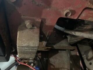

Haficon 12 #1 Posted July 11, 2020 (edited) Hello, While on deployment my wife ran our wheel horse with out oil and seized the K301. So I picked up a K341. Got it into the tractor will require a little more retro fitting but should work. so where I am no is a no spark, I ripped all the wiring out and re did it all following a diagram here. I left out all the safety switches, so engine spins, but no spark. new coil, new condenser, points are gaped, I have 12v at the positive side of the coil with the key on, 12v at the points, and 12v on the negative side of the coil all with the key on. The center of the coil where the plug wire goes also has 12v with the key on... But no spark to the plug. Wire tested good I am picking up a new o e tomorrow just because, new plug and also check with old plug... what am I missing? the voltage regulator is not hooked up. James Blue Edited July 11, 2020 by Haficon Add pictures. Share this post Link to post Share on other sites
