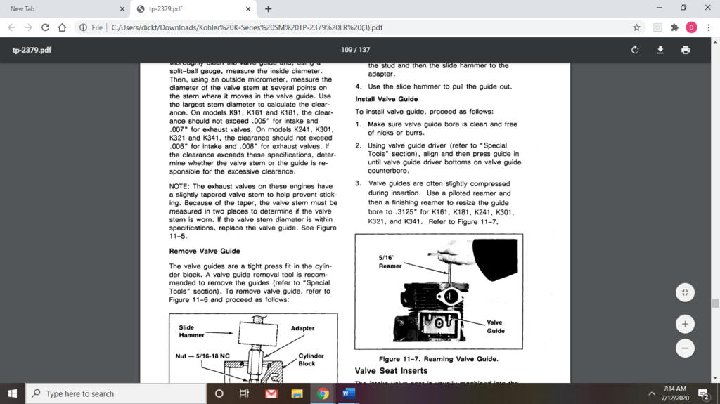

953 nut 70,321 #2 Posted July 12, 2020 13 hours ago, The Tuul Crib said: Do you have to fit these valves with a reamer tool Yes, they need to be reamed. From section 11 of the Kohler Service Manual found in our manuals section. 1 Share this post Link to post Share on other sites

953 nut 70,321 #8 Posted July 12, 2020 Info from the Kohler manual. Share this post Link to post Share on other sites
