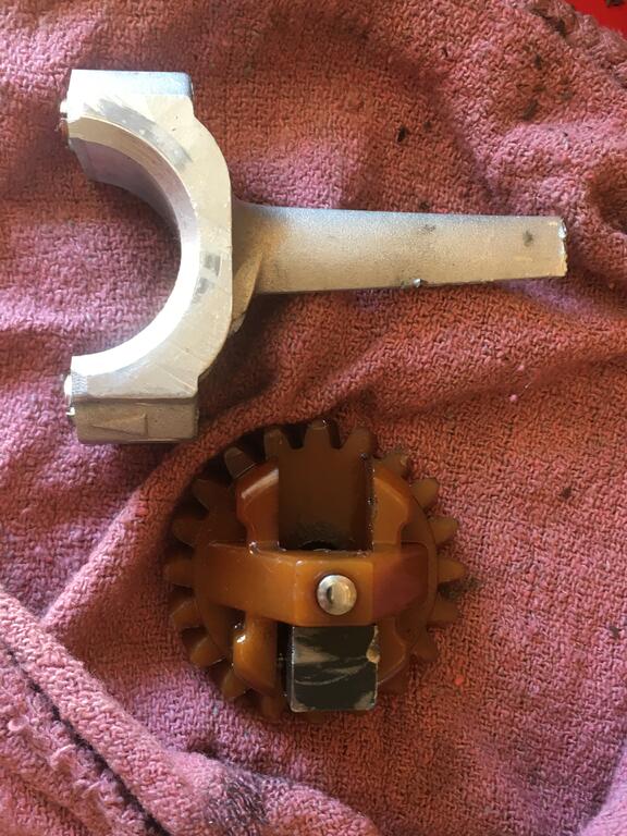

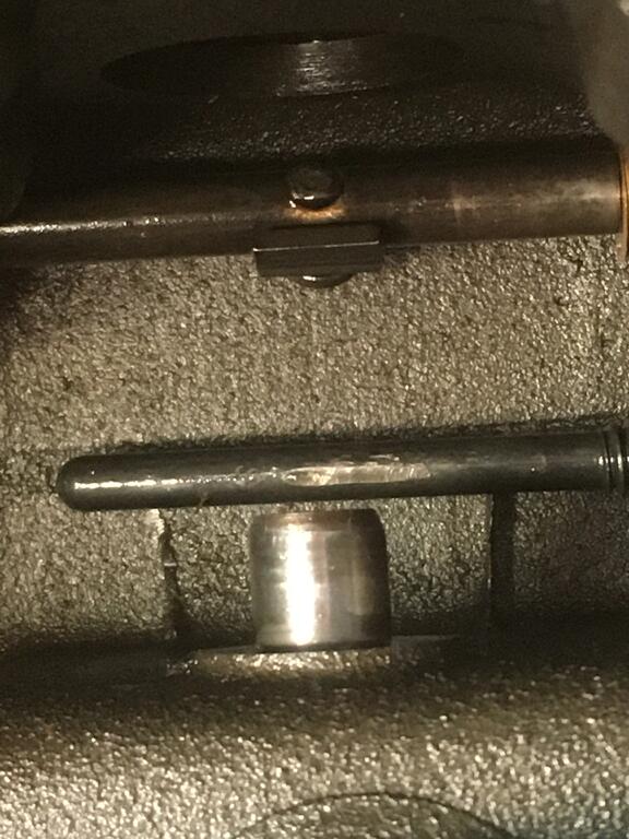

Farmerjohn 2 #1 Posted July 10, 2020 Hello I’m a 13 year old boy from Wisconsin trying to rebuild this k181s 8hp. I have been doing some research of how to get the governor working properly since one of the weights on the governor gear fell off into the engine destroying the cam shaft and nicking put the oil splasher. So my question is the governor cross shaft flapper thing supposed to be that short? I have been looking at it and I do not thinks it’s supposed to be that short, so if any of you know the answer please comment down below. 1 Share this post Link to post Share on other sites

520HC 208 #3 Posted July 11, 2020 No it appears to be broken off. Share this post Link to post Share on other sites
Farmerjohn 2 #4 Posted July 11, 2020 Thank you guys for helping me, I actually pulled that shaft out earlier and saw that it was broke. But thank you anyway. Share this post Link to post Share on other sites

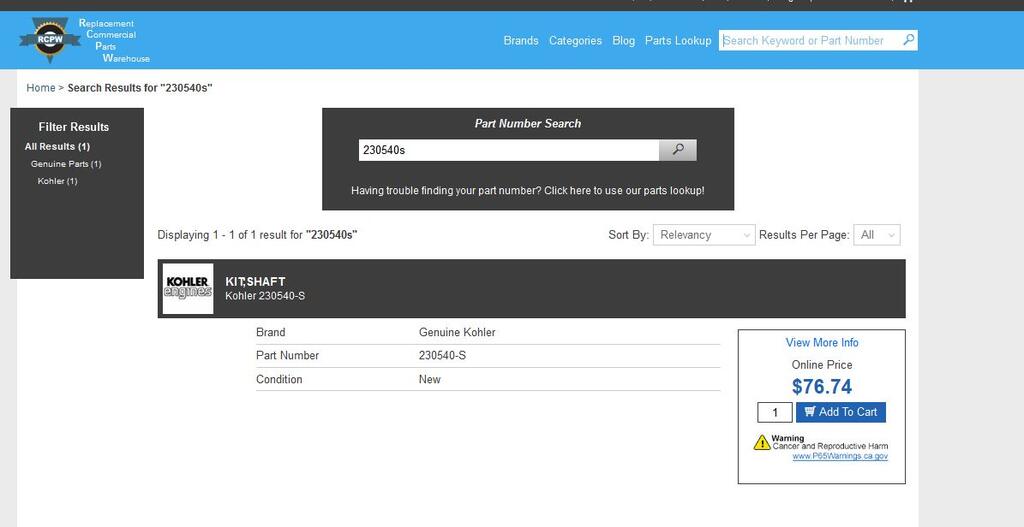

pfrederi 20,261 #6 Posted July 11, 2020 (edited) New will be pricey $76 Contact AtoZ tractors one of the vendors here to see if he has a good used one Website indicates he has it in stock https://a-ztractor.com/product/230540-s-u/ Edited July 11, 2020 by pfrederi 1 Share this post Link to post Share on other sites
ebinmaine 78,272 #7 Posted July 11, 2020 I'll second that. @Farmerjohn Call Lincoln at A to Z tractor in PA. Good guy. He'll fix you up. Share this post Link to post Share on other sites
