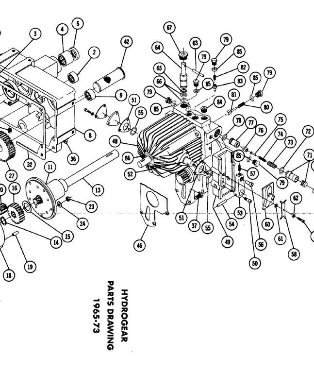

Goofball65 13 #12 Posted July 14, 2020 ok found the leak. and before i start again Sorry no pics ,lol it's coming from the seam between the pump housing and the rear end case up about halfway.not gasket, mabey inter seal ???? don't know never had one of these apart before, leak is almost imedit, dose not need to be hot. Share this post Link to post Share on other sites
pfrederi 20,834 #13 Posted July 15, 2020 Only a gasket between the hydro gear and the transaxle #46 1 Share this post Link to post Share on other sites
Goofball65 13 #14 Posted July 16, 2020 thanks! so if i break this open will i open a can of worms so to speak or easy fix? Share this post Link to post Share on other sites
pfrederi 20,834 #15 Posted July 16, 2020 Read the service manual here. Not a bad job but will take some time. Give you a chance to check the screen filter on the suction line.... 1 Share this post Link to post Share on other sites
