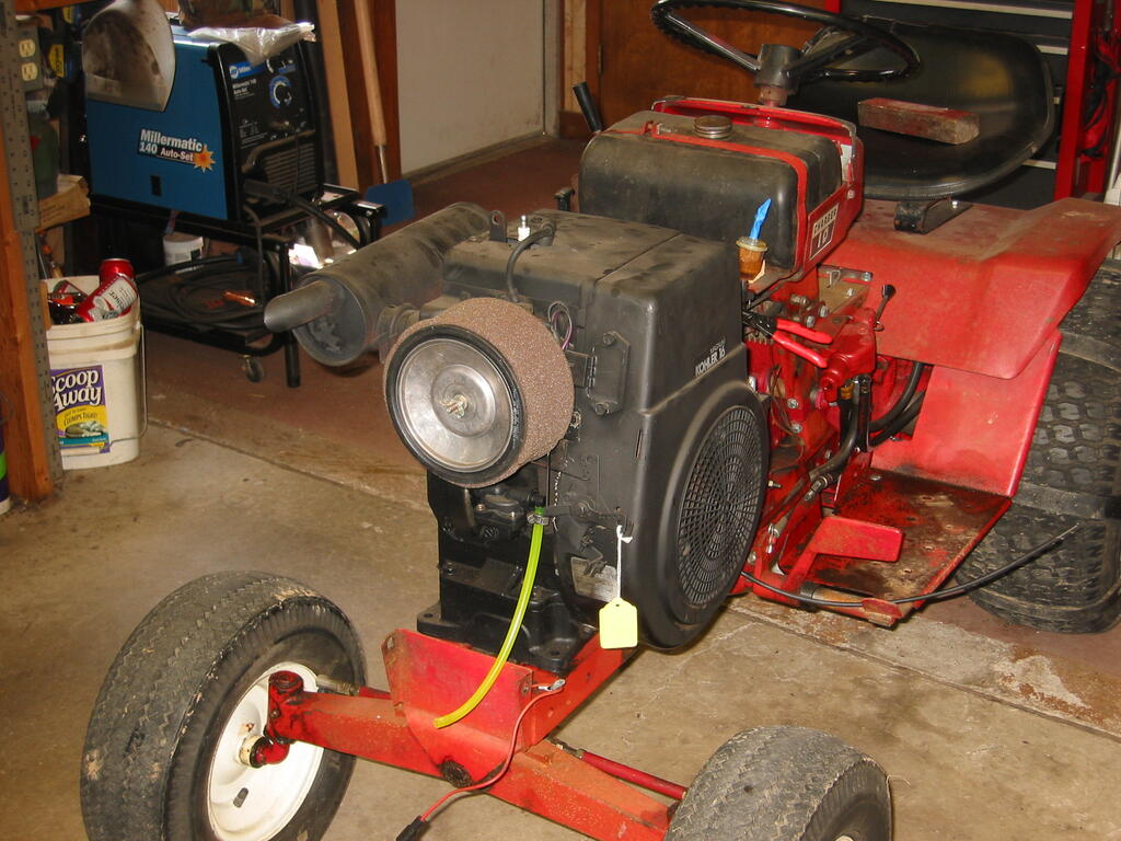

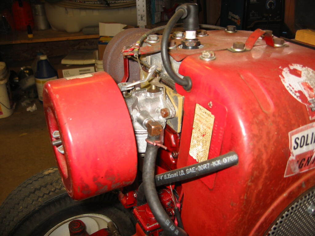

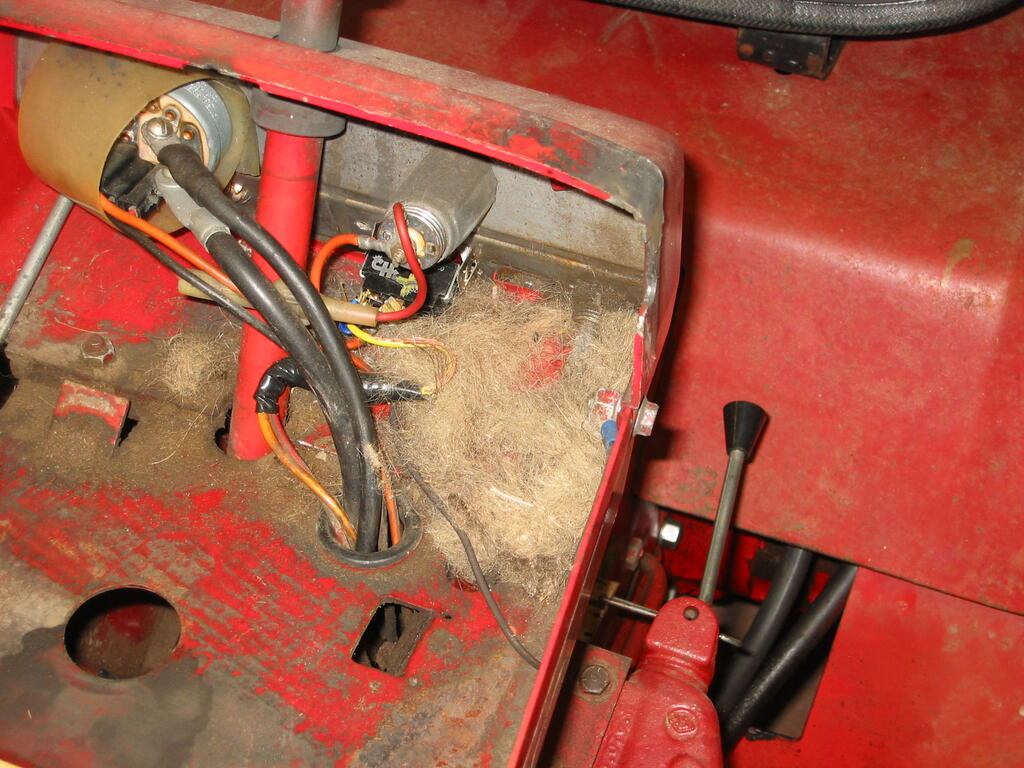

pfrederi 21,312 #1 Posted July 6, 2020 (edited) To hot to work outside today so time to work in the A/C part of the shop. Charger 10 becoming a Charger 16. (This will be my 3rd Charger/Electro 16) Going to need a new Choke cable and some wiring repairs thanks to the darn mice.... The 10 hp Techy worked OK when she was completely warmed up, not so cold.. Not a good thing for a winter plow tractor. Two different carbs and no difference. MY L107 Techy starts year round and is ready to run immediately... Edited July 6, 2020 by pfrederi 11 1 Share this post Link to post Share on other sites

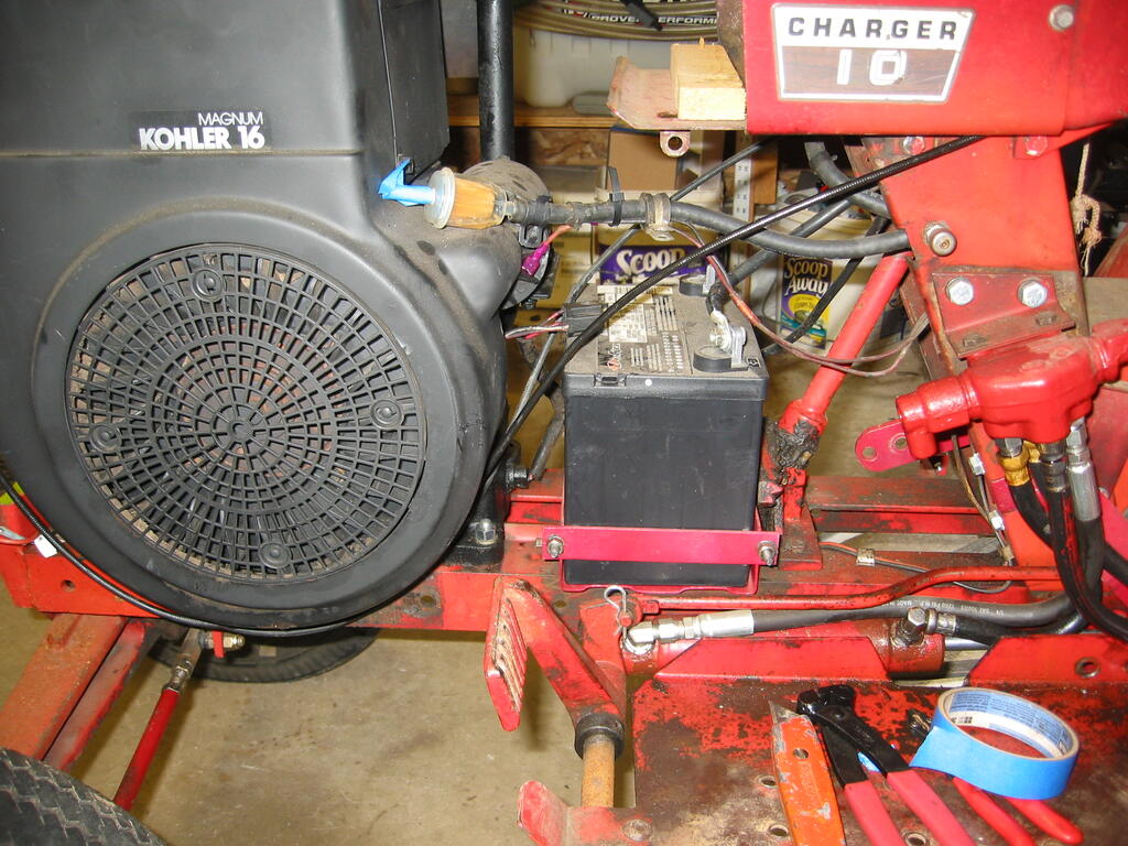

elcamino/wheelhorse 9,363 #2 Posted July 6, 2020 Do you have enough room for the battery in the original location Share this post Link to post Share on other sites
pfrederi 21,312 #3 Posted July 6, 2020 No problem with battery even clears oil level switch. Only clearance issue will be the strap on the muffler may touch the hood. may have to do some adjustment. 6 Share this post Link to post Share on other sites
