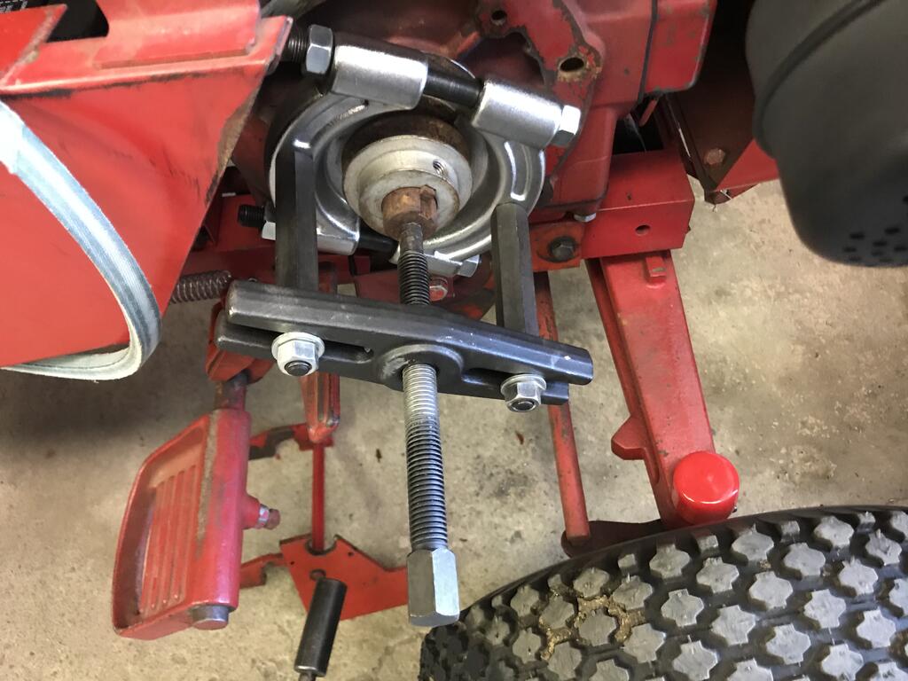

squonk 44,622 #12 Posted July 9, 2020 Here's the set up: 1 1 Share this post Link to post Share on other sites

squonk 44,622 #15 Posted July 9, 2020 (edited) 10 minutes ago, WHX24 said: Mike you need to clean your crank before you start pulling on it & squirt some lube down that screw hole. Came right off. Grey stuff on threads is lube. Couple raps with the Dee-Walt 3/8” impact and it was in my hands Edited July 9, 2020 by squonk 1 Share this post Link to post Share on other sites
