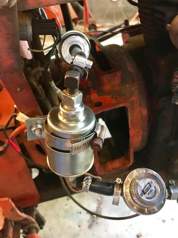

Okie B60 68 #1 Posted July 5, 2020 (edited) Hey guys, I'm having problems with fuel running out of the carburetor throat. I've tested the float, it floats. Set the float level. Added an electric pump and a Mr Gasket regulator. It still acts like it has too much pressure and is over riding the float. A factory replacement pump is 145 dollars around here. That's why I went with the electric one with a regulator. Any ideas are welcome! Happy 4th of July! Edited July 5, 2020 by Okie B60 Additional content needed Share this post Link to post Share on other sites
ebinmaine 80,477 #2 Posted July 5, 2020 Needle and seat been changed? 2 Share this post Link to post Share on other sites
squonk 48,008 #3 Posted July 5, 2020 Needle and seat. I tried one of those regulators once. -JUNK Use a Facet fuel pump 2-4psi. Napa # 610-1051 2 Share this post Link to post Share on other sites
Okie B60 68 #4 Posted July 5, 2020 Fresh needle and seat. I'll look into that Napa pump. Thanks fellers. 🙂 Share this post Link to post Share on other sites
