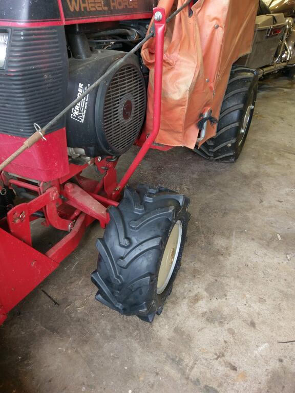

twiisted71 51 #1 Posted July 4, 2020 (edited) I"m sure its been asked but I can't find it specifically (yep I searched). I see that there were 2 different rim width used. 8" diameter x 4" and 6" wide if I read correctly. Are the hubs the same width? i.e. will either fit on the same spindle? I'd like to put on a set of 3 rib fronts and since my current tires (16x6.50-8s) are pretty dry rotted and splitting I'd like to try to find a set of the narrow ones and get them ready before my current may-pops POP! I have a C-81 by the way. Anyone have a spare set of the narrow rims they'd turn loose of? Please PM me if so with particulars. PS anyone running the R4 style rears? I love them on my Kubota L2501 as even with a front loader they don't mark up my yard unless its really soft. And they give great traction unless in blue gumbo (clay) mud. PPS. Are there other wheel sources to acquire the 3.75-4" wide wheels with the correct hub width? Edited July 5, 2020 by twiisted71 Share this post Link to post Share on other sites
