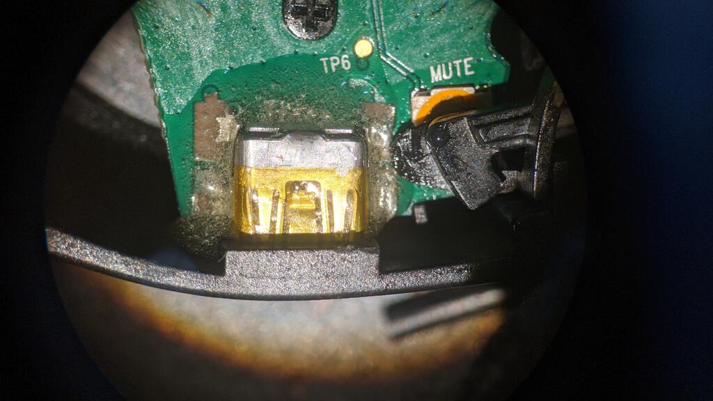

echris 1,426 #1 Posted July 2, 2020 I was going to post this under non tractor related, but thought it fits better under tools. How many of you guys are fans of real 2 part 5 minute epoxy? I use it ALL THE TIME thanks to my retired engineer buddy next door. Wanna keep a bushing on a shaft? Turn the shaft half a thou less, or the bushing ID half a thou less and lube it up with 5 minute. Let it sit overnight on the top of your furnace. It ain't coming off until you want it to. It's extremely versatile and a quality epoxy's shear strength can exceed 2,000 lb/sq in! But what about The Bigger The Blob, The Better The Job? Well there's few things in life where this saying is true. The following is one: My son has a wireless headset he uses for gaming. The tiny usb charging port broke off inside, naturally. Only 4 soldered ground tabs holding it in. After a thorough cleaning, tinning and soldering, I layered on the epoxy. Watched it for a few minutes while it set up to ensure it doesn't flow the wrong way, and set it on the furnace overnight. With those beautiful filets, I challenge my son to break it again. ha! Notice the MUTE marking on the board? There's a micro switch just below it, and the black lever just below that mutes the mic boom when it is retracted. I had to be real careful not to let the epoxy flow in that direction. That's not coming off again. Photo is taken using my cell phone through a Baush & Lomb Stereo Zoom microscope at about 20x. 6 Share this post Link to post Share on other sites
