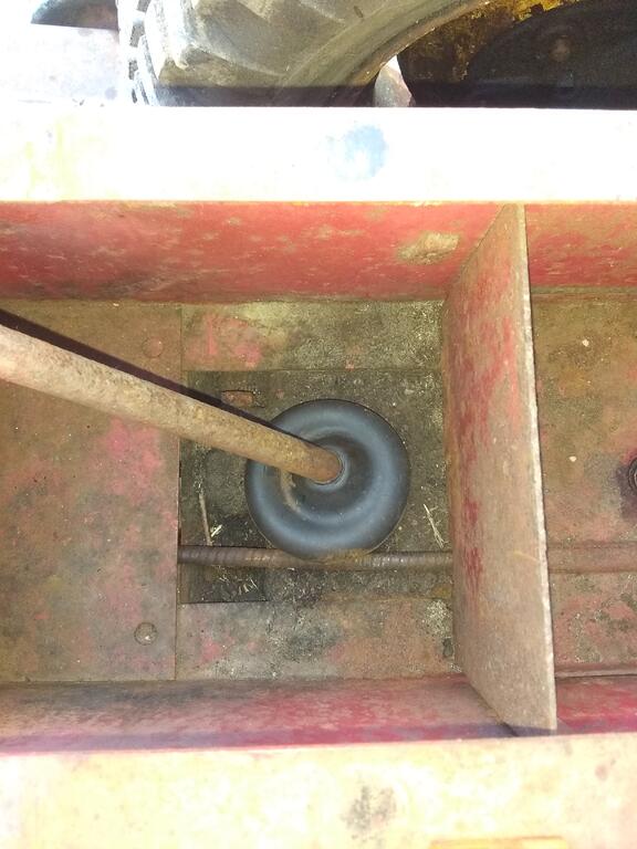

RedRover 27 #1 Posted July 2, 2020 Hello, I am in the process of adjusting brake band of my 312-8 and also placing new rubber boot around bottom of gear shift lever. There is a set srew of some type protruding from the front of the block where the boot fits....My question, that I hope someone will answer quickly, does the boot cover the set screw or just go down against the screw? 2 Share this post Link to post Share on other sites
gwest_ca-(File Mod) 12,521 #2 Posted July 2, 2020 Covers the screw. Garry 3 Share this post Link to post Share on other sites
peter lena 10,103 #4 Posted July 2, 2020 agree with above, use a razor blade to take it off and silicone grease to slide it on ,make it a smooth installation , available on line at many sites, pete Share this post Link to post Share on other sites
CCW 1,521 #5 Posted July 2, 2020 FYI - the boot on my 312-8 was always sliding up exposing the transmission to water. Boot is in fine shape so I used a small hose clamp to secure the top of the boot the the shift lever. Problem solved and no more water in the transmission. 1 Share this post Link to post Share on other sites
oldlineman 1,817 #6 Posted July 2, 2020 I punched a small hole in the boot and put the dog point screw through it, holds the boot in place very well. Share this post Link to post Share on other sites

RedRover 27 #8 Posted July 3, 2020 3 hours ago, oldlineman said: I punched a small hole in the boot and put the dog point screw through it, holds the boot in place very well. Success in getting the boot over the screw...Now, please comment as to the purpose of the screw??? Share this post Link to post Share on other sites
rjg854 13,408 #9 Posted July 3, 2020 the screw holds the gear shift lever in the transmission, loosen the nut, back out the screw a bit and that will release the gear shift lever Share this post Link to post Share on other sites
