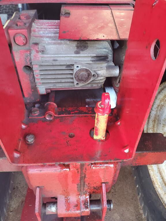

12Horse Paladin 1,038 #1 Posted July 1, 2020 ...for my hydro transmission in my c160. It took me an hr to fill with the seatpan off and space between the funnel and tube. I couldnt get a decent pic of it, but there is a lip on the inside bout 2 maybe 3 inches down that did not help matters either. Thoughts? Share this post Link to post Share on other sites
ZXT 2,402 #2 Posted July 1, 2020 Factory as can be. What was the issue with it? Share this post Link to post Share on other sites
daveoman1966 3,884 #3 Posted July 1, 2020 (edited) Trick is: With the funnel in the fill tube, insert a long thin air vent hose right into the funnel....allows air to excape as the oil fills the crankcase. Just a 1/8" dia vent tube is fine....doesn't take much to allow the air to purge as it fills. Edited July 1, 2020 by daveoman1966 4 Share this post Link to post Share on other sites
12Horse Paladin 1,038 #4 Posted July 1, 2020 2 minutes ago, daveoman1966 said: Trick is: With the funnel in the fill tube, insert a long thin air vent hose right into the funnel....allows air to excape as the oil fills the crankcase. Just a 1/8" dia vent tube is fine....doesn't take much to allow the air to purge as it fills. I will have to get one, then. Last time, in my bronco 14, i used a ziptie between the tube and funnel, and that worked, more or less. Can u get those vent tubes at an auto store? Share this post Link to post Share on other sites
daveoman1966 3,884 #5 Posted July 1, 2020 Auto store...just buy a 2 foot long piece of small vinyl air hose....1/8 - 3/16 ID is fine. Imagine a long plastic SODA STRAW...that's wht you want. In fact, that soda straw might just work....if it is long enough. 4 Share this post Link to post Share on other sites
JoeM 10,078 #6 Posted July 1, 2020 Or remove one of the 3/8 mounting bolts to let the air out of the case when filling. 2 3 Share this post Link to post Share on other sites
