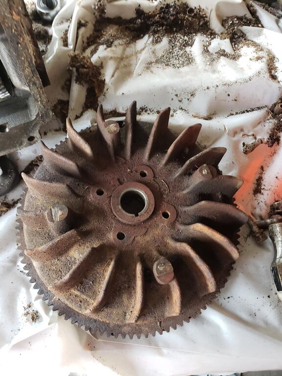

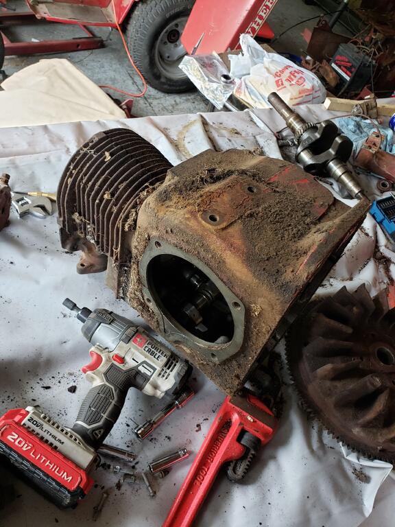

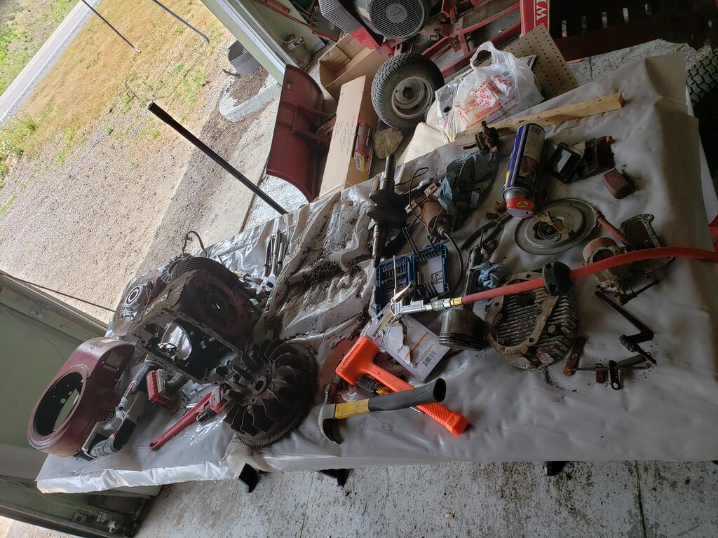

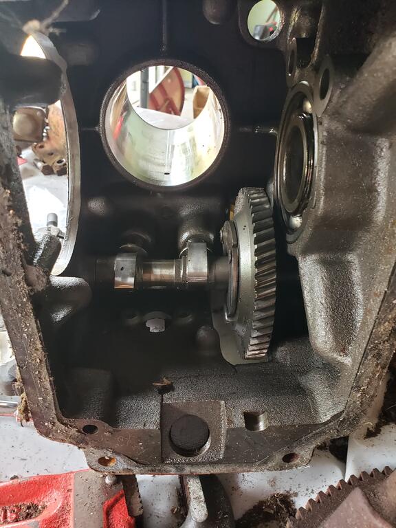

Jaydubz83 22 #1 Posted June 29, 2020 Hey y'all Finally got some time to get w a buddy to do a tear down on the K241 from the 75 C100 8sp. Granted, I've never done anything like this before but even still, I was really surprised by the condition of the internals given the fact the tractor has sat for years without running. True testament to the quality of Kohler. I was expecting to find quite a mess inside as I did on the outside of the block. It's going to a machine shop to have the cylinder honed, a couple of bolts extracted and the exhaust inlet removed (no amount of heat, cutting or blunt force combined got it to break loose) Here's where imma need some insight from my local-ish (Maine) peeps. I've never taken anything to get machined so I'm not sure what I'm looking at cost wise. Also, there are bolts that will need to be extracted from the flywheel as they stripped out trying to get the screen cover off the housing to finish cleaning out the engine. I've seen a couple (flywheels) for sale for between 40 and 60 bucks on ebay but I wonder if it would be best (cost-wise) to buy one of them used or have the machine shop extract the screw from the flywheel where it's all gonna pretty much be there anyway. So far I have a whopping 50 greenbacks into the project plus the cost of a truck rental and fuel to travel the 140 ish miles roundtrip so it's not like I'm going bankrupt on this but naturally I'm curious to see what machine shops get for honing and bolt extractions. Will be ordering new gaskets, ignition points, carb and coil and may throw a coat of red paint on it (or just primer). Anything else I'm missing? Thoughts, complaints, grievances, questions or concerns? Have the best Monday you possibly can. 2 Share this post Link to post Share on other sites

953 nut 59,999 #8 Posted June 29, 2020 5 hours ago, Jaydubz83 said: Also, there are bolts that will need to be extracted from the flywheel as they stripped out trying to get the screen cover off the housing to finish cleaning out the engine. I've seen a couple (flywheels) for sale for between 40 and 60 bucks on ebay but I wonder if it would be best (cost-wise) to buy one of them used or have the machine shop extract the screw from the flywheel where it's all gonna pretty much be there anyway. Only your machine shop can tell you what they will charge. If you ask first they should be able to give you an estimate. If you decide to buy a used flywheel be sure it is correct for your engine, the Spec. # of your engine can be used to find the flywheel part number. Not all flywheels are the same. Take the block and crankshaft to the machine shop so they can be measured, if a new piston and rod are needed the machine shop will let you know so you (or they) can order them. Share this post Link to post Share on other sites
Jaydubz83 22 #9 Posted June 29, 2020 24 minutes ago, ebinmaine said: Good point there Jim. If the measurements are in spec, don't bore. I'm not sure as though it needs to be bored. My SME (subject matter expert) who helped w the tear down stated it needed to go in for honing and the have the bolts extracted as I don't have 200a service for a decent welder nor do I have the hands steady enough to weld if I did. I tried drilling and tapping and extracting ( if I'm using the correct terminology here) but no dice and didn't want to make anything worse (small engines are virgin territory for me.... pardon the expression) I have a micrometer (HF special) but watching videos on bore measurements it seems I don't have all the tools needed to get accurate results Share this post Link to post Share on other sites

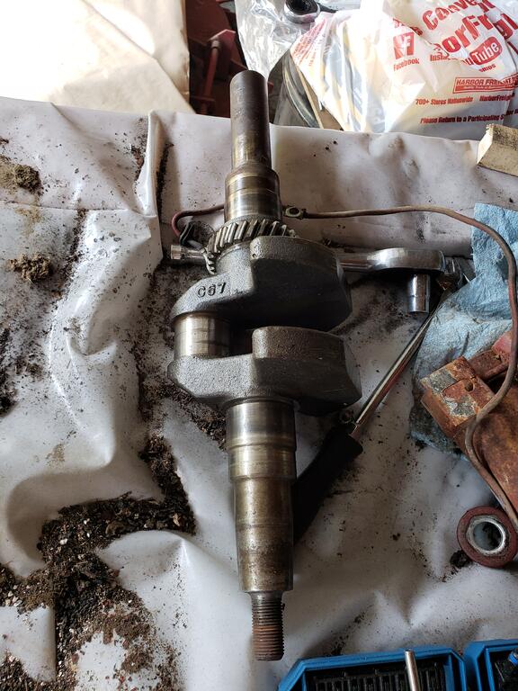

953 nut 59,999 #14 Posted June 30, 2020 12 hours ago, Jaydubz83 said: I don't have all the tools needed to get accurate results I did this thread for that very reason. If the end gap readings are not consistent from top to bottom then you should have it measured at the machine shop. 1 Share this post Link to post Share on other sites
richmondred01 2,307 #15 Posted June 30, 2020 If you don’t have, and know how to use, these tools get a machinist to measure the cylinder, crank and valve guides. Share this post Link to post Share on other sites
