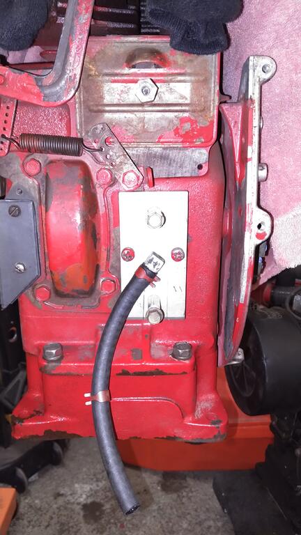

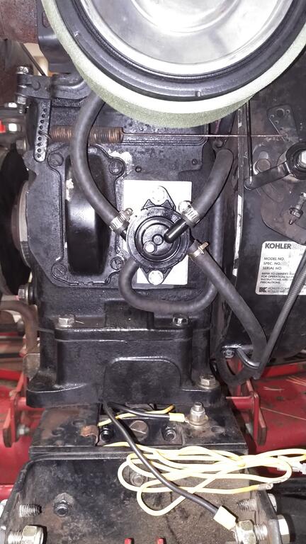

Bill D 3,124 #52 Posted September 8, 2021 (edited) 9 hours ago, Mike'sHorseBarn said: I'm having real trouble with kohler pulse pumps right now and would pay you to make me a couple of those brackets to do a conversion! I'm a little tight on time right now, but the mounting plate is easy to make if you have a drill press. The pump in the second picture is a Kawasaki pump. Edited September 8, 2021 by Bill D 1 Share this post Link to post Share on other sites

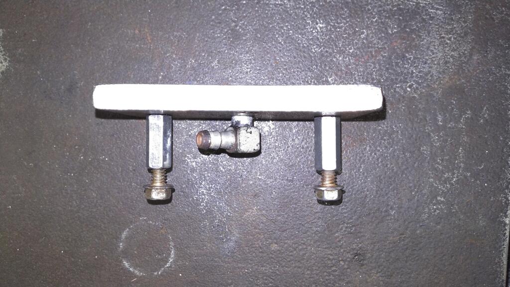

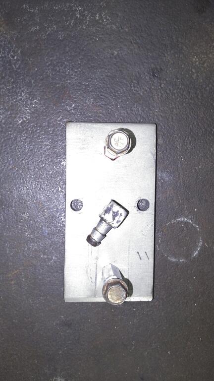

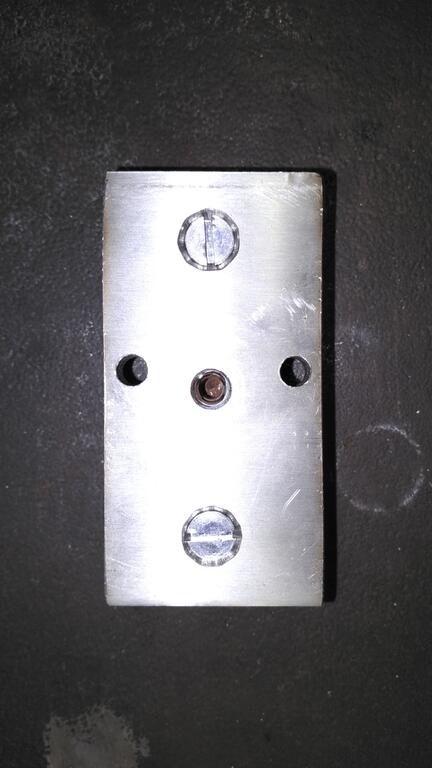

Bill D 3,124 #58 Posted September 17, 2021 On 9/8/2021 at 9:45 AM, Mike'sHorseBarn said: That's fine, I just thought I'd ask. I'm definitely gonna give this a try though! Here are some pictures that may be useful for you if you want to make your own fuel pump mounting plate. 1 2 Share this post Link to post Share on other sites
sparkie333 265 #59 Posted September 17, 2021 8 hours ago, Bill D said: Here are some pictures that may be useful for you if you want to make your own fuel pump mounting plate. What size hole did you drill---and what size tap.---Please Share this post Link to post Share on other sites
Bill D 3,124 #60 Posted September 18, 2021 4 hours ago, sparkie333 said: What size hole did you drill---and what size tap.---Please The tap is a 1/8" NPT tap. I think I used a 11/32" drill bit. I don't remember what size it was exactly. There should be a chart online that will show you the proper size drill bit. Drill the holes to mount the plate the engine with a 9/32" bit. Share this post Link to post Share on other sites
sparkie333 265 #61 Posted September 18, 2021 10 hours ago, Bill D said: The tap is a 1/8" NPT tap. I think I used a 11/32" drill bit. I don't remember what size it was exactly. There should be a chart online that will show you the proper size drill bit. Drill the holes to mount the plate the engine with a 9/32" bit. Ok thanks------------ Share this post Link to post Share on other sites
oldredrider 2,553 #62 Posted September 18, 2021 A 1/8" pipe tap uses a 21/64" drill. FYI. 1 Share this post Link to post Share on other sites
Bill D 3,124 #63 Posted September 18, 2021 1 hour ago, oldredrider said: A 1/8" pipe tap uses a 21/64" drill. FYI. I knew someone here would know. 1 Share this post Link to post Share on other sites
sparkie333 265 #64 Posted September 19, 2021 16 hours ago, Bill D said: I knew someone here would know. Great--tks. Share this post Link to post Share on other sites
Mike'sHorseBarn 3,678 #65 Posted September 19, 2021 This should work on my 857 even though there is less room around the pump than on a bigger kohler. I'm going to have to figure out a different bracket for my speedex though. Is that aluminum that you used for the plate? Share this post Link to post Share on other sites
Bill D 3,124 #66 Posted September 19, 2021 33 minutes ago, Mike'sHorseBarn said: This should work on my 857 even though there is less room around the pump than on a bigger kohler. I'm going to have to figure out a different bracket for my speedex though. Is that aluminum that you used for the plate? I used stainless steel. 1 Share this post Link to post Share on other sites
